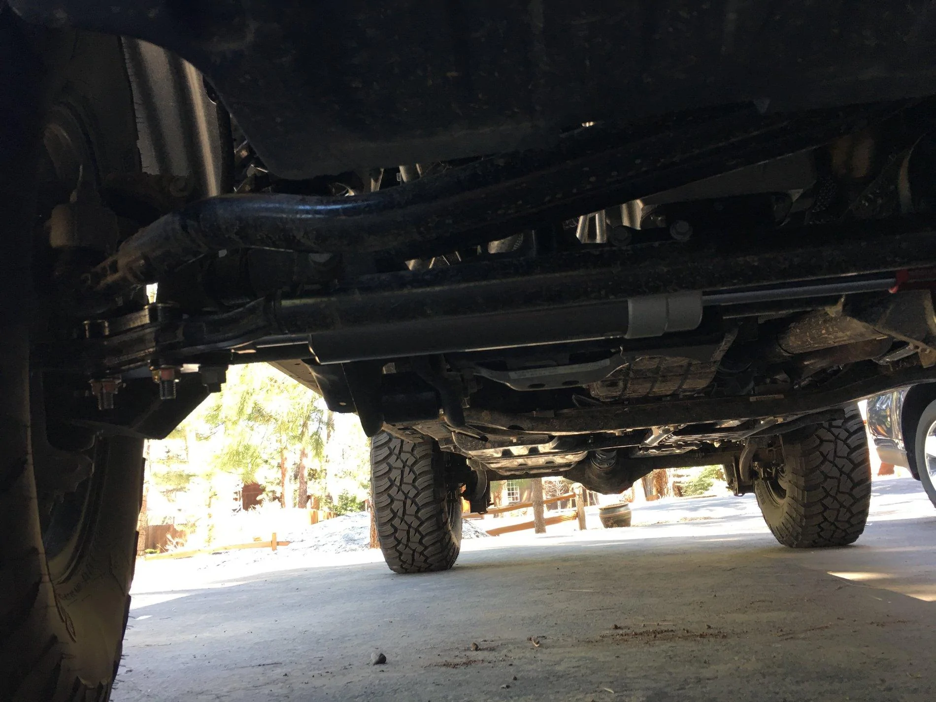

Realigned the tailgate and replaced the stock stabilizer with RC N3.

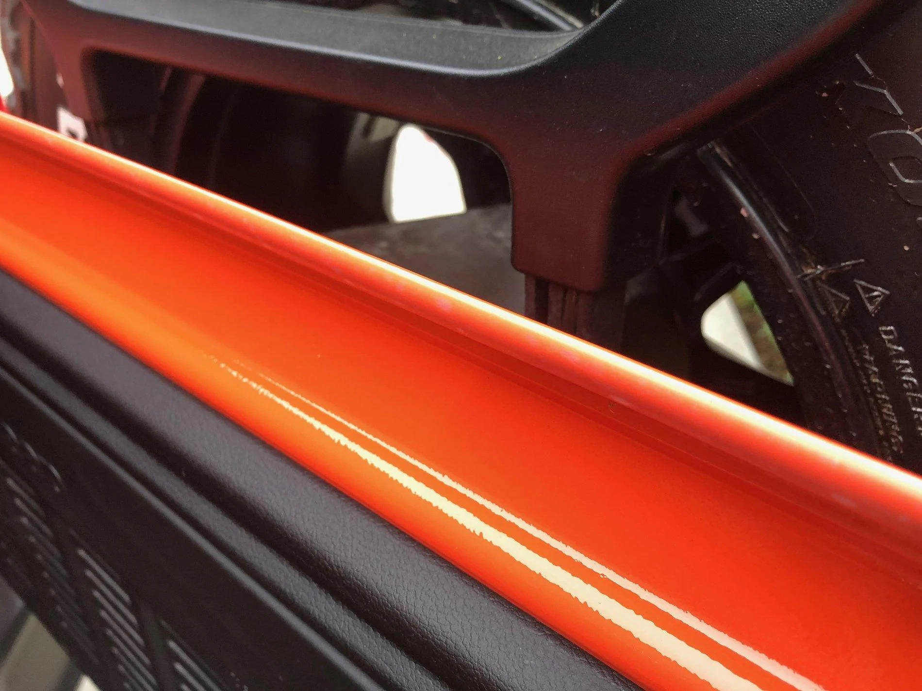

Applied 3M anti-squeak tape to rear tailgate. Virtually invisible. No more constant annoying squeaking coming from the rear hatch (that drove me nuts). Not that one expects a Jeep to be "quiet"... the constant and never-ending squeaking could only be drowned out by the radio (or driving faster than 65). Quite possibly the most sanity saving upgrade I've done.
Picture below with tape applied. Nearly invisible though you can see a few of the air bubbles that should fade with time. Since you won't see it when the tailgate is closed I don't really care.
$20 on Amazon https://www.amazon.com/0-125-5-5430...+5+yard&qid=1556287711&s=gateway&sr=8-1-fkmr0
