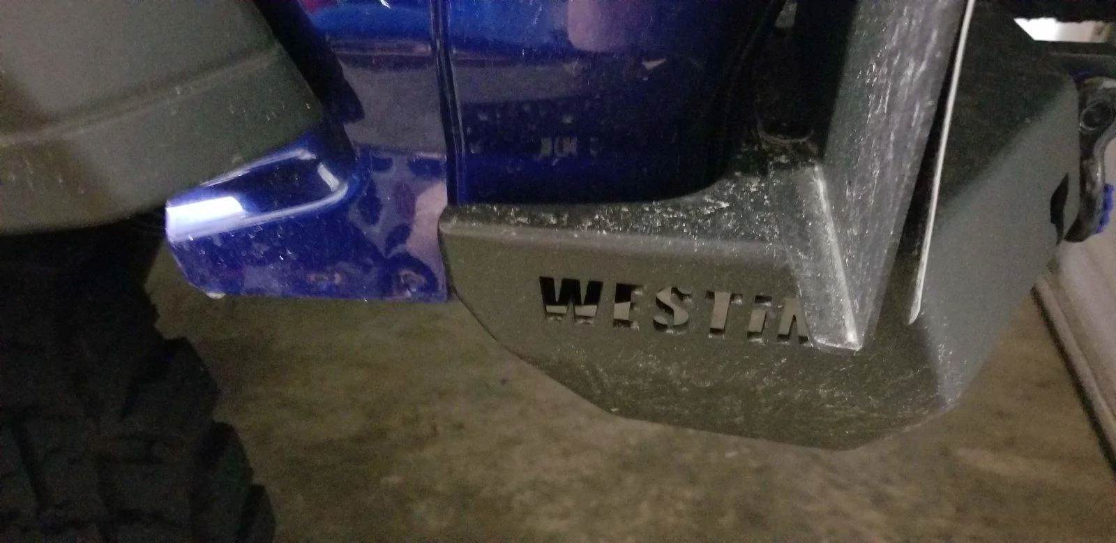

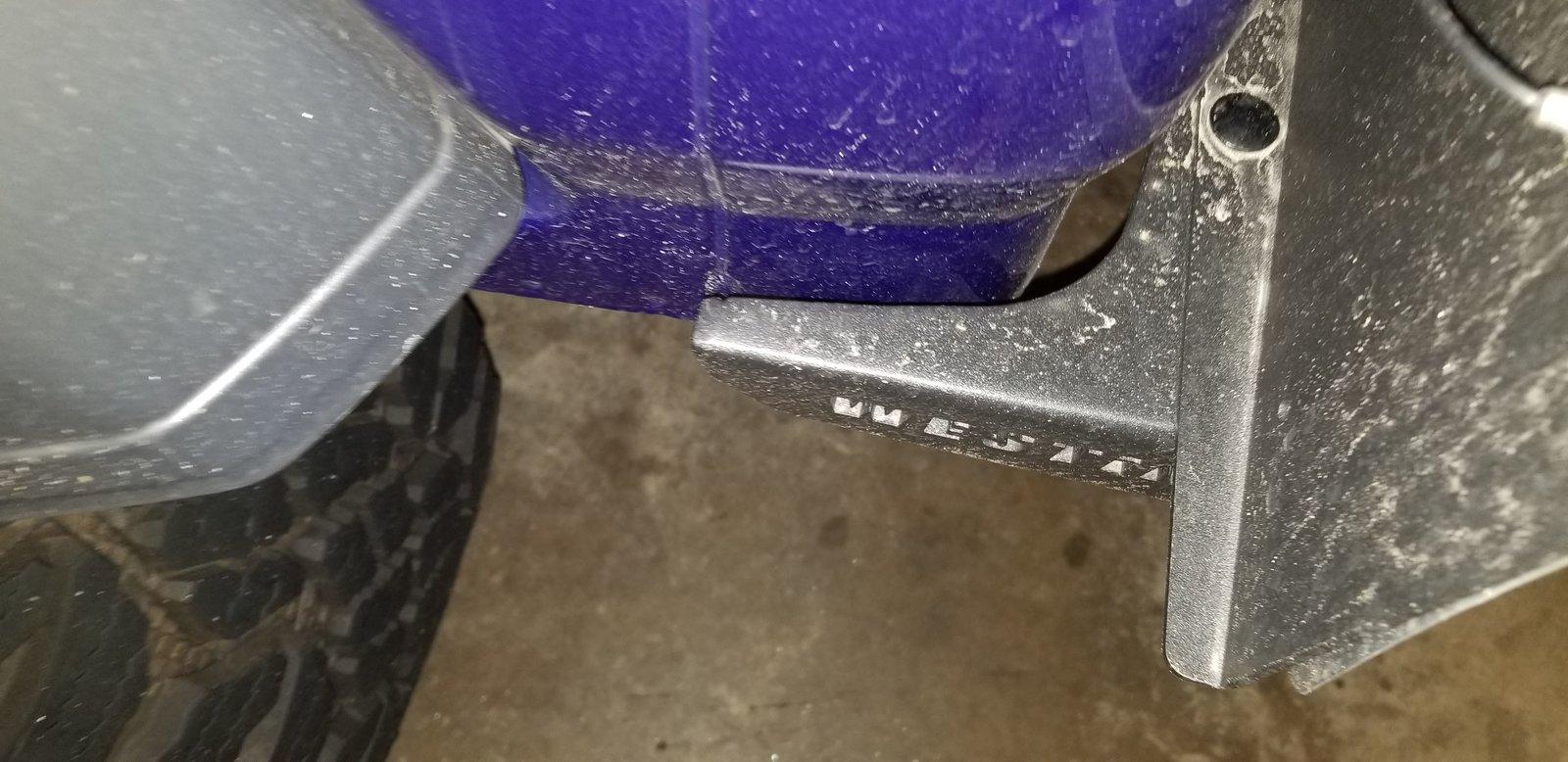

Could you post a side pic of the rear bumper? I'd like to see how much it protects the rear quarter panel.

Sorry for the delayed response... we were on vacation! Here some pics. Let me know if you want different angles...
