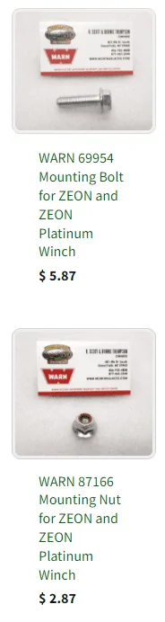

I would go with the 6 foot cable.
Other than that, you just need the 4 bolts and 4 nuts to bolt it down.
The nuts are a special shape to slide into the feet. I would just order the Warn part number since they'll share the shear load properties Warn designed into the feet.
