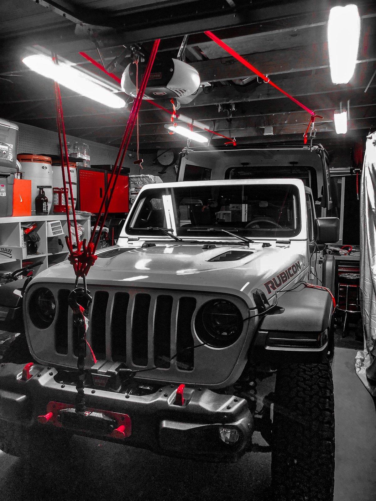

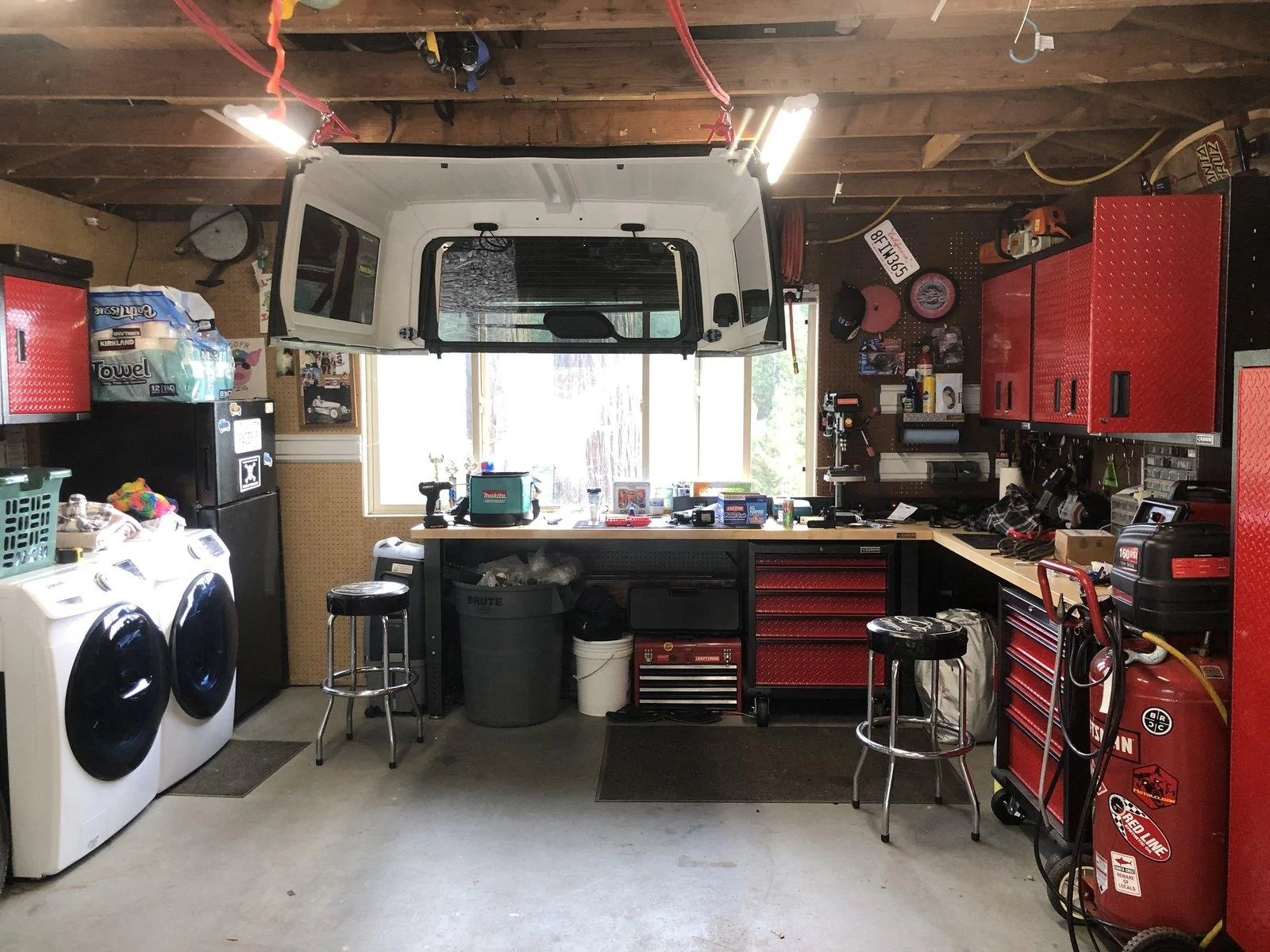

So I decided to figure out a way to use my warn winch to take off my own hard top rather than buying a garage hoist. Off to the hardware store for some eye hooks, carabiners and a few other odds and ends and I've just about got it ironed out. Tall folks would definitely need to duck around it but we are a family of short people so it works just fine at about 5'8"" of clearance.

I think we need a video of this in operation :)
Grumpy Wrangler
Grumpy Wrangler
Sep 4, 2018
66
125
2018 Jeep Wrangler Rubicon 2 door JL
  • Thread starter
  • Thread Starter
  • #10
hahah I tried and lost patience. Seemed as though I couldn’t get the format just right or I had to post to YouTube or Facebook to do that, neither of which I felt like doing.

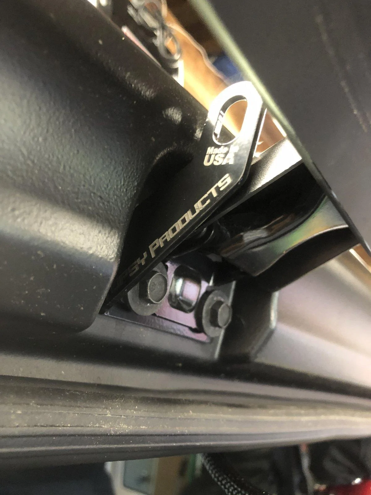

I can’t really tell from your pictures what points on the hard top you are attached to with the carabiners. Also how are tieing the ropes back after you get the top off the Jeep?
Grumpy Wrangler
Grumpy Wrangler
Sep 4, 2018
66
125
  • Thread starter
  • Thread Starter
  • #15
This idea is brilliant!!!!!
I used Topsy products brackets attached to the rear window mounts for the rear connecting points. For the front I ran an eye hook through the bolt holes that hold the front to the roll cage and ran a nut and washer on the underside of that. It was important to me that everything was super secure for long term storage so I didn’t have to worry about it dropping if something slipped or got bumped. Once everything is hoisted to height a second set of carabiners locks it down and allows the winch to be released. When the whole thing isn’t in use it’s easy enough to tuck the spare line in rafters or caribener it off to whatever points.
