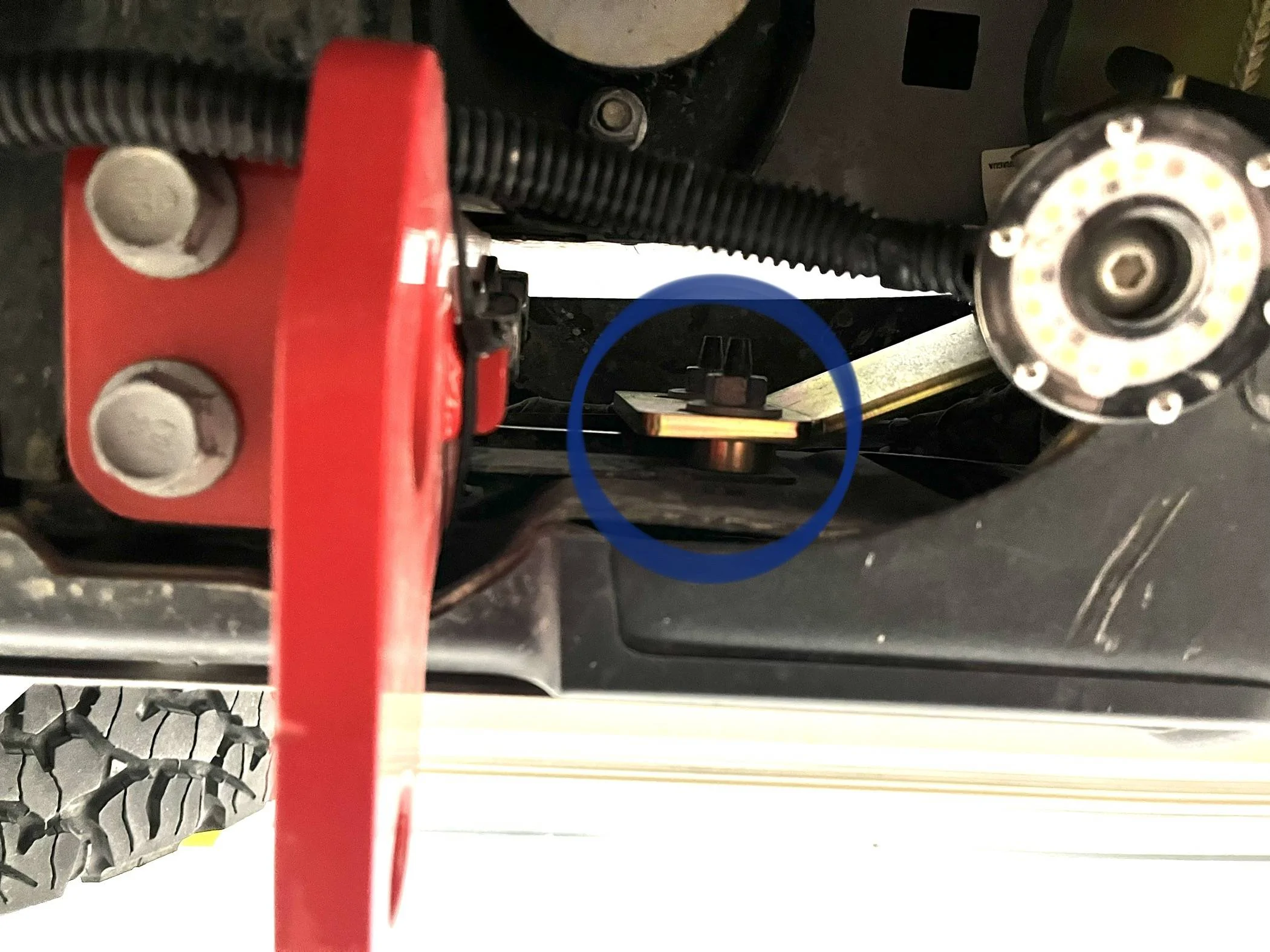

The cross bolts for the recovery points were binding up for me when I installed.
It’s possible that was because I’d already come down on my bumper a few times but it didn’t appear visibly bent.
When I loosened these other nuts I was finally able to get the RP cross bolts through. The top nut is a real PITA to get to though so I wouldn’t recommend loosening them unless you need to.
Jeep Wrangler JL Warn Recovery Gear D Ring Kit? 9C195294-8DC7-4A6C-905B-2AD0EE91727A
Pic from under drivers side.
Edit: The gold brace under the nuts aren't original. The factory ones will be black.
