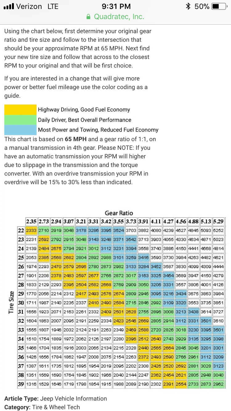

I’m planning on running 37’s with 4.88’s... should get the power / torque ratio just a little better than the 33’s with 4.10’s... I haven’t done the math yet but I ran 35’s with 4.88’s on my TJ. That kept me emptying my pockets at the pump. Granted this will be a 6-speed manual vs my 5-speed so I’ll do some math and get back to you on the modified ratios.

It’s been a good while since my TJ but I could swear 37s were at the sweet spot on 5.13s

5.13s would work also... I’m not into mileage. Going to have to wait till the first set of tires need replaced before I go up with a lift, gears and tire though...
