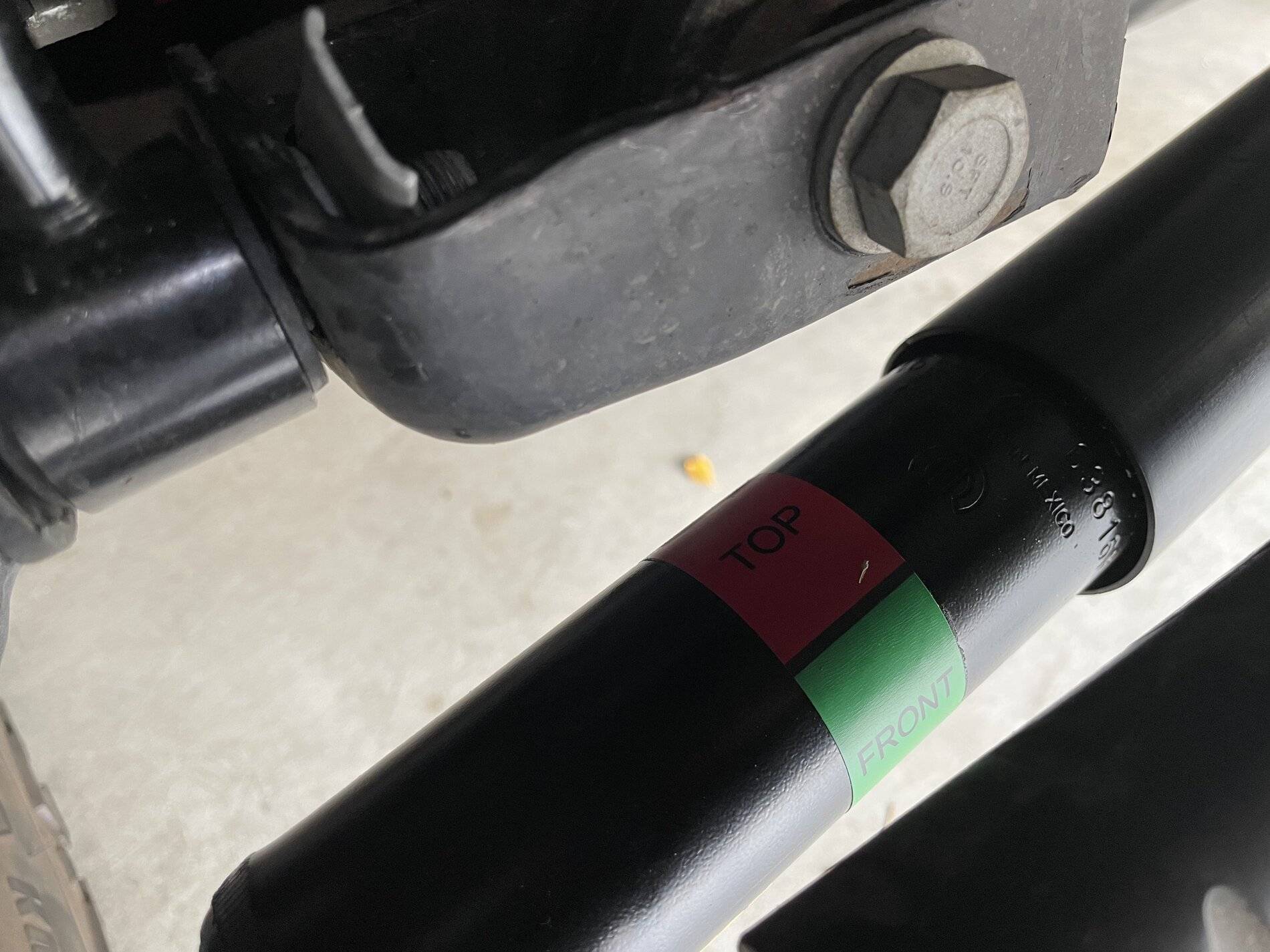

Posted this in another thread…
Just had my v41 steering stabilizer recall done. Looks like mopar finally color coded them to make them idiot proof for the techs. Lol.
