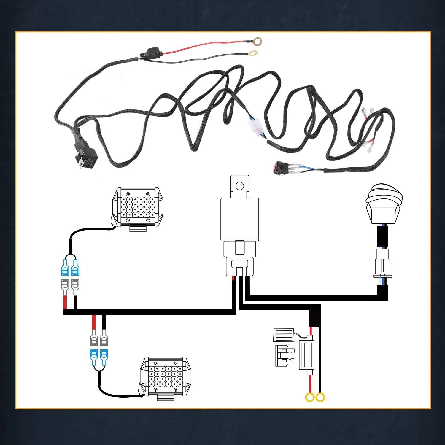

I have a 2021 JLU Diesel with factory installed aux switches. Prior to this install, all 4 aux switches had never been used. I was installing the KC Cyclone v2 LED 6 light system.
Existing electrical is all stock with the exception of a winch wired straight to the battery (which has been working fine for 2 years)
Install:
The lights themselves were mounted using magnet mounts and the wire harnesses were run through the frame and into the engine bay. The engine bay wiring was as follows: all 6 harness power was to the KC supplied fuse block. All 6 wire harness ground were directly to the battery. The fuse block power was directly to the aux switch 4 wire. I changed the aux switch setup so that it was set to battery.
