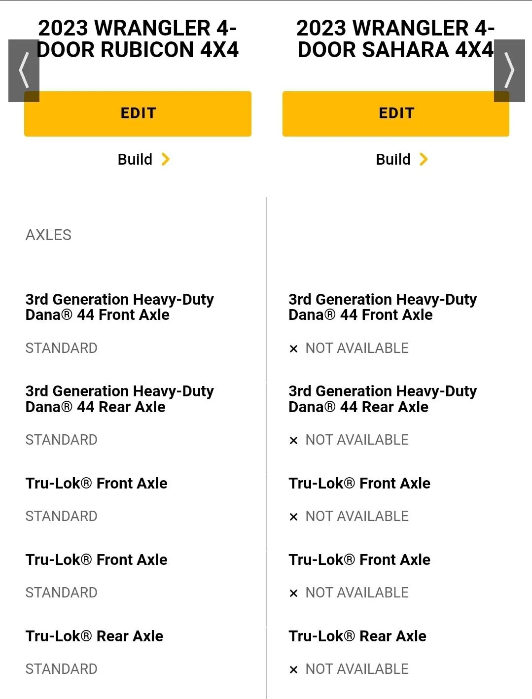

OEM lockers have always been electronic.
The factory Tru-Lok lockers on the TJ Rubicon were air actuated. Jeep switched to electronic lockers starting with the JK.
I don't think that I've ever heard of Tru-Lok axles on a JL, but so far 11 2023 Wranglers have been built with them. Is that an extremely special order or something?
The Tru-Lok name has been used since the 2003 TJ Rubicon and is still listed on the Jeep Rubicon JL as seen below.
Jeep Wrangler JL Tru-Lok Axles? Screenshot_20230222_052723_Chrom

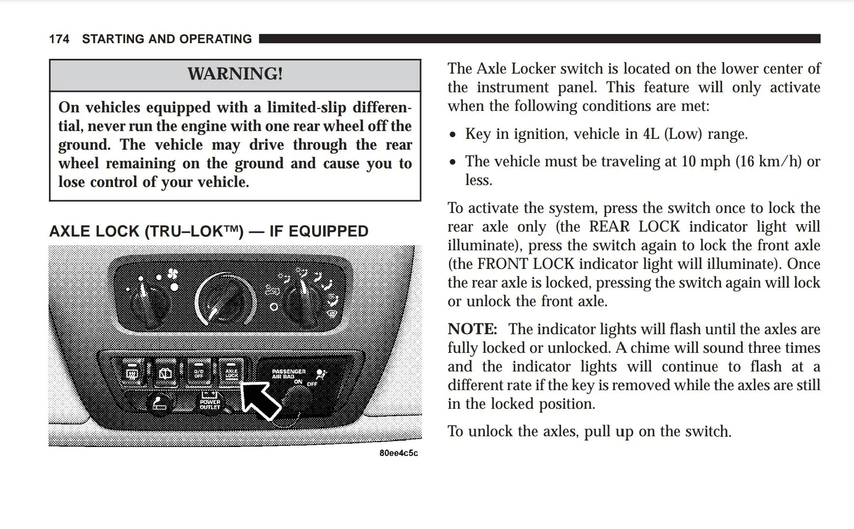

2004 TJ Rubicon owners manual:
Jeep Wrangler JL Tru-Lok Axles? Screenshot_20230222_051352_Driv
I'm guessing Jeep switched from air to electronic to save a few pennies. My TJR locks/unlocks much better while turning than my JLR. Air lockers are preferred by builders adding tons.
