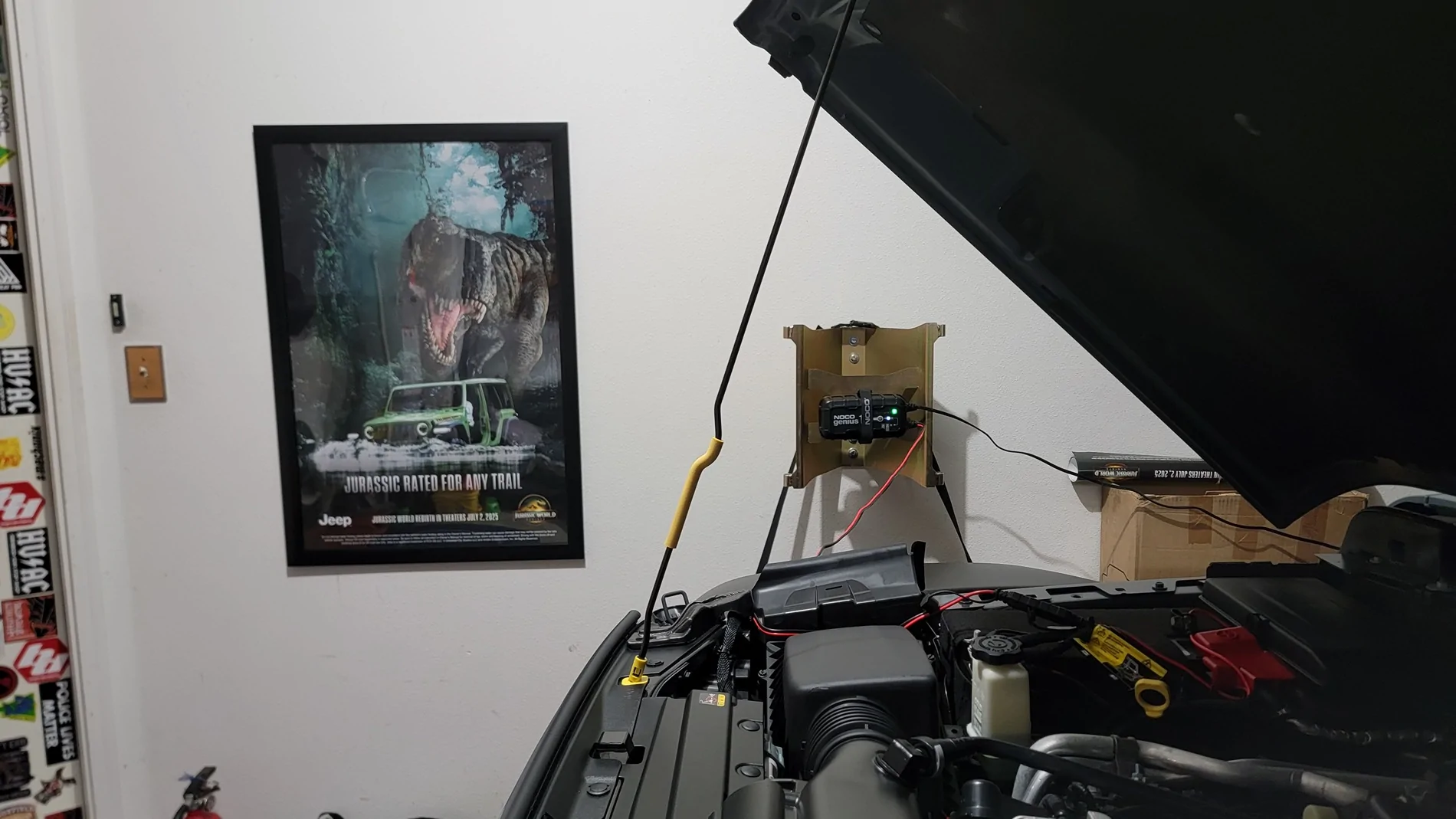

Hello Group, I just stumbled upon this post. I just hooked up a Noco 10 to my 2025 V6 Rubicon that will be in the garage all winter. I don't want to beat a dead horse, but is this the proper way to charge the main and auxiliary battery ?
Jeep Wrangler JL Trickle Charger? 20251216_202344

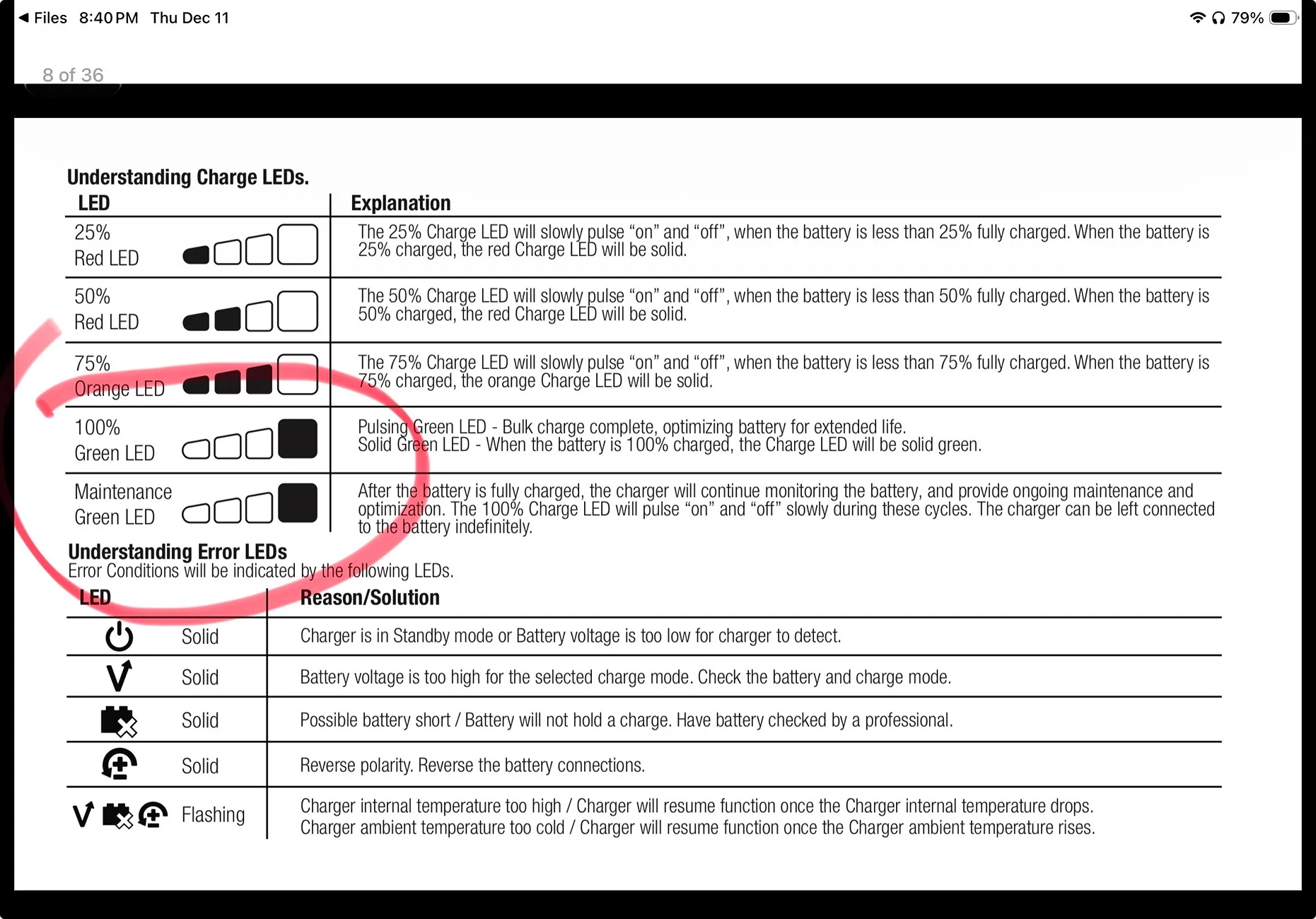

Any sane person would have offloaded this Jeep years ago so I really don't know what's wrong with me. 🤷‍♀️
In good news I let the Noco charge overnight and it's blinking green and in maintenance mode. Turns out I just wasn't patient enough (which may be part of the answer to the above question of what's wrong with me). 😂
Jeep Wrangler JL Trickle Charger? IMG_0861

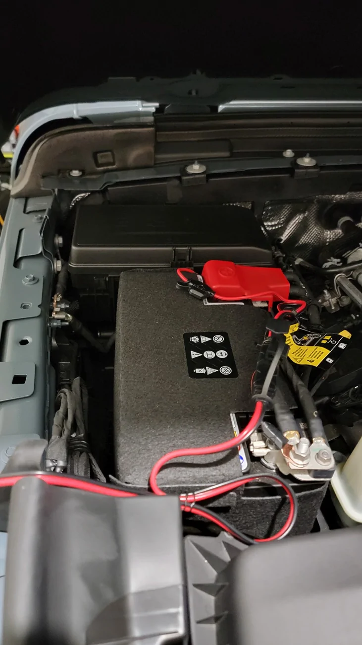

Not sure on the NOCO 5 but on my 10 flashing green is in condition mode and is not in maint mode until solid green non flashing.
Jeep Wrangler JL Trickle Charger? IMG_2467
Yes you are correct and I misspoke (mis-typed?). I just checked and it is now solid green.
We have a big rain storm coming this week and the Jeep is covered but I'll check it again once the rain has stopped and make sure everything is still ok under the hood.

I charge my duel 750-25’s separately and it normally goes straight to 100 but takes 12+ hrs to condition ( blinking green) then solid green and in standby. I usually charge/condition them every 2-3 months just to keep them healthy, I do a lot of short trips since I’m retired.
