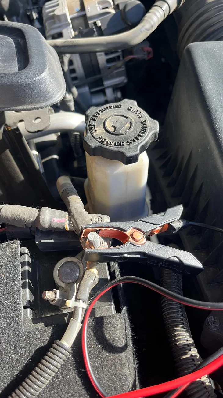

Much appreciated. Where to actually hook on the negative clamp has been up for debate for the past 4 hours so happy to put that to rest. 🤣
Just for educational purposes why does putting it on the post keep the IBS calibrated as opposed to where I had it before? The Noco manual wants me to ground it to the frame but I think that's just so if it sparks the potential for fumes to ignite is less?

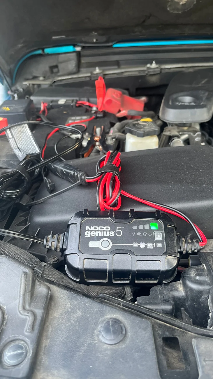

Now that it's hooked up how long should I expect for it to be fully charge and just be maintaining? Jeep was last driven on 12/9 but I did turn it over a few days ago for about 20 minutes but did not drive it.

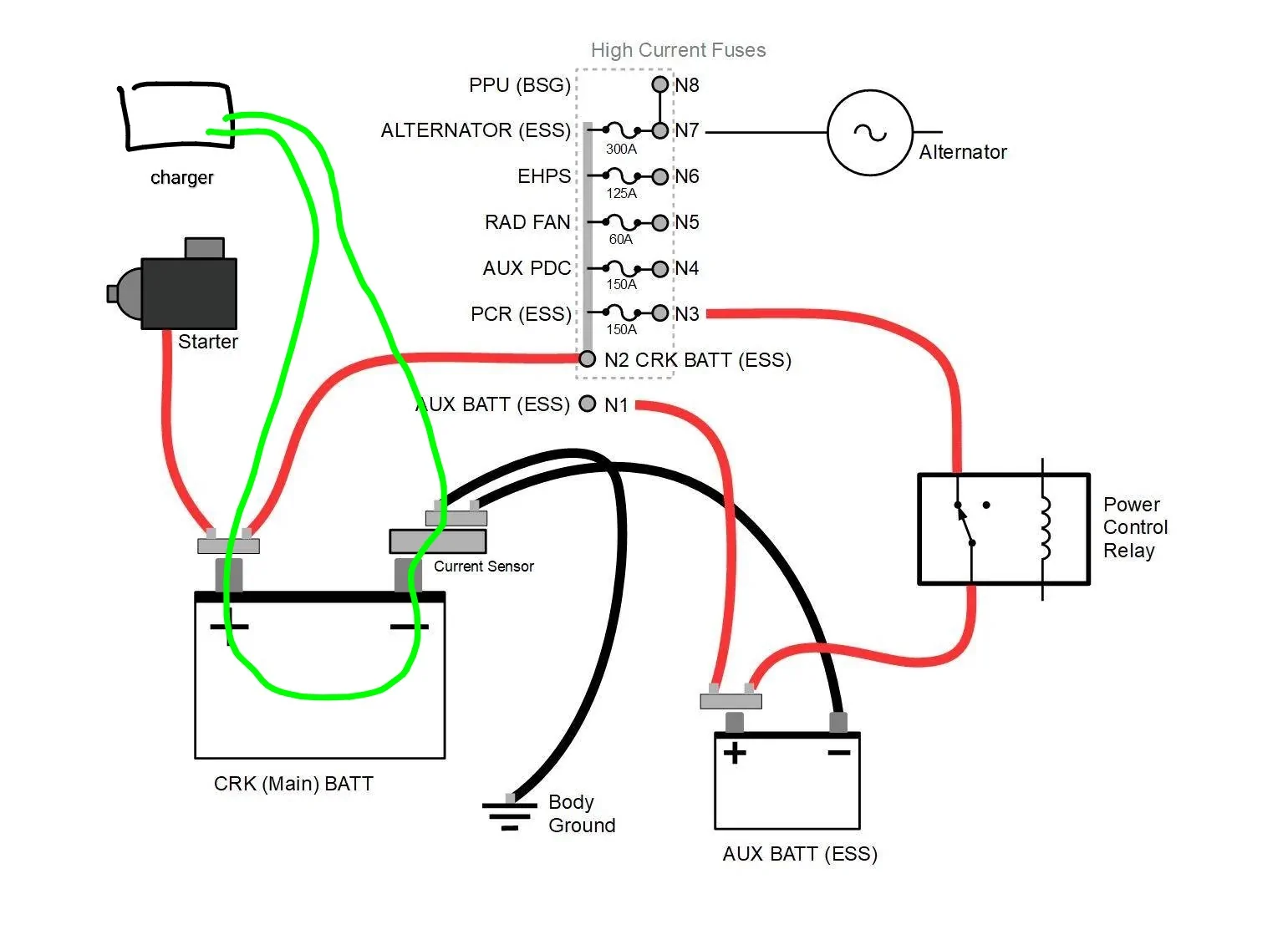

With the charger clamp connected like you first had it, between the battery terminal/post and the IBS ("current sensor"), the charge current doesn't travel through the IBS (it's basically bypassed), so the IBS doesn't know the battery is being charged.
Jeep Wrangler JL Trickle Charger? 1000005691
[It's even worse if there's an AUX (ESS) battery connected, because the IBS will think the charge current to the AUX (ESS) battery is a discharge current for the CR[an]K/main battery (while both batteries are actually being charged).]

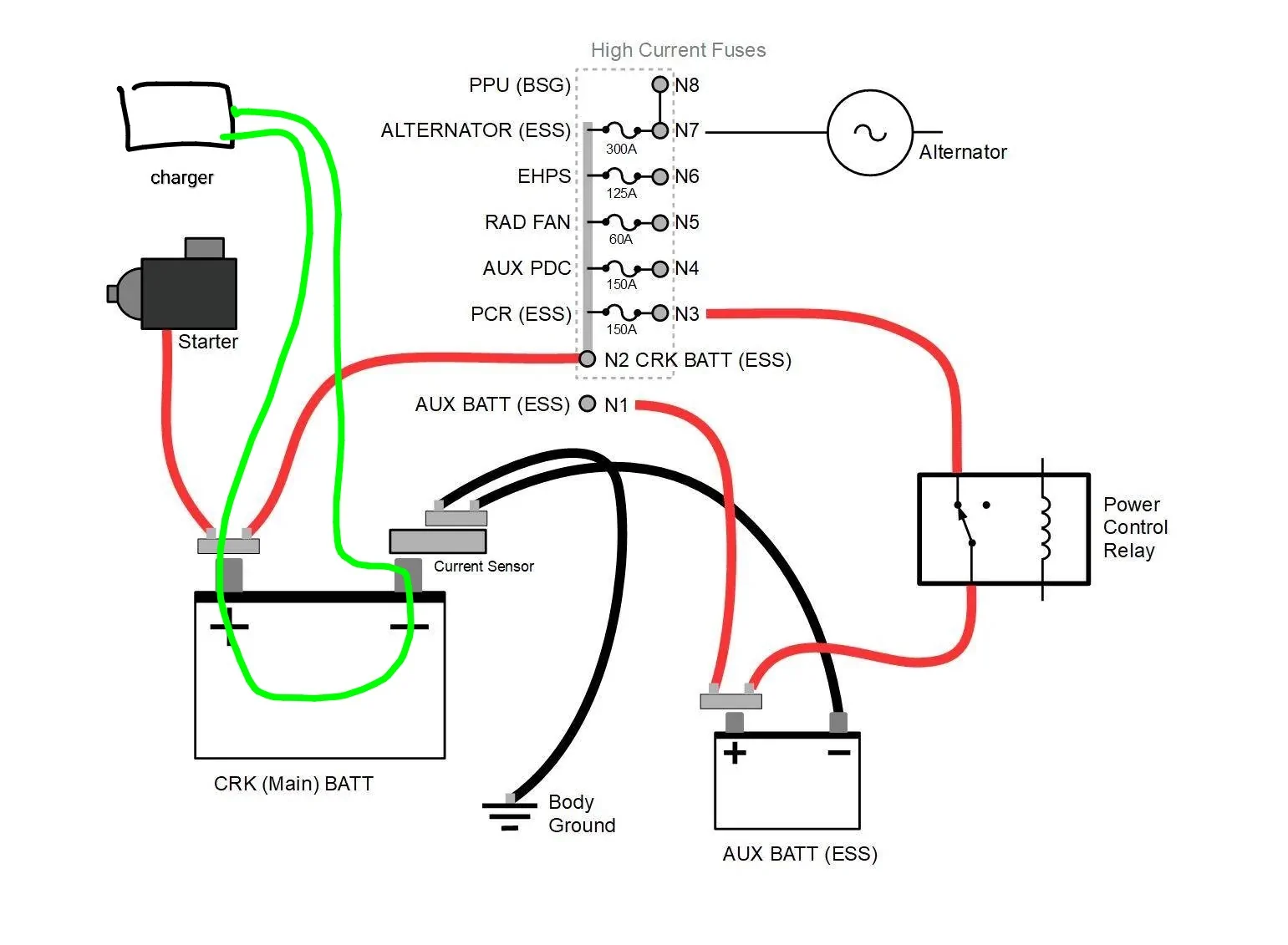

When you moved the charger clamp, the IBS ("current sensor") is between the charger clamp and the battery terminal/post so the IBS can track how much the battery is charged.
Jeep Wrangler JL Trickle Charger? 1000005692
Yes, I believe the body/frame ground suggestion is for spark safety when first attaching the clamp (rarely an issue). A body/frame ground position for the charger negative clamp does allow the IBS to properly track charging.

In good news I let the Noco charge overnight and it's blinking green and in maintenance mode. Turns out I just wasn't patient enough (which may be part of the answer to the above question of what's wrong with me). 😂
