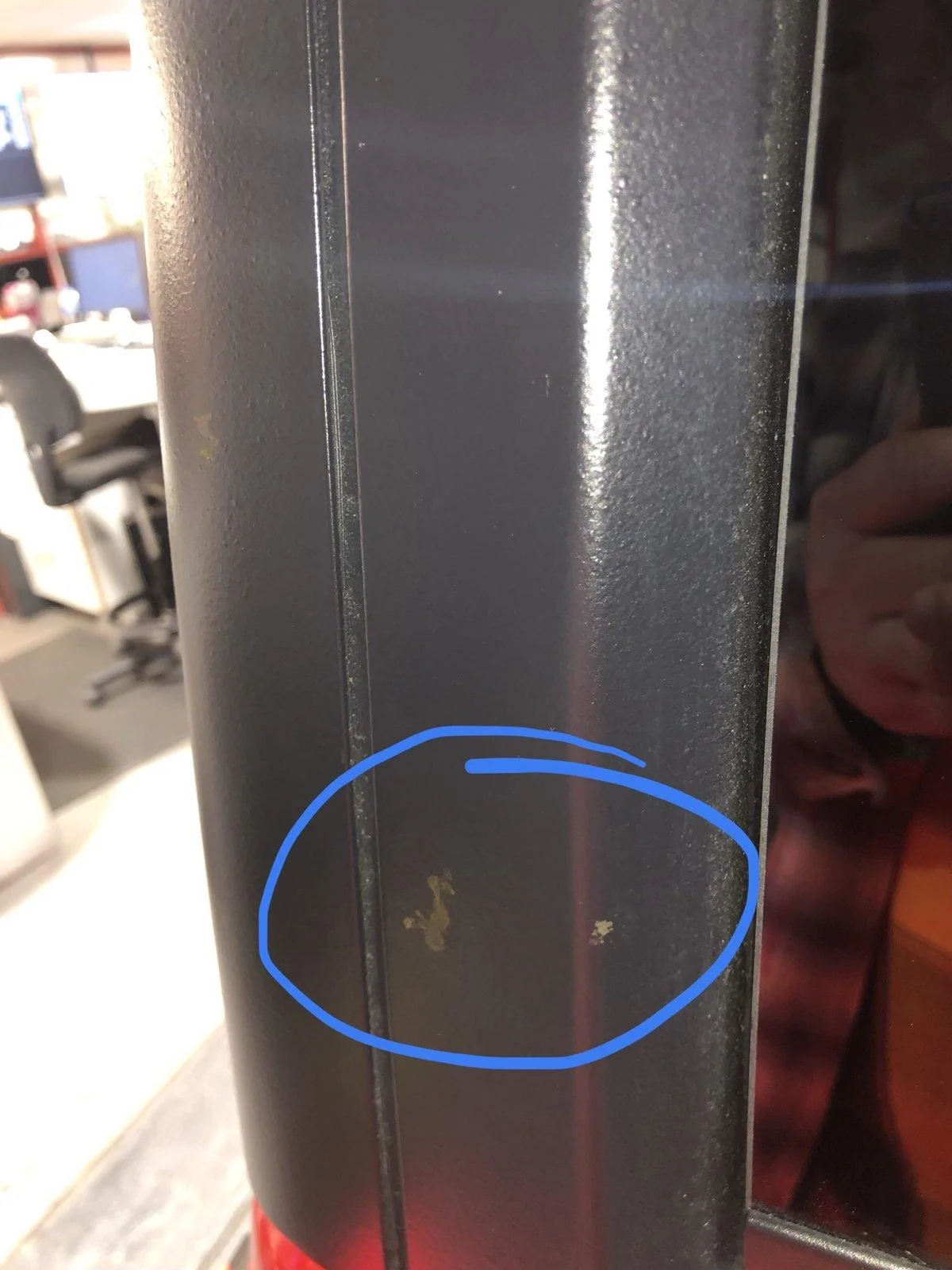

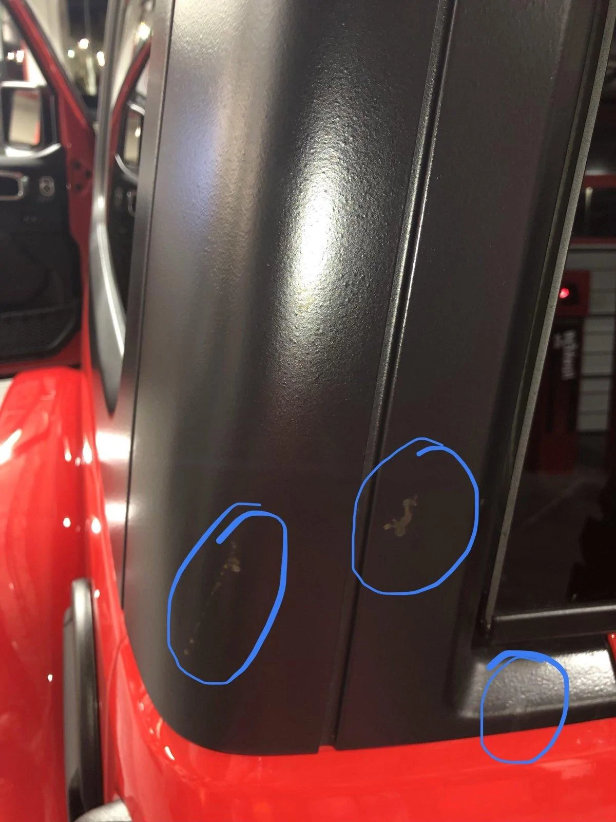

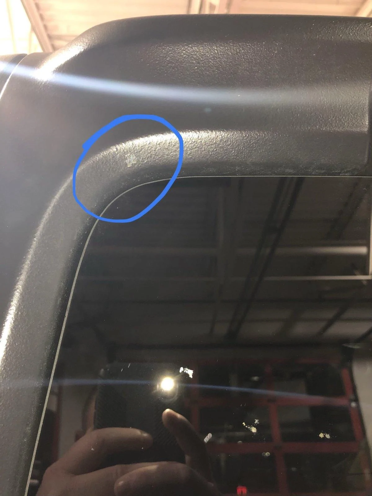

When getting my jeep back from the dealer we walked around it and noticed the black finish is coming off of the freedom top in 6 places on the very back where the transmission fluid was coating it after the leak. The spots are strangely colored with various shades of purple, orange, red, and what looks like rust. The service manager took pictures and is submitting them to Chrysler for a determination. There are also 3 small spots in the paint behind the spare tire where the paint appears to have bubbled. Does anyone else have problems with the finish coming off of their top? On my previous post I listed the output shaft as the location of the leak. The paperwork from the dealer last night listed the input shaft and input shaft seal as the problems and both were replaced along with the seal between the transfer case and transmission. By their estimate 2 of the 6 quarts of fluid in the transfer case had leaked out. They assured me there was no damage inside the transfer case, but time will tell.
