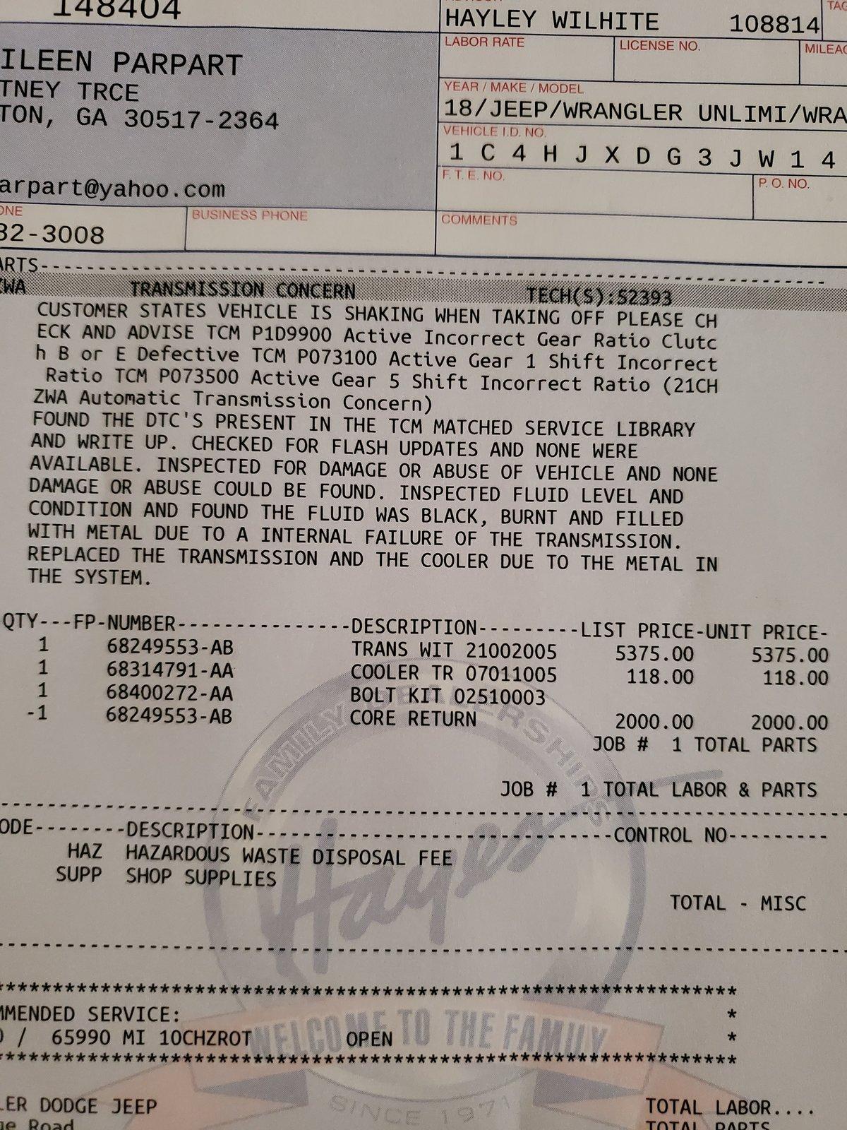

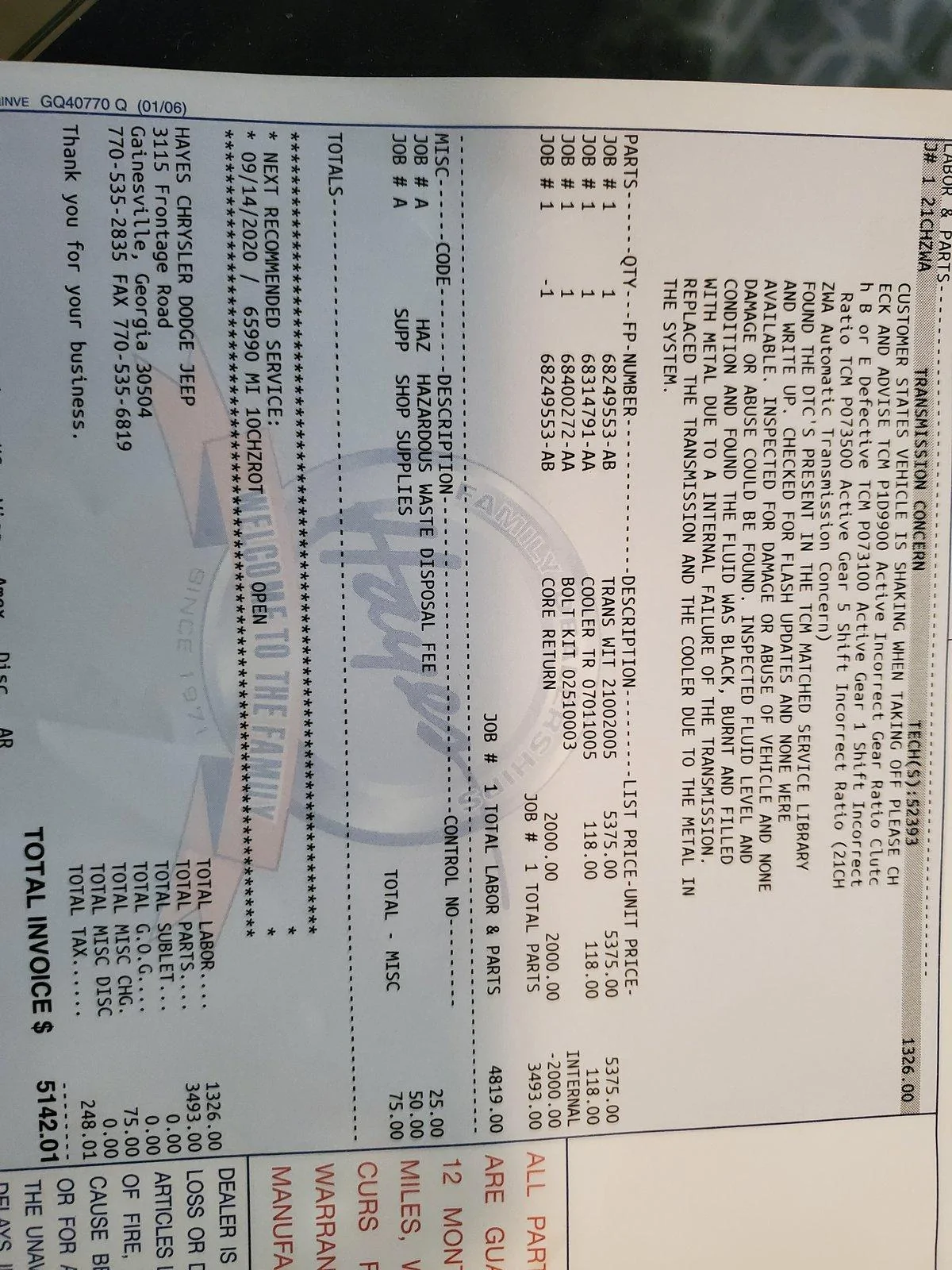

do NOT WAIT A MOMENT! I complained for 2 years about my transmission. At 65,000 after warranty very gear went out while driving on highway. If you get incorrect ratio gear take it over and over and over to dealership. Do clear them until you find issue. Cost me 5,200. Dealership kept saying there wasn't an issue.

It just burns me what dealers do to try and deny claims. "Inspected for damage or abuse of vehicle and none damage or abuse could be found"". What a crock. I have never seen this crap before on a warranty claim. The grammar is wrong and of course it's damaged or it would not have been replaced.
I had my transmission replaced under warranty at just under 100,000 miles no questions asked. Got my truck towed in and had transmission replaced in a day. Nowhere on the paperwork was this stupid nonsense. This is disgusting. Why even get a Jeep Wrangler and take it off road so they can claim you are abusing it?
