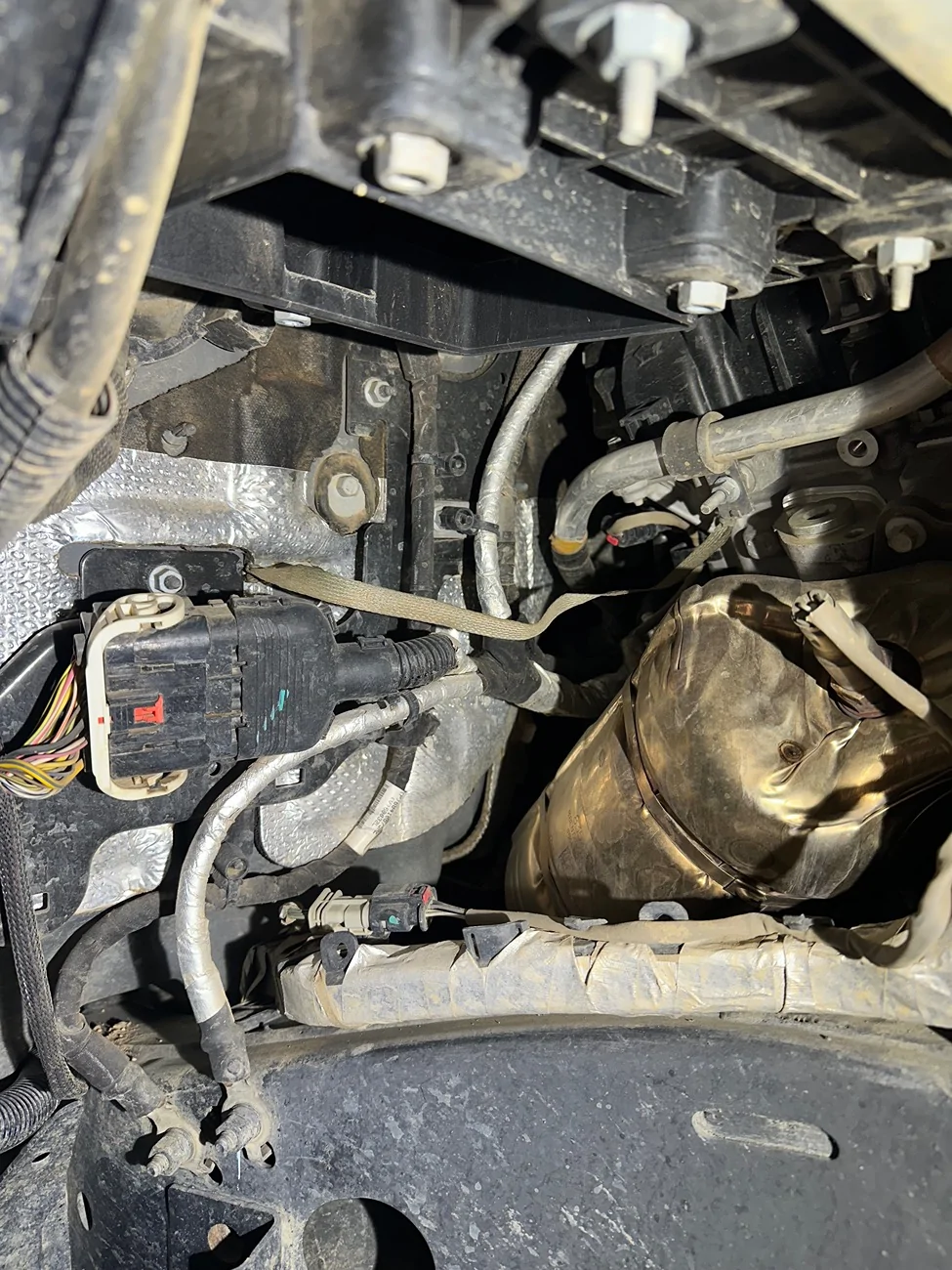

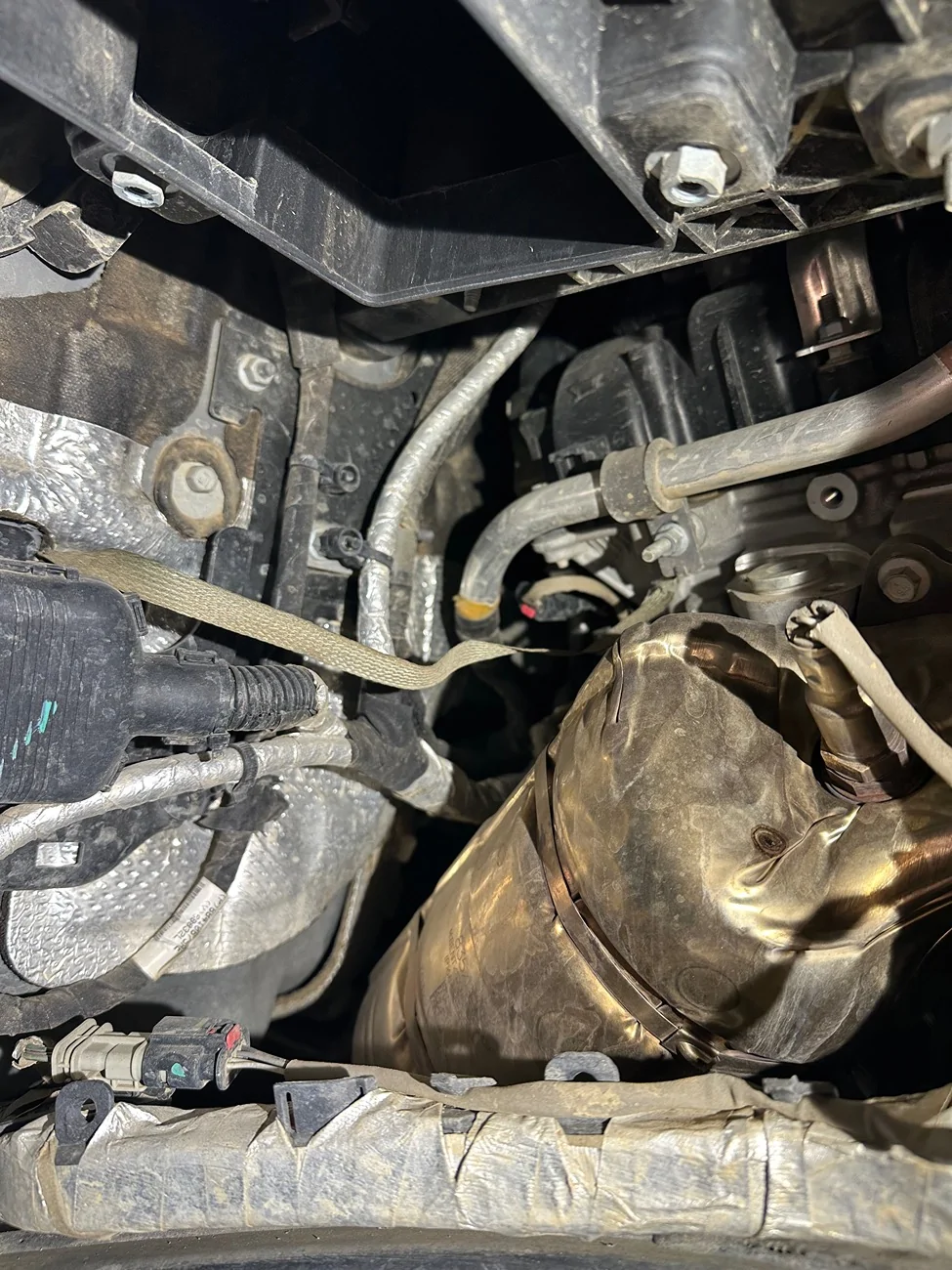

no, but there's quite a few threads about it on the forums already. remove r/f fender liner and you'll see a big connector along the firewall that goes to the bellhousing area. you'll want to cut and solder the power/ground wires around the connector. there's a 12v and a pink/yellow ignition run for power and a black wire for ground.

2023 JLURXR 3.6 ET
If it’s in either of these two pics could you point it out? i have my inner fender off to run some wiring.
