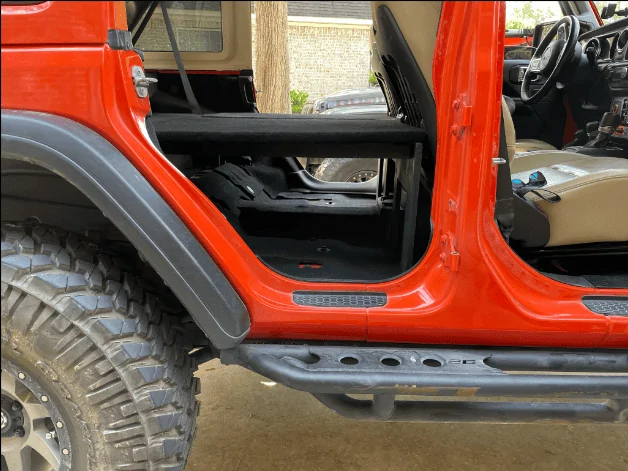

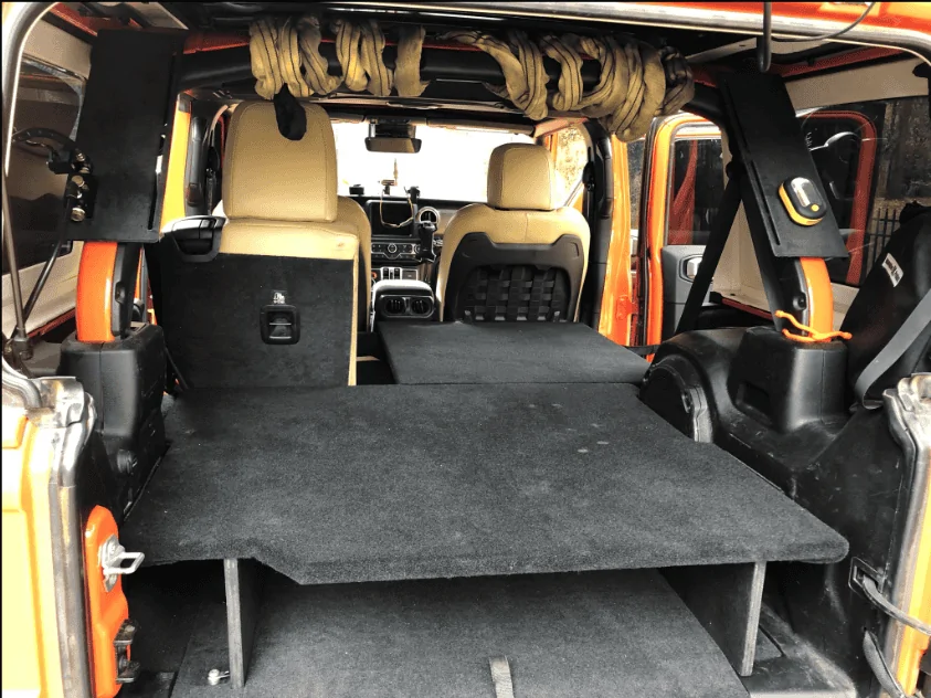

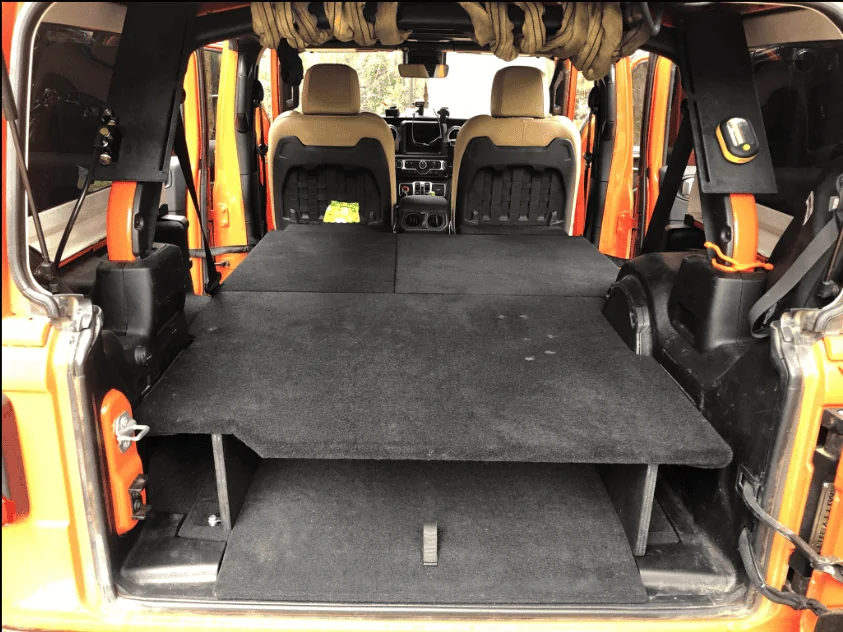

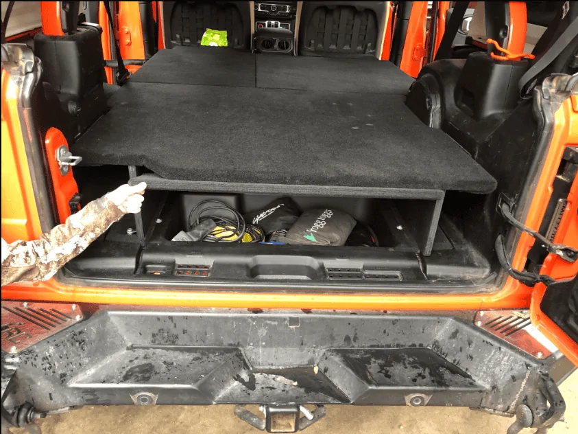

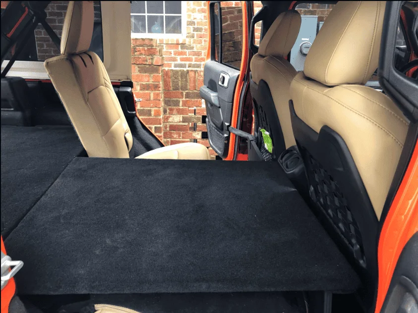

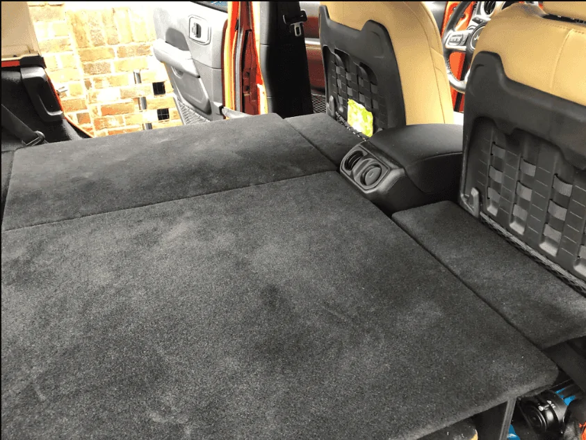

I built a rear platform for my Jeep using the Cheaper Jeeper design as a starting point. I modified it slightly to get a better fit, but it's basically his design. It cost less than $200, $70 of that was the automotive carpet, and was really easy to build. I bought a cheap piece of 1/4" plywood to use as a mock up then completed it using 3/4 hardwood plywood. You can run it with or without the back seat.

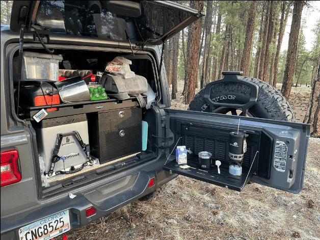

When we took our big trip this summer I used my Jeep as the truck and my wife's Jeep as the kitchen. My Jeep was a 2-seater and hers was a 3-seater. It worked well.
I have slept in my Jeep a few times when out working and it was fantastic for a night or two in this setup. I had an air mattress and a blanket. I think you could make it work for a week if you were alone.
Bottom line is... (1) next time we go we won't be taking our kids; (2) We're looking at trailers. A rooftop tent sounds pretty good but I don't want 150 pounds on my roof when I'm going up Hell's Gate (or similar trail). That would probably work better for "overlander" type trips, but we llike to crawl. I like @wibornz philosophy.
Jeep Wrangler JL Trailer vs Seat delete 1627483354169
Can still access the rear cubby and uses sides for storage
Jeep Wrangler JL Trailer vs Seat delete 1627483940167
2-seater configuration
Jeep Wrangler JL Trailer vs Seat delete 1627483972770
Jeep Wrangler JL Trailer vs Seat delete 1627483997152
3-seater configuration
Jeep Wrangler JL Trailer vs Seat delete 1627484016779
With back seat removed. I kept a lot of crap under the platform; water, sleeping bags, etc.
Jeep Wrangler JL Trailer vs Seat delete 1627484189084

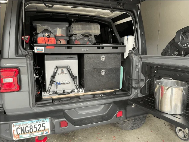

And here is my wife's Jeep set up as the kitchen (she's messy)
Nice job on the platform, simple layout. Do you know the oveall dimension from the tailgate closed to the end of platform behind the front seats?

This looks fantastic!!
With an aluminium frame underneath, do you thing you could get away with something like 3/8?
65 3/4". This works for my seating position. I'm only 5'8" though, if you're taller you may want to adjust that. With the seats all the way forward I can put the head rest in which is 6 1/2".
Edit: These measurements are with the carpet on
It would probably work with a wood frame and 3/8". I had a buddy thats nearly 300#s walking around back there a few weeks ago. Its overbuilt as is.
