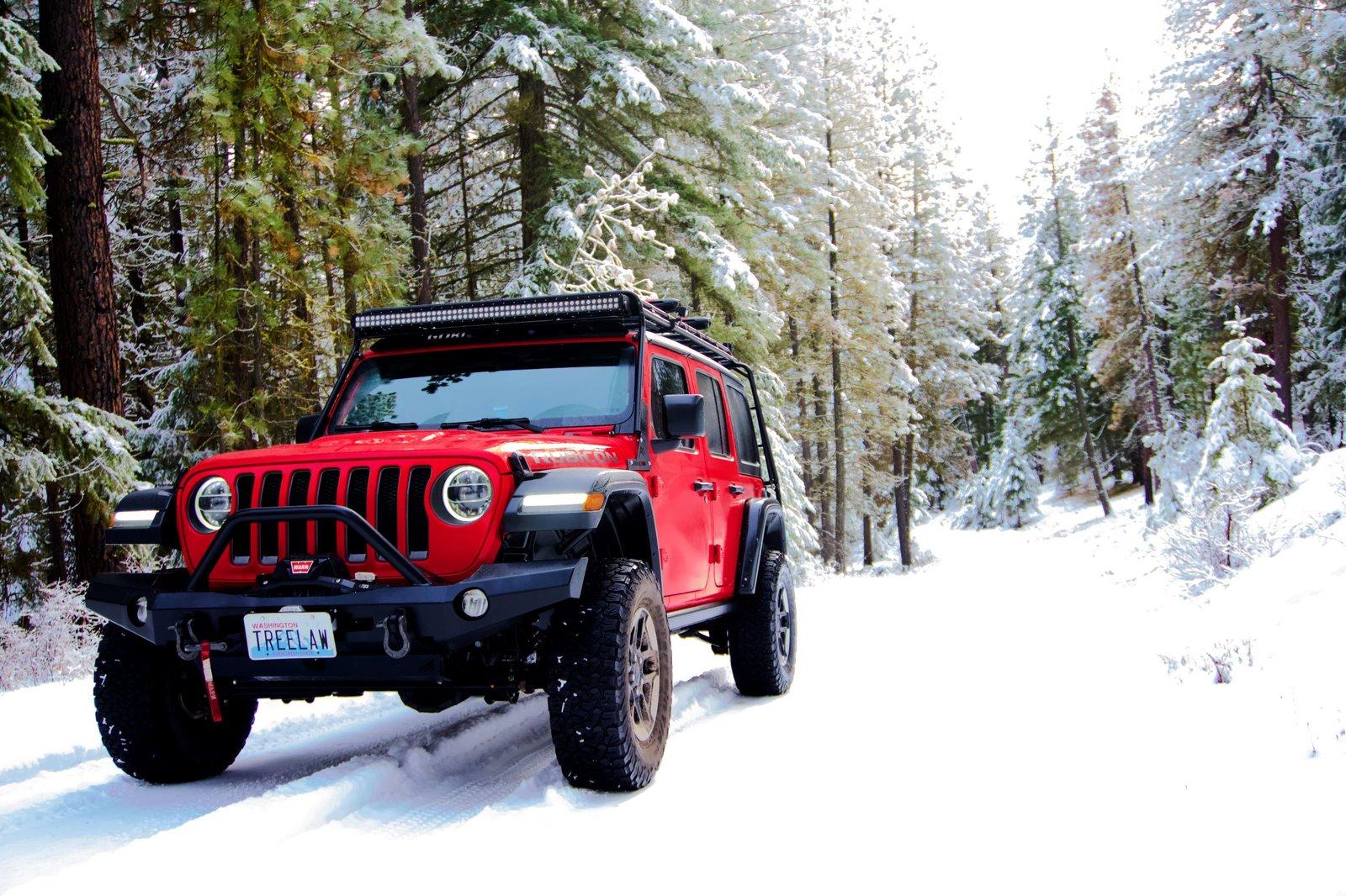

    The Trail Hunter was built to find and conquer the trails of the PNW. She's not a designated rock crawler, she's not a designated long trip overland; she does it all. She tackles the back country roads, rough green dot roads, scramble up rocks, chase deer, and haul family and camper trailer to base camps. She's is a Rubicon purchased from Dave Smith in Idaho. The Trail Hunter's mods to help her conquer the PNW trails include:
    2" Mopar Lift with Fox Shocks
    Teraflex Next 2.2 Steering Stabilizer
    35X12.5r17 Nitto Ridge Grapplers
    Warn Elite front bumper
    Warn Zeon 10s winch
    Warn elite rear bumper
    Gobi Stealth Rack
    KC 50" Light Bar
    KC Scene lights - 4 pods
    JL Tazer
    Mopar All Weather Floor Mats
    Mopar Grab Handles
    Dometic 35W Fridge
    ARB Twin Compressor with tank in suitcase
    Im feeling really happy with the build right now and don't have any more mods planned in the immediate future but I am sure I will get some ideas down the road.

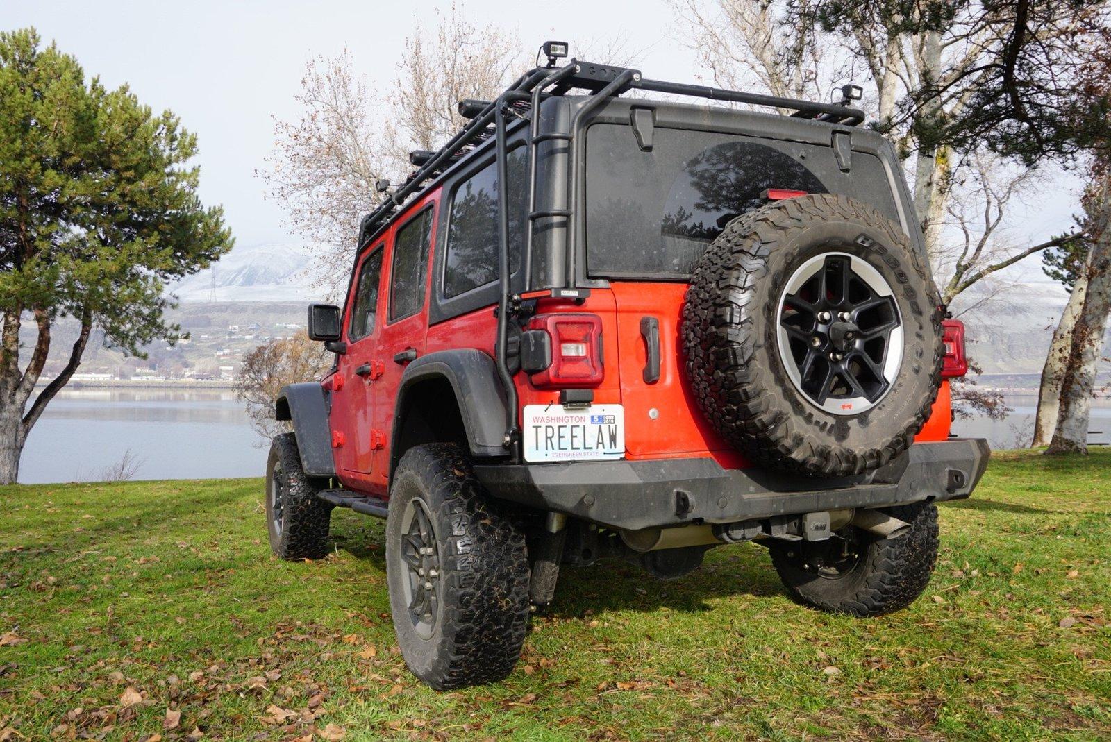

    Do you have a picture of the Warn rear bumper. I've been trying to find some info on this set of bumpers

    I’ll get some more pictures soon. I got it in early and am waiting for the tire carrier. The bumper itself is awesome. Low profile and super strong.

    If you could I'd like to see a side shot.

    here you go

    That is exactly what I was looking for thanks

    You bet. I was kind of nervous because I bought the Gobi Rack first and then realized they might not be compatible but they are- perfect fit.

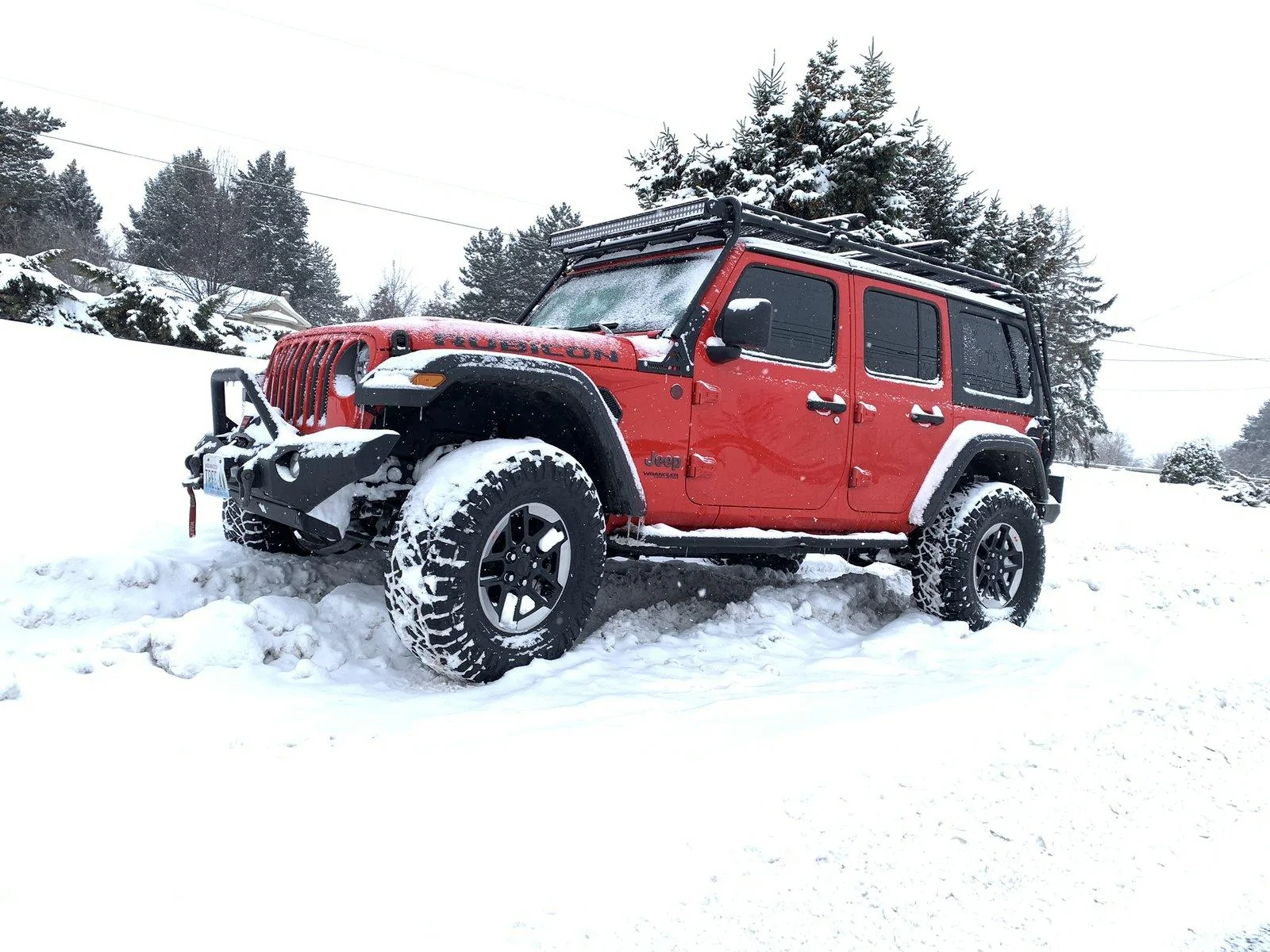

    great job. really a nice build. love those kind of clean build. so you put the 35 on the OEM rims? no issues? and what about the width? still inside de fenders or is not is it a big gap ?
