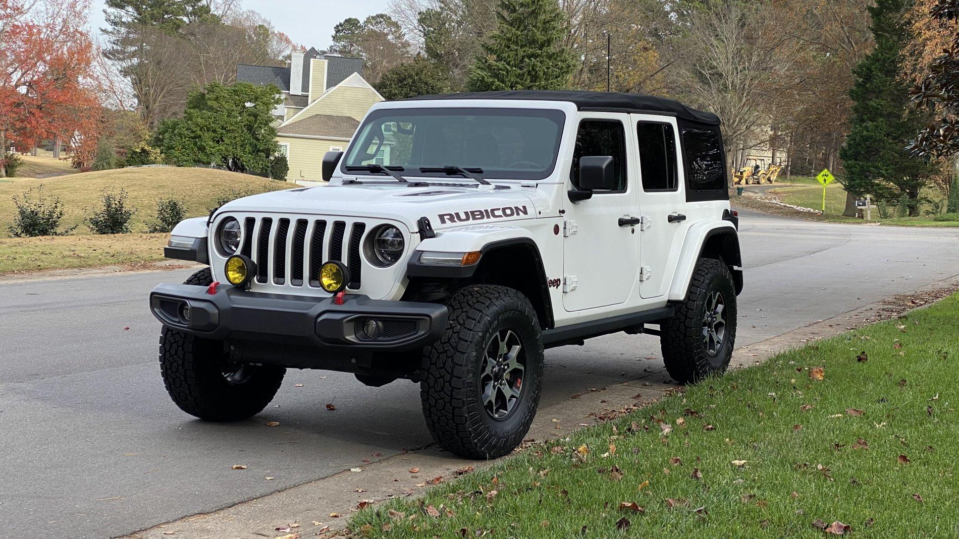

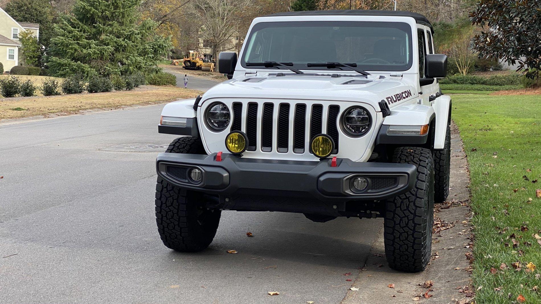

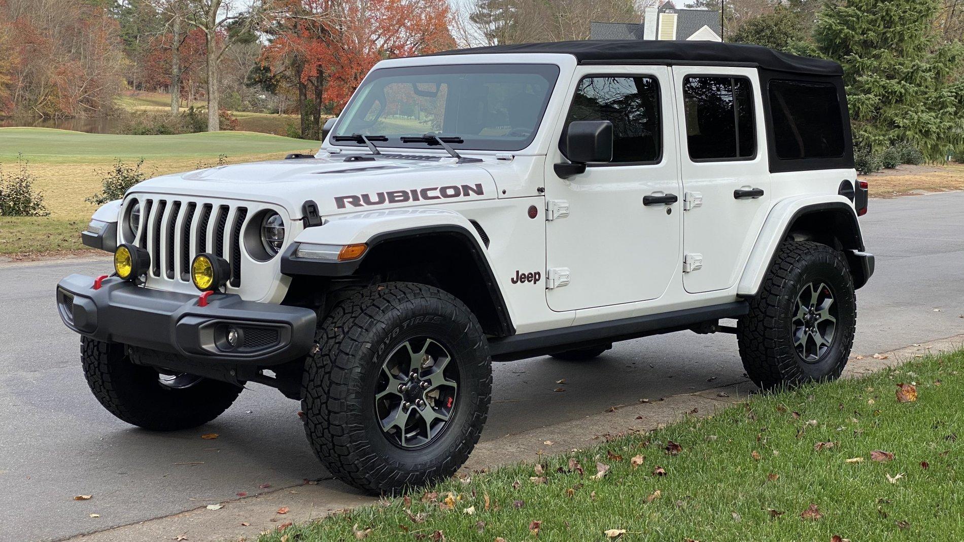

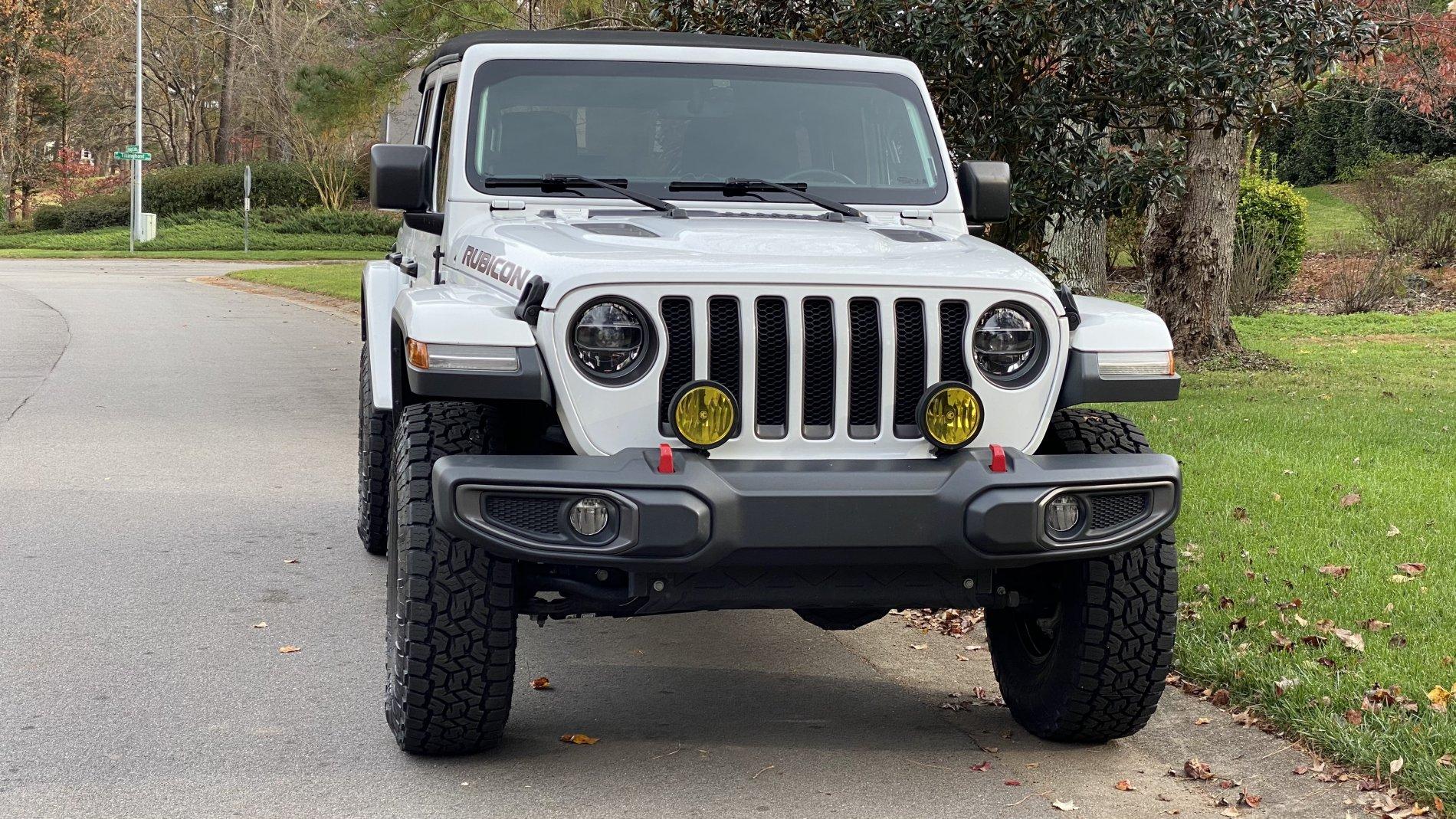

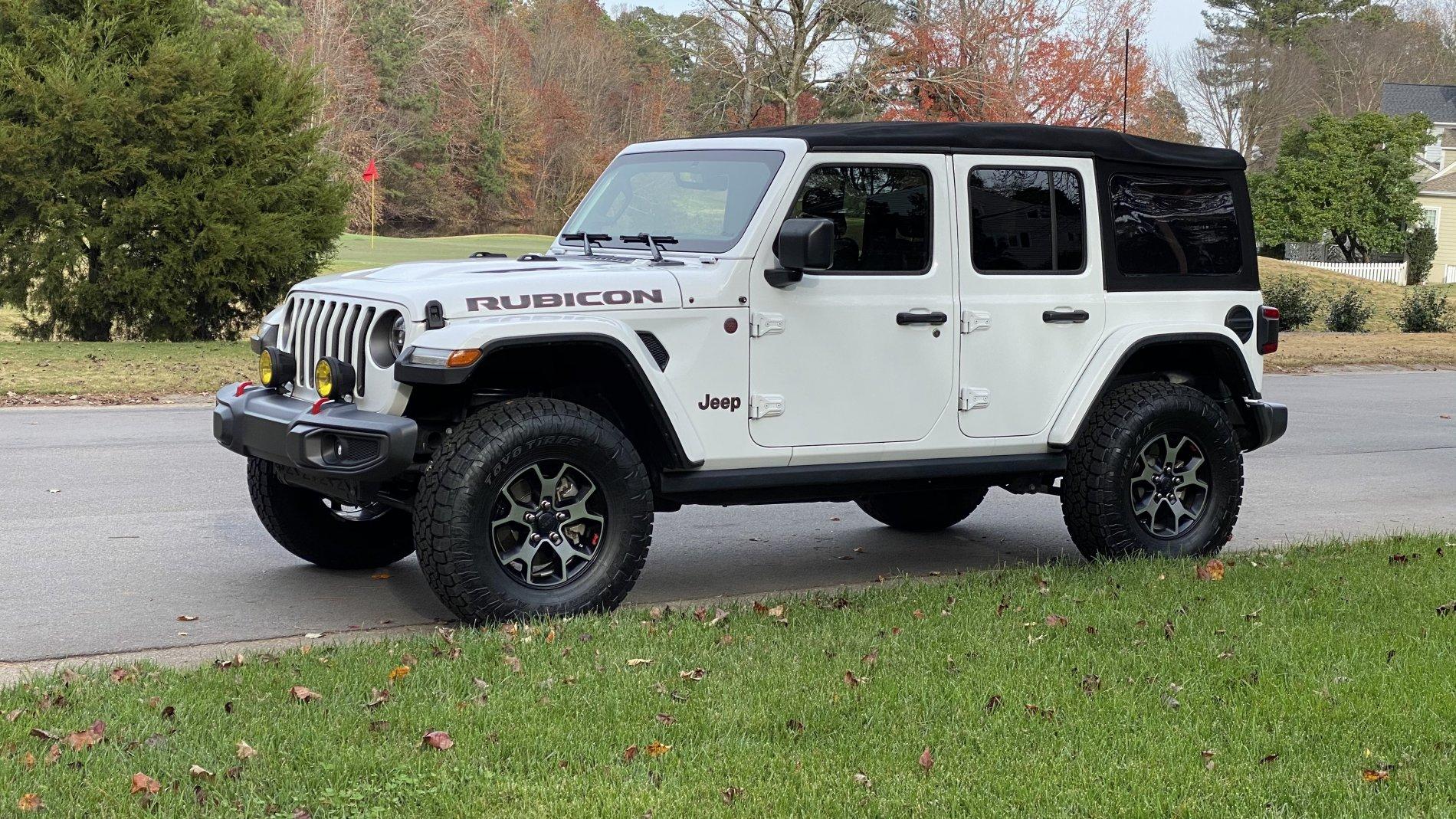

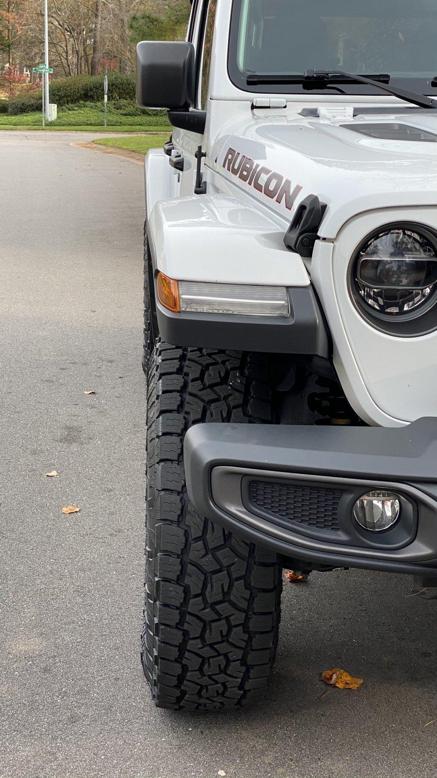

I have driven them about 500 miles now and like them about as much as my stock KO2s. I can’t tell much of a difference between them, except the height of the new 35s. I measured actual size mounted on the Jeep and inflated to 37psi and the true height is 34” exactly, but then again the stocks measured about 31.5” so the net height gain is about 1.25”.
They are much quieter than the KO2s with 40k miles, but any new tire is likely to be quieter than a used tire.
I added a 1.5/1.0 lift from Traxda to give the Jeep a more level ride and maintain the stock wheel well spacing. Rides like stock.

Looks great! Simpletire doesn’t have installers near me so I’m going to get the 315s.
Taxman
Alex
Apr 13, 2018
209
413
Raleigh, NC
1985 CJ-7, 2018 JLUR
CPA
I had them delivered to my house and had a local shop mount and balance them for $100 for all five.

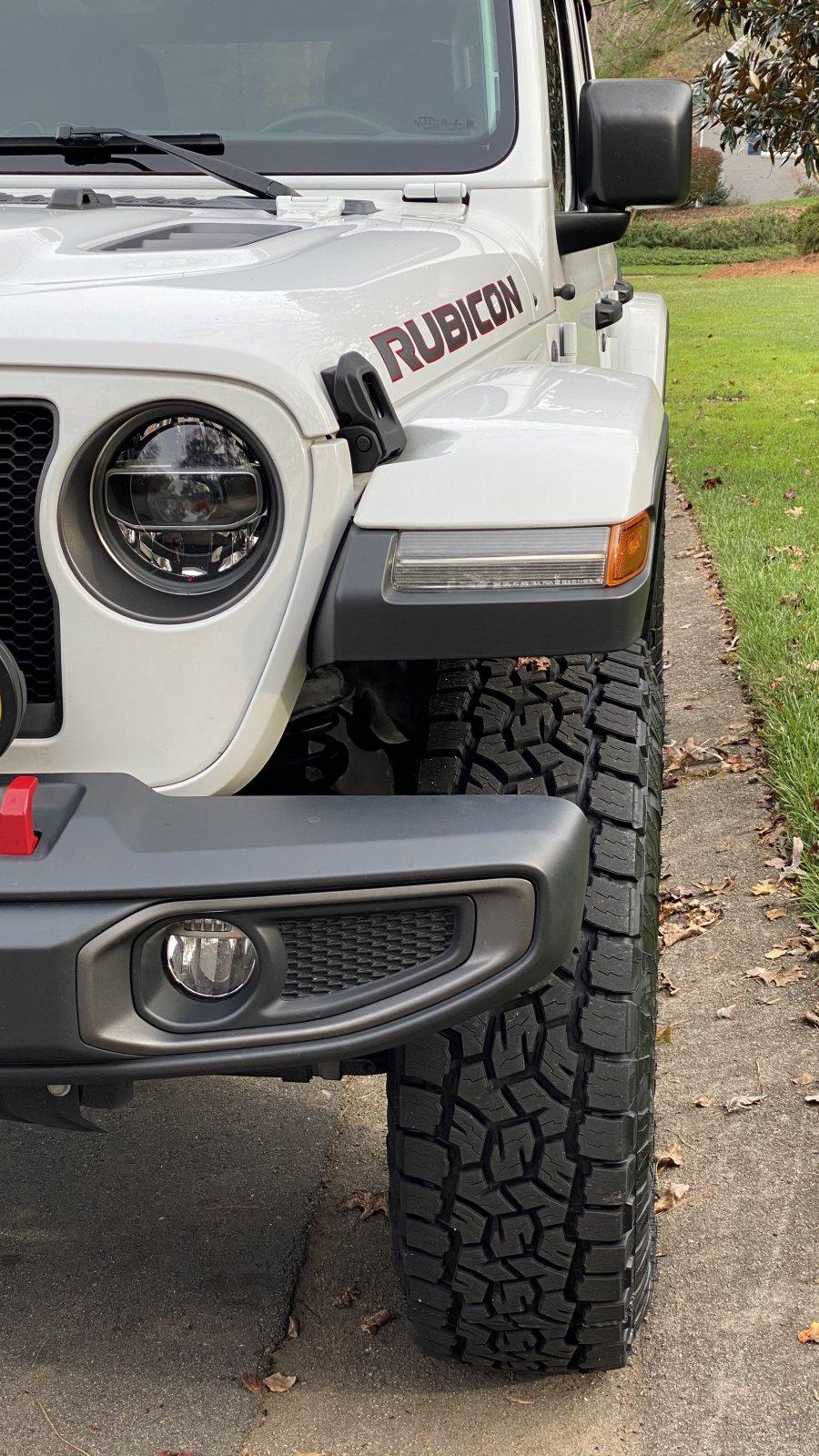

I finally got the Toyos mounted. Prior to the tires ground to bottom of wheel well was 37" With the Toyos just under 38". So an inch higher.
Now waiting on the springs and control arms.

The springs and control arms are installed. Now the measurement is like 39 3/4". A gain of just under 3" of lift. I like the look and feel the way it is. The spare rubs pretty badly on the rear bumper so I've got a relocation kit coming. Also added the steps. They work and look great.

Nice upgrades Mark, looking proper!

Thanks Brad! And all this time I thought Harleys, Porsches, & Corvettes were expensive to customize 😂
