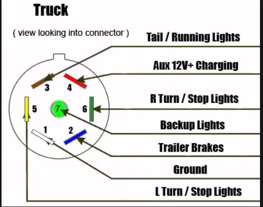

can anyone that has the tow package answer a question for me... one of the pins in the 7pin connector is for power to the trailer and I was wondering if there is power to that pin or is there more that needs to be done to get power there. Its pin 4 the picture is looking into the connector on the jeep not the trailer....
