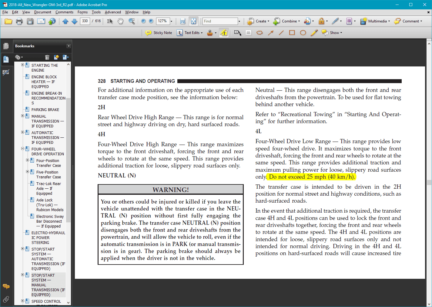

Often times when we off road we keep it in 4LO because of the rocks we climb. My wife is very fond of plowing through puddles with a little speed. It makes me a little nervous when she guns it to hit the puddle when she is in 4LO. Obviously we aren't talking any sort of crazy speed, I'm guessing tops 15mph? Any chance this is a bad idea?
And no, we don't want to shift back and forth between LO and HI since that is a total pita.
