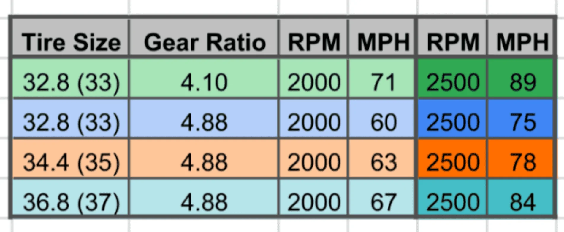

Like many of you, I have started playing with adding larger tires and lower gears. Using @AnnDee4444's awesome gearing calculator, I can see that 4.88 gears and 37" tires will be about the same (more or less) as the OEM 4.10 gears and 33" tires.
I am leaning really hard towards 35" tires because the 4.88 gears will give me a little more response and torque, but then I am wondering what a 2.5" MC GC lift will look like with 35" tires.
Opinions welcome (help me with my paralysis by analysis)

With 35s and the auto I'd stick with the 4.10 for now. Between the advantage of having a torque converter and the gear ranges in the auto I think you're in good shape with 35. Especially as a daily driver. Personally I think the 4.88 are a bit too much for a 35, and our 8 speed is different world. It's a lot different than the jk days with the 5 spd auto. On the plus side it keeps your axles under warranty. If you go up to 37s maybe change to 4.88 then.
Since you have a rubi you already have the extra craw 4:1 gearing of rubi's transfer case in 4lo vs 2.72 in a non-rubi. Your final drive in 4lo is still lower (numerically higher) than a non-rubi with 5.13s even. So the rocks shouldn't be an issue for you at all.
Have you considered a tuner like a SuperChips? That could put some pep and throttle response in your jeep. A lot of the time that missing response and torque is actually the computer doing "torque management" and not giving you what you ask for when you ask for it. Just because you floor it doesn't mean the computer gives you full throttle. Drivability on tuned jeeps goes way up. Bonus... you'd be able to adjust for tire size and gear changes any time you wanted.
I'd try keeping the 4.10 and 35s with a tune and see how you like it. You can always gear later.
