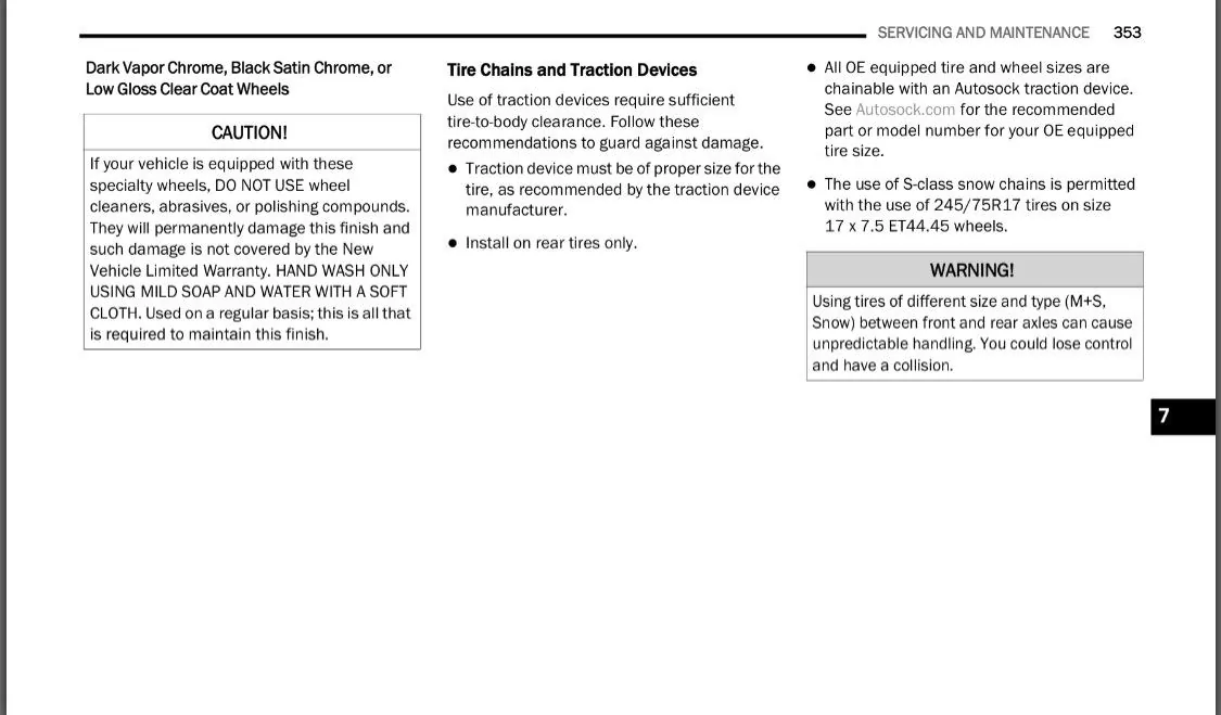

I have a 2020 JLUR and don’t see language in the manual stating I can’t use chains, “rear tires only”.
After seeing many having trouble on icy trails recently, I’m also looking at chains...

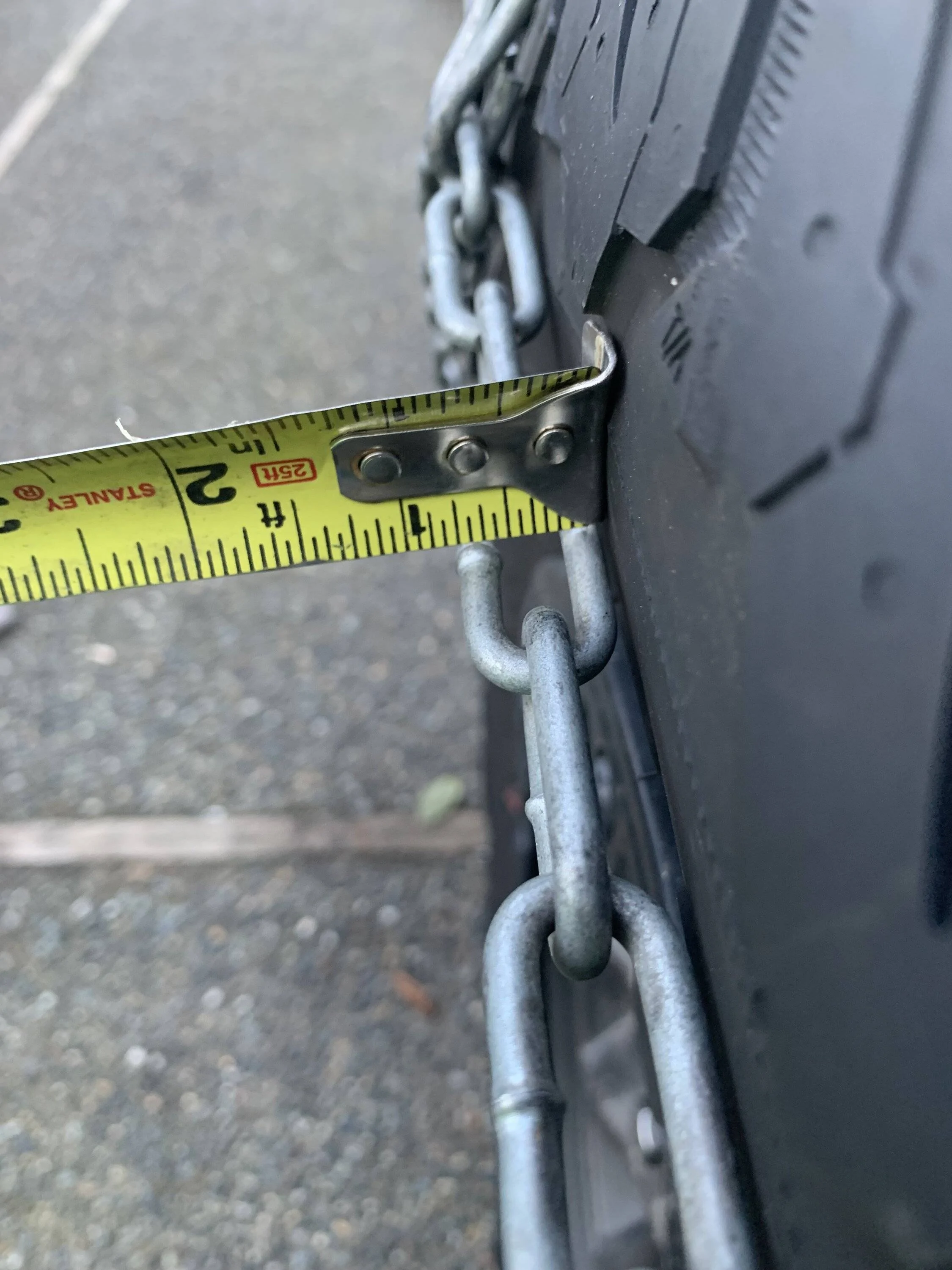

To ensure safe fit, I've checked tire clearances on all four wheels including lock-to-lock on the front. I use them only in conditions where there will be very little axle articulation. For the initial installation I dry-fit the chains carefully ensuring that they are the correct length, adding or removing links if needed. When using them I install, drive a 50 yards and re-tighten, then check again after driving a short distance. Any flailing links or looseness could cause a lot of damage in a hurry. A couple of bungee cords to help with the end link tie-off and to take up any residual slack.
