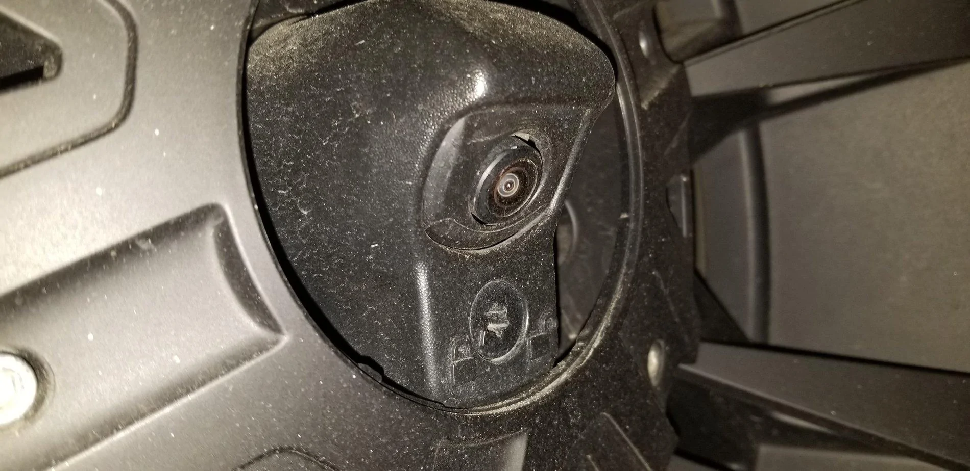

I tried using spacers and unfortunately the screws are too short to really make a difference plus there are fairly tight tolerances so I had to trim the spacers down. Eventually I gave up on the spacers and jerry-rigged it and it works 90% of the time....
Here is what I did:
- Separated the camera from the perch
- Put the screws back into their holes and left them hanging out about 3/4 of the way
- Pushed the camera into the hole unattached to the mount so the top of the screws could put pressure on the metal monting portion of the camera
- Slid everything back in and the camera sticks out as far as it can possibly go and it mounted securely.
- Yes its ghetto, yes it works..
Here is a picture of the camera...sorry its dirty

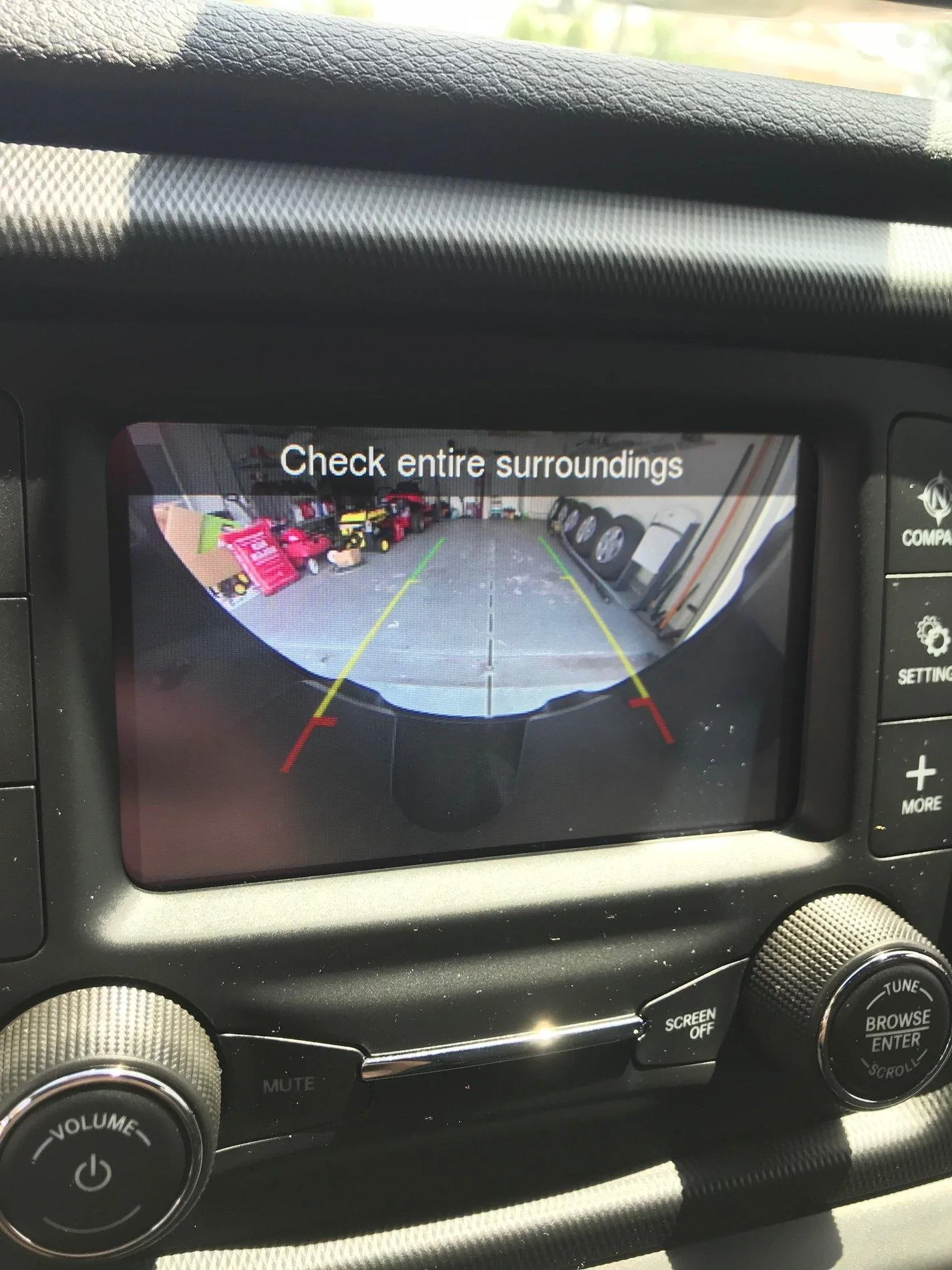

Do you still see the wheel in the camera? See what I see currently.

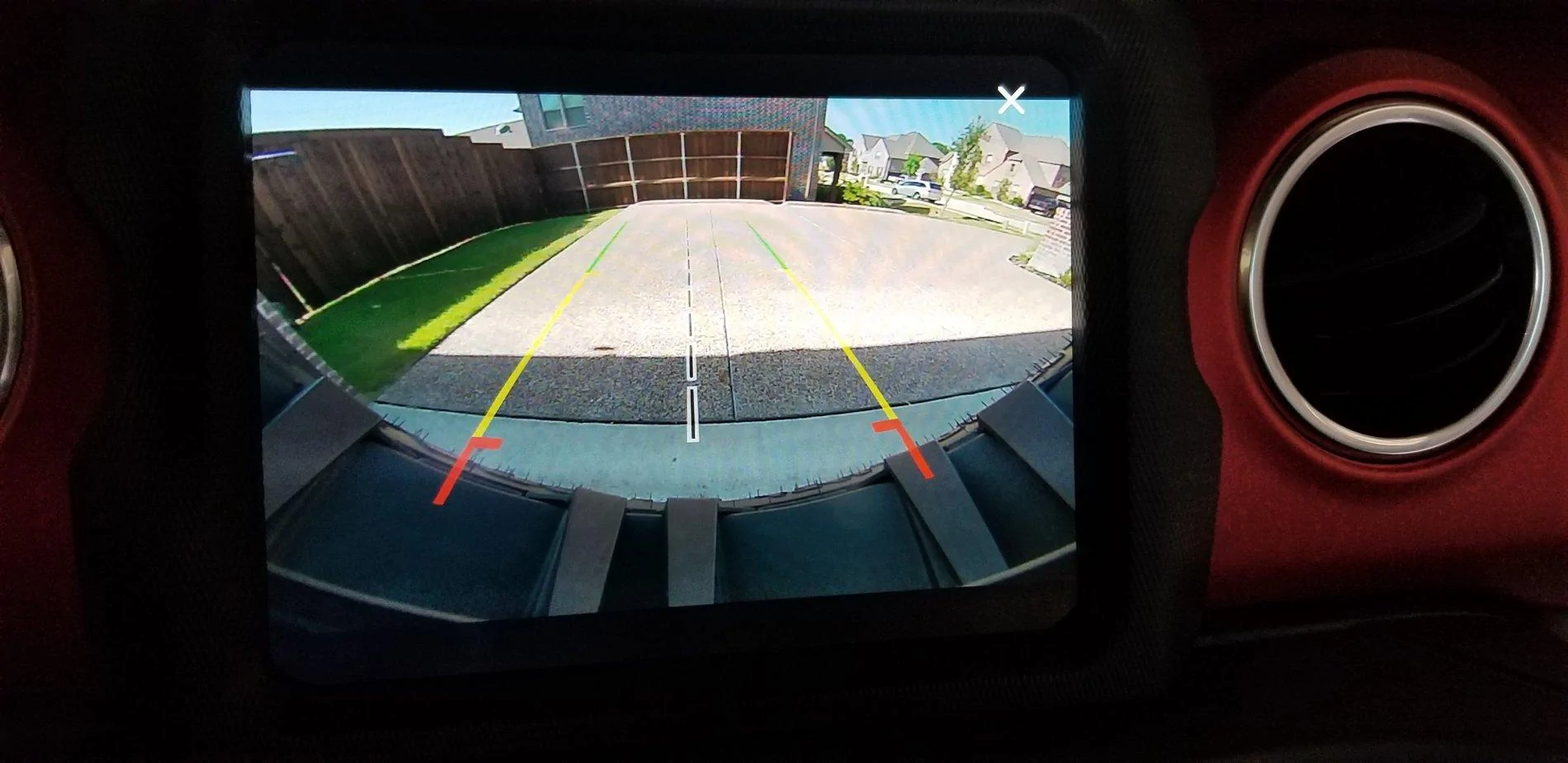

Yup i still see the wheel but the red lines are barely touching the wheel so the sensor rarely goes off. Ill grab a pic and post in just a few.
When you can please post a pic, thanks.

Mine looked like yours prior to pushing the camera out. It now only buzzes 5 to 10% of the time and only for a short second. The rear sensors are finally worth something :)
Yes I think it will help you at least a little bit.
