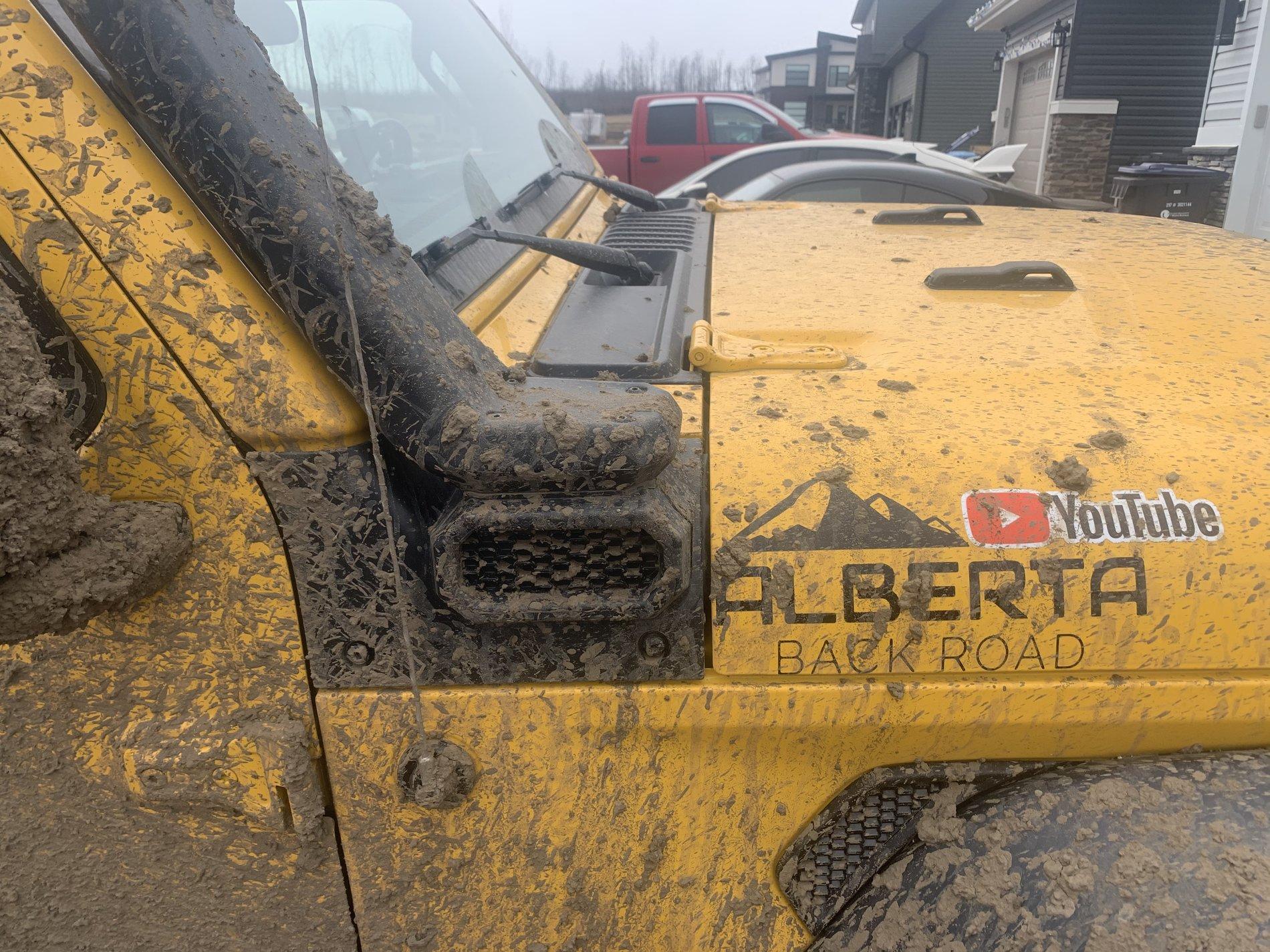

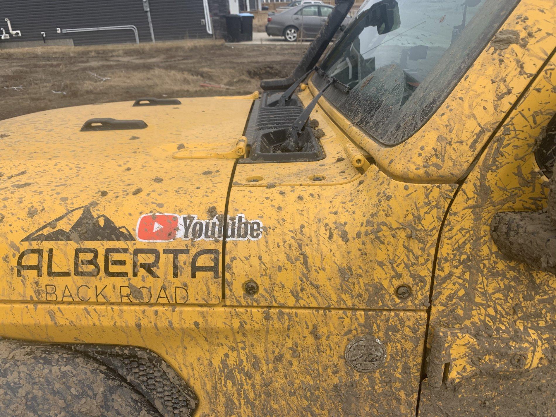

I just watched your video. The only thing holding me back is that damn cowl gap. In your video you mentioned that the gap can be eliminated with a friend pushing up on the cowl while it’s being tightened down. Would you happen to have a photograph of what it looks like installed with a friend pushing up on it.
thanks in advance!

Hey I’ll get a picture for you tomorrow as soon as I get a chance! Sorry for the wait!

That looks great. I don’t even see the gap anymore. I’ll be ordering one. Rugged Ridge can thank you haha.
Glad I could help! Also, I’ve been putting it through it’s paces, and can personally say, if installed properly it is very water tight; I’ve been through water over the hood several time’s with it, and the air box and filter stays bone dry.
