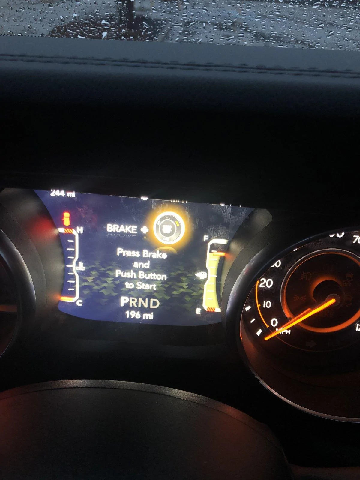

Picked up my new 2020 Sahara Unlimited Altitude on Friday and she breaks down tonight. Third night and she is sleeping in the cold at a shopping center parking lot! Gonna be towed in the morning back to the dealer. It won't start. Dash screen is showing all kinds of warnings and an outside temp of 106, push button won't turn off the run sequence, all the lights are flashing when you try to push the start button, and screen now says it's not in park. Something is really messed up. Nice way to end the weekend. Only 196 miles!.......WTH
Same symptoms I had and in my case it was a bad alternator from the factory. Replaced under warranty and no issues since (Im now at 20K).
