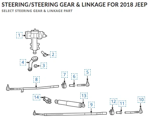

There is a brand new part number as of now - Link Rod. It goes into the pitman arm. #5 Below. Old number is 68258760 AB is now 68258760 AD.
Jeep Wrangler JL This is Death wobble drag link drawing
