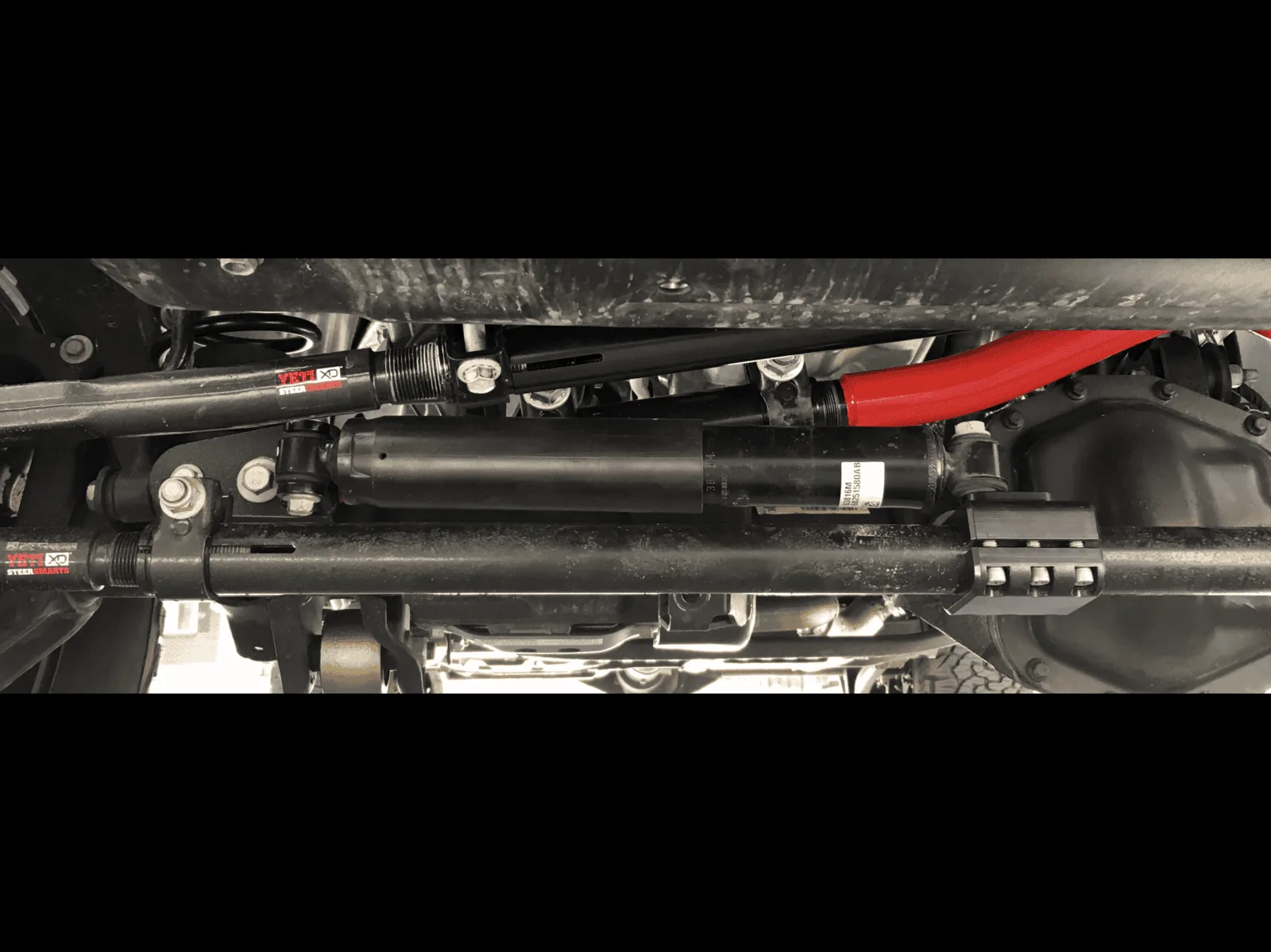

I didn’t have death wobble just some steering wheel shake when hitting bumps with just 1 tire when going > 35 mph. I put Steer Smarts trackbar, tierod and draglink Assy on my 2 dr Rubi and no longer experience this. I ran without a steering stabilizer for 2 weeks. Today I installed my stock steering stabilizer. Everything feels solid.
I hope those experiencing DW have a similar experience.
That looks great. I hope this is the solution. I’m ordering two kits. One for me and one for a friend of mine that’s having a nightmare with her newly lifted Sahara
