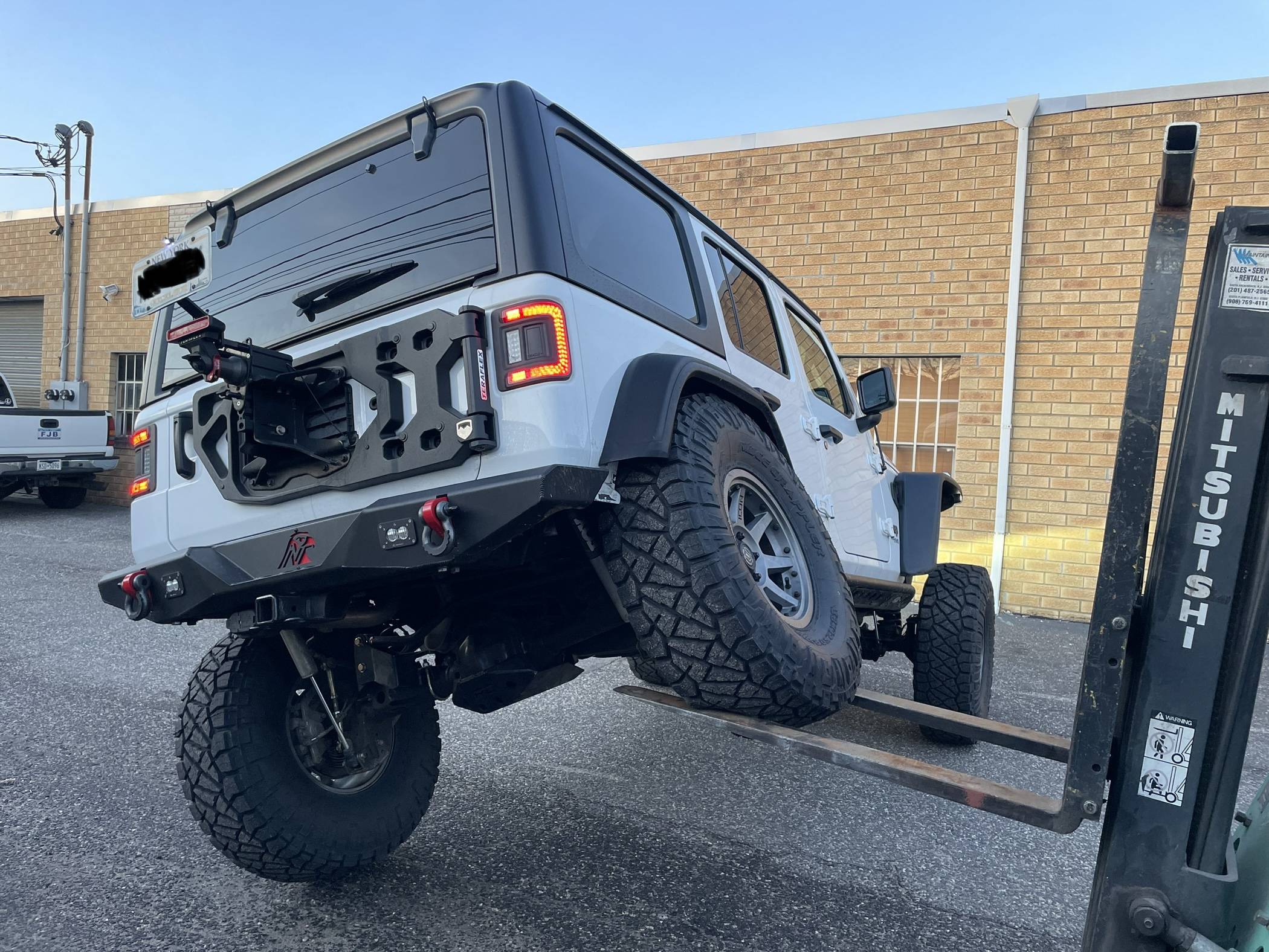

I havent hit it on anything yet to see if it moves, but I really doubt it will. its rock solid. I definitely have no regrets or anything bad to say other than the install may not be as easy as other bumpers.

Love the red accents you went with on the recovery points and logo backer plate.
I'll be the first to admit that install on that rear bumper takes an extra minute to get everything lined up. If you want something that will sit tight to the frame and not migrate into the body tub over time, AND hugs tight to the body/frame so it's not often catching, it's difficult to make install a breeze -- the looser fitting bumpers do a great job of fitting loosely. I just can't stand a rear bumper that makes it's way into the body - protecting the tub is part of it's job on the trail.
Hope you're getting to put it to good use on the trails; thanks for sharing the feedback on it!

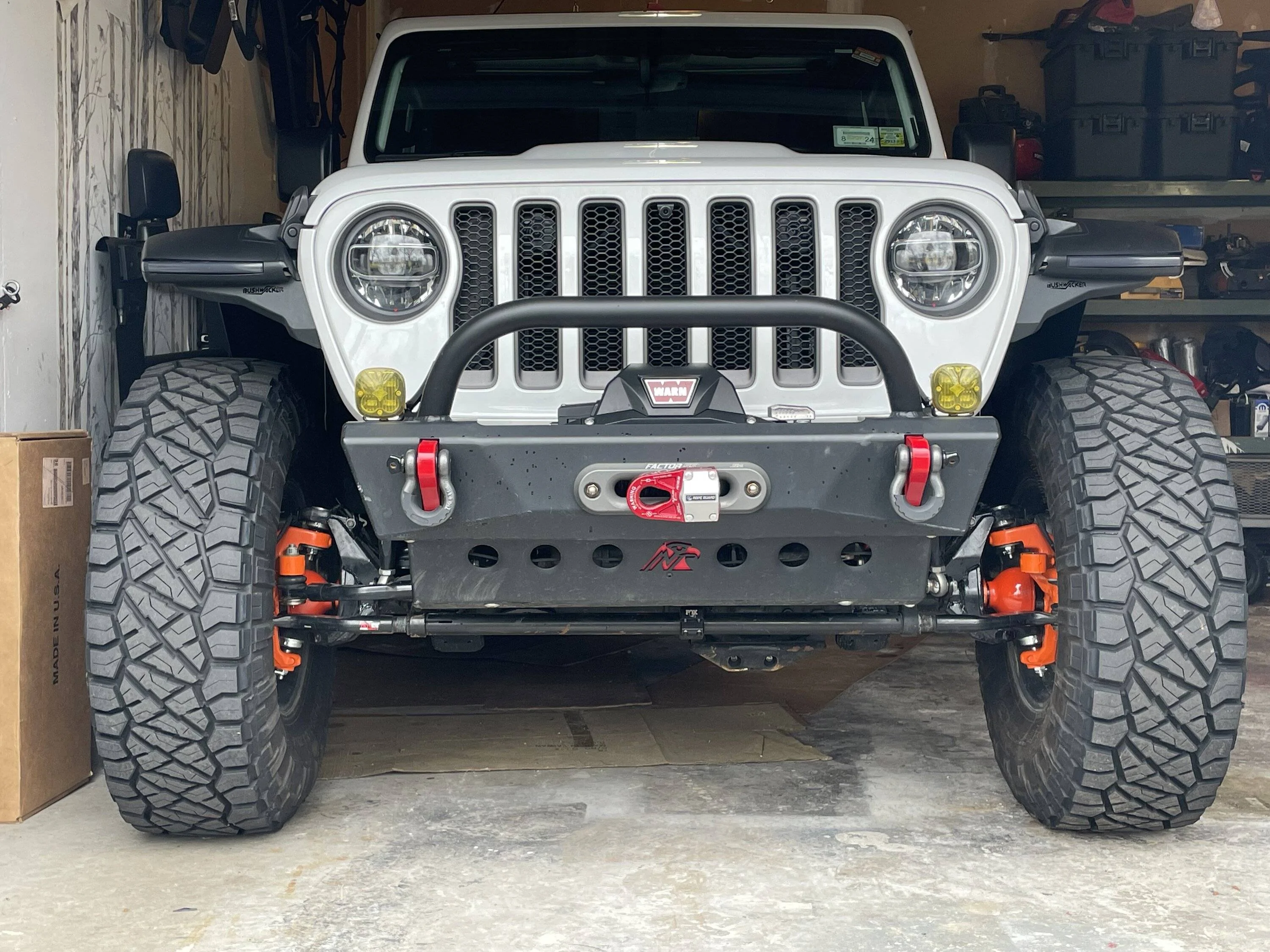

Front came out great too. just enough room for some Baja Design fogs. Your belly skid system with the uhmw is next on the list.

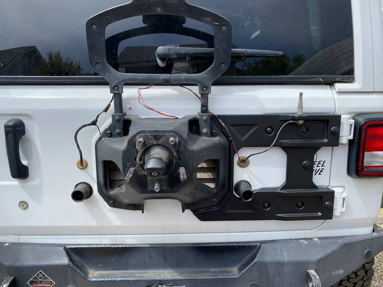

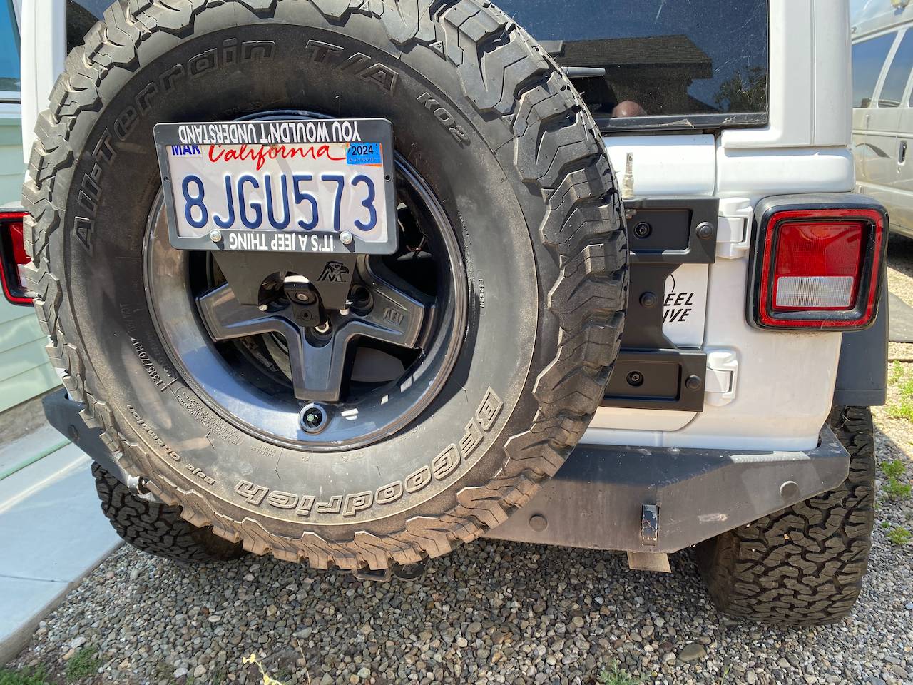

I finally found a Mopar knockoff to my liking and purchased it. https://www.amazon.com/POSENG-Tailgate-Reinforcement-Compatible-2018-2021/dp/B0BBLTZ2MP/ref=sr_1_11_sspa?crid=3GRJ8T9ZT49IG&keywords=oversized+spare+tire+carrier+kit+jeep+wrangler+jl+2018-2021&qid=1689441440&sprefix=spare+tire+carrier+for+wrangler+JL,aps,159&sr=8-11-spons&sp_csd=d2lkZ2V0TmFtZT1zcF9tdGY&psc=1
It was even 20% off when I ordered it $132.97. Shipping time was 4 days, It came nicely packaged with instructions and most importantly all the hardware. The brace is aluminum and light at 11 lbs. I am installing it now(taking a break), it is on the tailgate and fit without issue. I will edit this post with a few pictures later today.
Not much to see. My tire wheel weigh about 97 lbs. + 11 lbs for the brace. The tailgate does not move up or down when leveraged at the handle and I am believing the Mopar techs I talked with at EJS. With a 35" tire, a brace is for the aluminum tailgate and the OEM hinges are fine.

Covered the 4 wheel drive vinyl :facepalm:
I see a lot of guys post about the knockoff reinforcements coming with cheap bolts. What was your experience?
