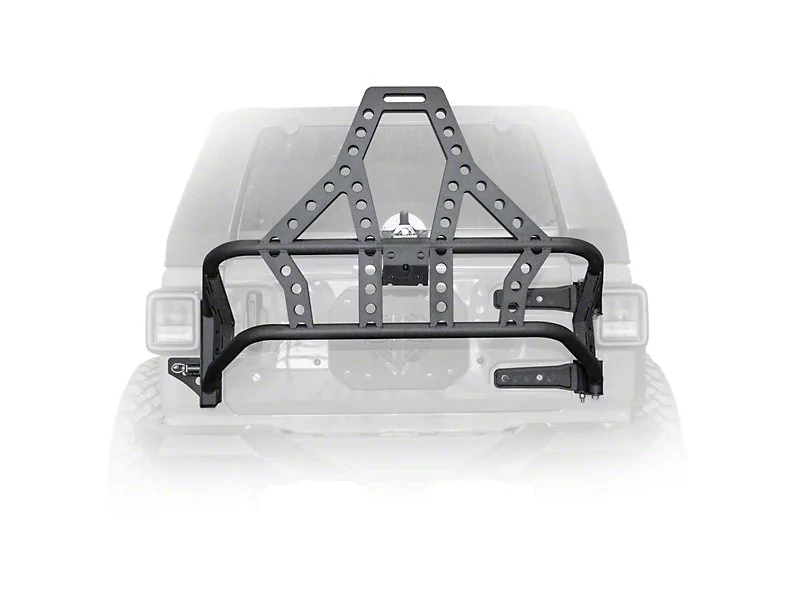

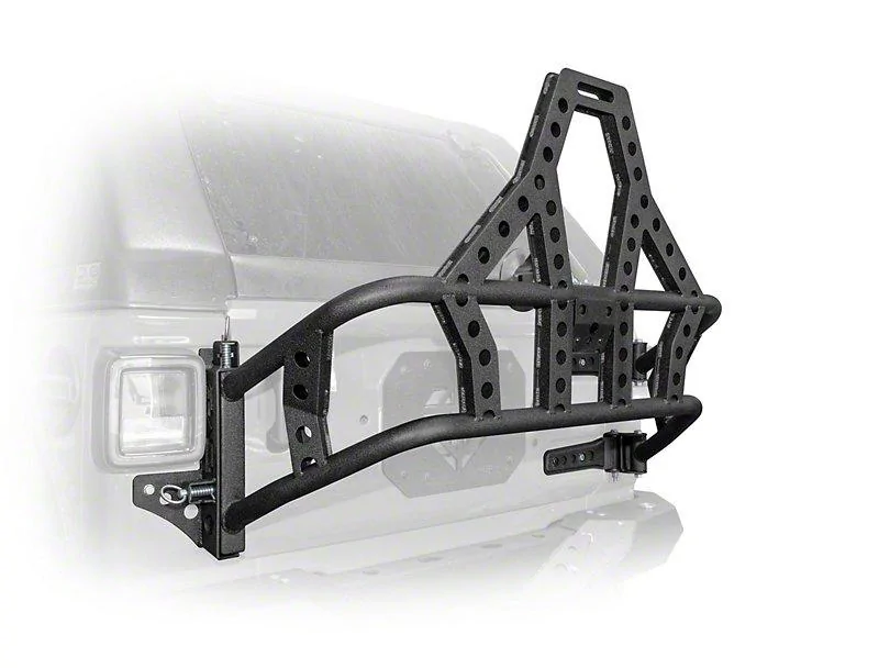

I ordered the new DV8 body mounted tire carrier. Supposedly not shipping until mid January.
I liked the look of their previous tire carrier for the JK, so I decided to run with this one. It's a little gaudy. But it should look really nice with a fastback soft top, which I am waiting on to be released.

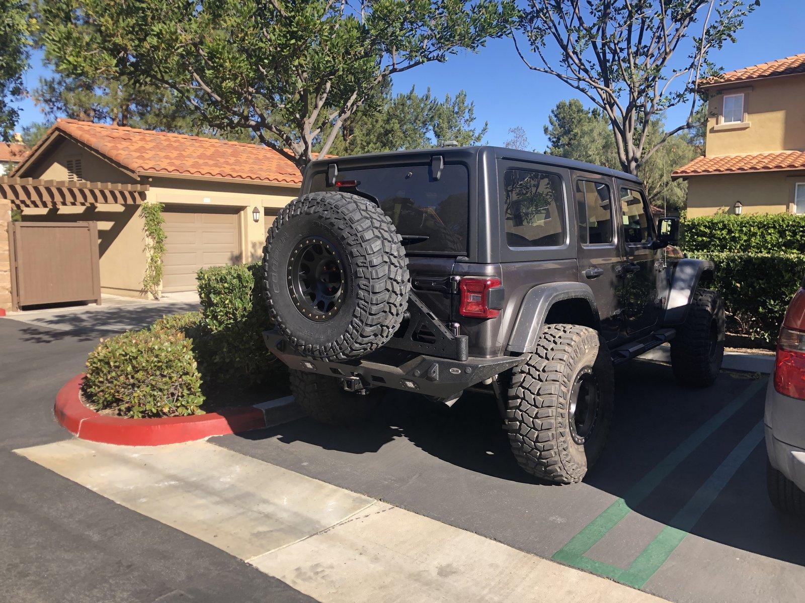

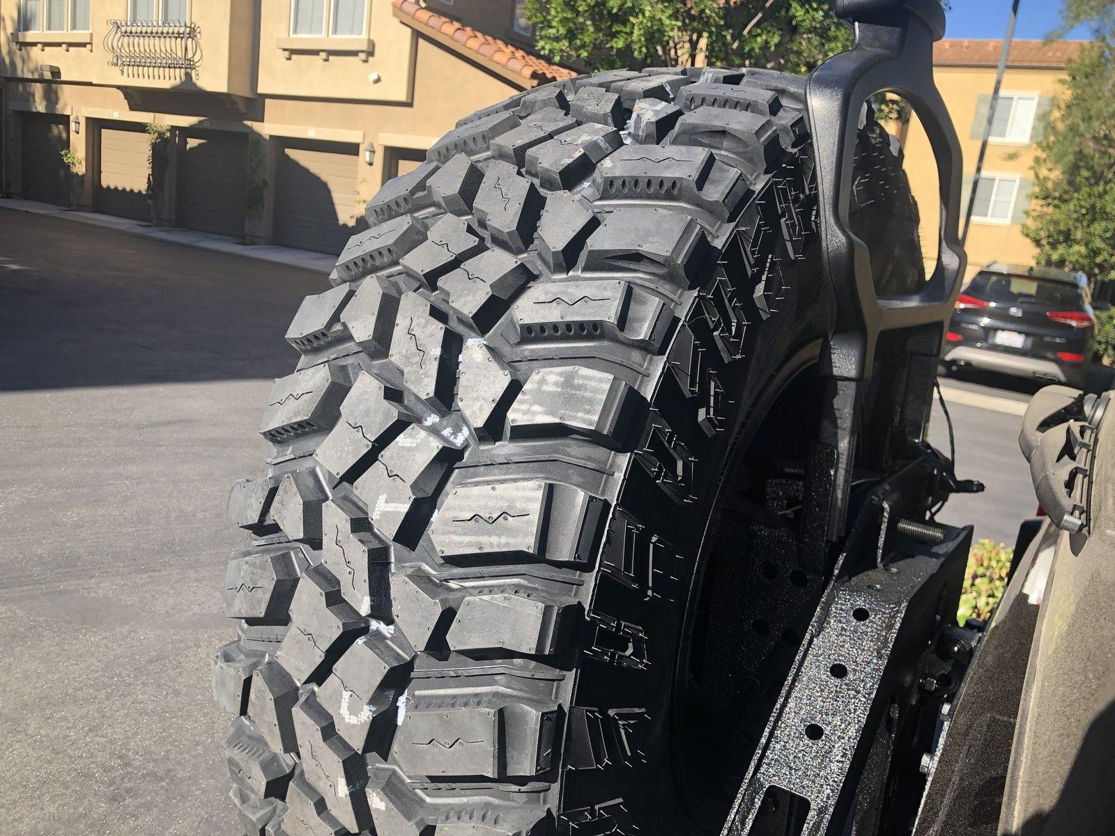

DV8 RBJL-01 bumper with DV8 TCJL-06 bumper mounted tire carrier.
Finally got the tire carrier installed since I wasn’t going to put that heavy 37 on my tail gate.
First off I have to commend DV8 on the tire carrier build quality, everything is solid and lined up with ease.
Second DV8 why don’t you provide instructions????
Here are my recommendations to anyone who installs this. There are some pretty decent You Tube videos out there from other brands that will give you a good starting point. Take some of them with a grain of salt because this tire carrier still has its own quirks. For example, the spacing for the Heim joints you need to fill the gap with washers, and there’s no jam nut for the adjuster, my solution was to use the wing nuts as jam nuts since they fit perfect. There are 2 bolts on the back side of the tire carrier, I’ll assume that’s for a hi lift style jack and the wing nuts are for them.
I’d also recommend placing the plastic washers that come off the factory mounting bolts for the tire carrier and place them on the opposite side of the steel plate that mounts to the door between the paint and the new plate. The factory CHMSL lines up well but I had to slightly re route the wire to get that extra inch to fit the grommet back in the factory hole, zero wires cut here. The camera hole is so far away from the camera it greatly reduces the usable visibility, I’ll be modifying this as soon as I get a bigger step drill bit. I haven’t seen anyone else with this installed yet. Best of luck on your install if you got one.
