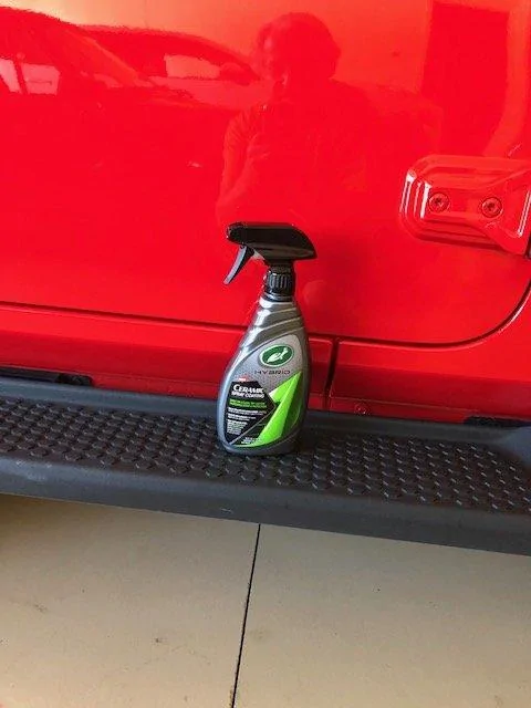

    So I have been using the Turtle wax Ice for awhile but just changed to this one
    It's amazing you can actually see myself in the door

    Good to know. Where did get it?

    Amazon I think it was 16.00

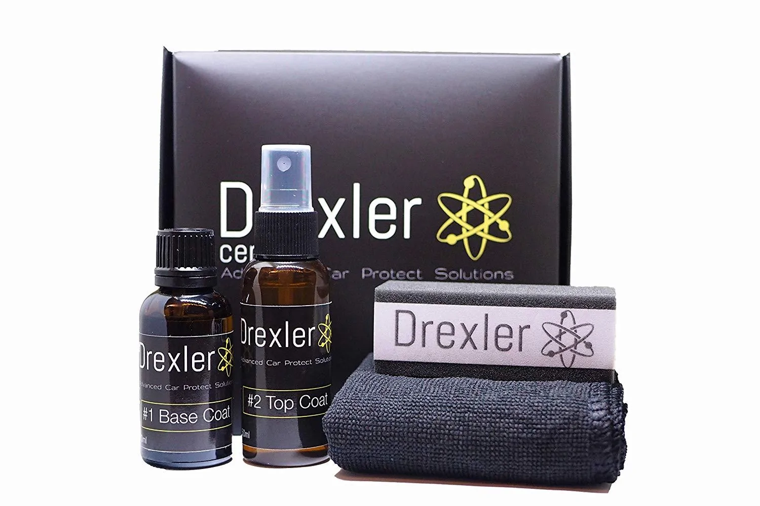

    Have you used this Drexler brand or is this just an example? I'd love to save the $1200 or what not on coating. Seems like less work than a good wax job (although you need to do that prior of course).

    I know you were asking DonBindas but I'll chime in. I have not used the Drexler brand. I typically use CarPro products unless someone request different. The ceramic coating process is not incredibly difficult. You need to make sure it is spread evenly and allowed to cure or flash for the proper amount of time. The tricky part is determining the right amount of time and making sure you get all excess material wiped off. If it is left on the paint too long you'll most likely have to compound it off.
    The time consuming process with ceramic coating is the prep time. In order for the coating to bond properly the paint needs to be free of any contaminates or previous waxes/sealants. For best performance the paint should be washed with a decon wash, clay barred, and preferably polished. After that and before applying the coating all surfaces need to be wiped down with a coating prep. You can make your own using diluted IPA/rubbing alcohol. You want to cut it to about 25-30%.

    Back to the original post, if you just want a good sealant or spray coating the Turtle wax products are pretty good. For the price the spray coating or the Seal n Shine will give you several months of protection and water behavior is very similar to an actual coating. Prep work isn't as important and they are really quick and easy to apply. You can even do the fenders and hard top. It'll darken up the black and keep it from fading.

    I totally agree with SilverRubi
    The reason I posted a picture of Drexler is that I tried the cheaper stuff and it was a BIG mistake.
    The nice thing about ceramic is that is eliminates the static cling that you get with wax, dirt often washes off without scrubbing, and it is 30% harder than the factory clear coat finish.
    Even so, don't count on it to defend you against scratches.
