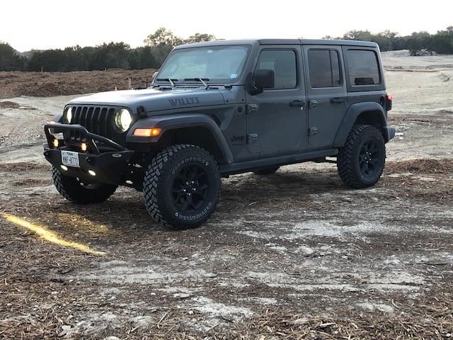

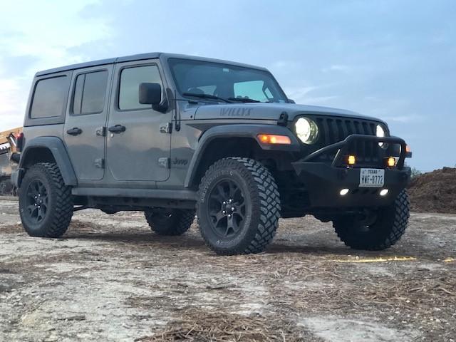

I was trying to find a decent Low CG (2" or less) lift with a multi rate spring a good shock package for my wifes daily 2020 JLU Willy's. I decided that I will wait and build my own adjustable link arms etc once I source a spring and shock that I like. I had followed the thread that @Rubi VT had started on this exact same idea, and realized that there are not many "kits" that provide this.
In the meantime, we were still playing on weekends and dragging skid plates and gas tanks...lol
I decided to throw a Teraflex 1.5 Performance Spacer Lift on until we go a different direction. Took 2+ hours and some beer.
Super easy install, everything fits as it should, rides identical to stock and added 2" up front and 1.5 out back.
No need for bump stop changes, as I did not change tire size and can still stuff them to the bump. You will hit full droop quicker in the stroke (you are 2" closer to being topped out on the shock) when you are articulating the suspension off-road, but nothing that will prevent you from playing.
This is what it looks like..

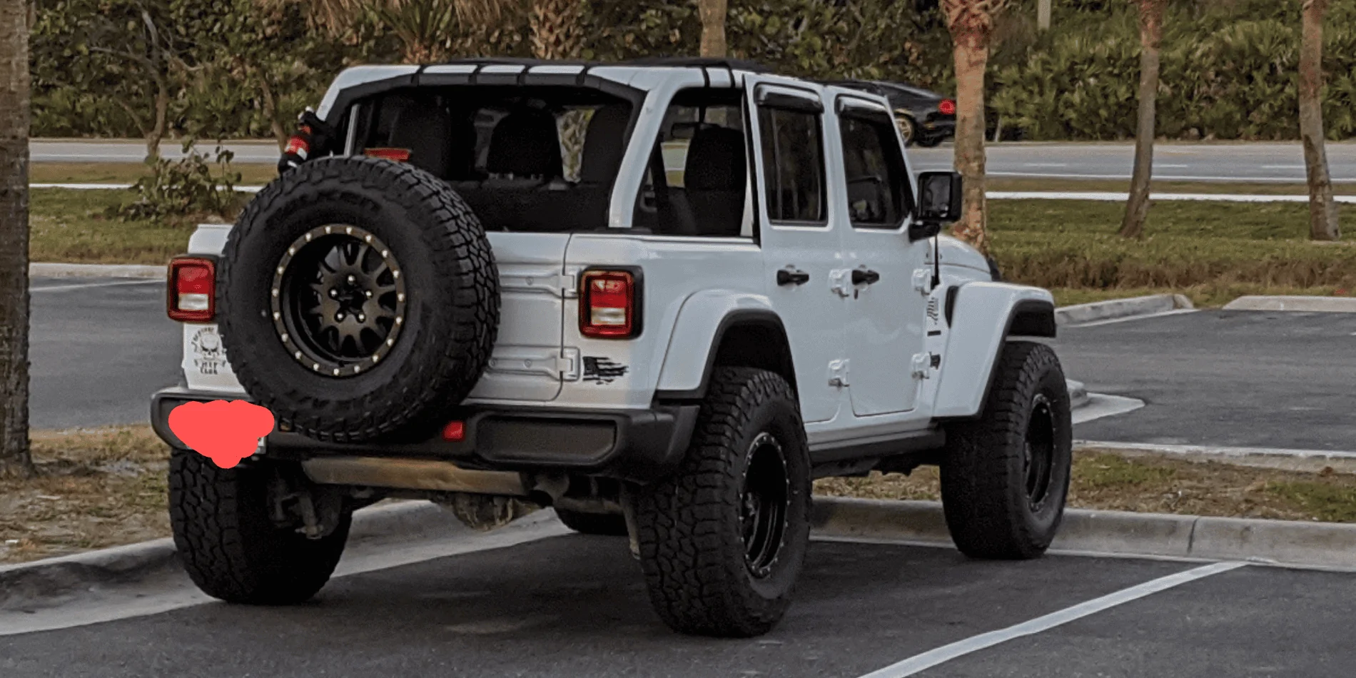

I have the same lift, and recently went to 35" tires. I went ahead and installed longer bump stops in the rear, but left the front as is. Still haven't had an opportunity to see what happens when it's fully flexed..

Any reason you didn’t put the bump stops in when you did the lift? What’s the benefit?
Canuck714
Canuck714
Zach
Dec 17, 2019
50
2013 JKU Rubicon, 2014 Roush Raptor, 2020 JLU Willy's
I did not need to limit the up travel. I did not have any rub with stock tires before, so it wont rub until I go to a bigger tire.
