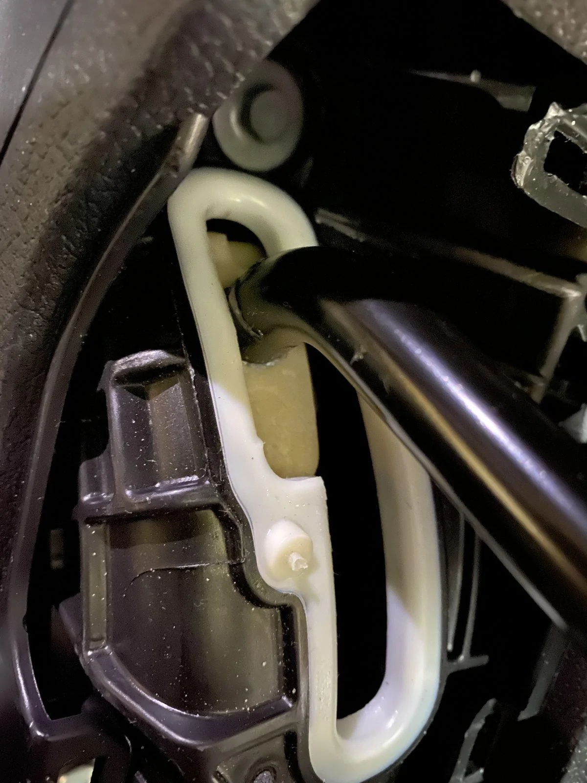

Yes im having the same issue with 20 gladiator. Pops out of 4lo constantly. So i looked at the cable linkage under the center console and there is a 14 mm bolt that sits in a adjustment channel i guess that can be slid back and forth. So i loosened the bolt and slid the channel all the way forward and buttoned everything back together. Now it works like a charm! It really snaps into 4lo and locks there! Problem solved!

I had this happen to me 2 times the first outing with my 2020 JLUR. It didn't happen last outing. I hope it doesn't become an issue as we have lots of shelf roads here and it's a long, steep way to the bottom. Is it that larger bolt in the picture that got adjusted?

Pull the console out and go to the drivers seat. Just beneath the silver transfer case linkage is the nut that rides in the slot Abrice37 described.
Jeep Wrangler JL Teansfer Case cable adjustment 1595131495076

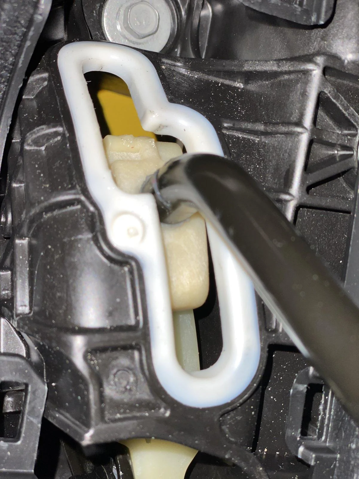

The first time I opened it up the nut was all the way to the right in the slot. I moved it all the way to the left which gave me a positive shift into 4-Lo but it started popping out of 4-Hi... =/
The second time loosened the nut, then pulled the transfer case into 4-Hi by the linkage. Then I stuck the dental pick into the track between the lever and the white track to give it a little slop. The pick is about 1/16th of an inch so tip of a screw driver or a tooth pick would probably work too. Pick not inserted in this picture but I put it in right under the bend in the shift lever.
Jeep Wrangler JL Teansfer Case cable adjustment 1595131688017
