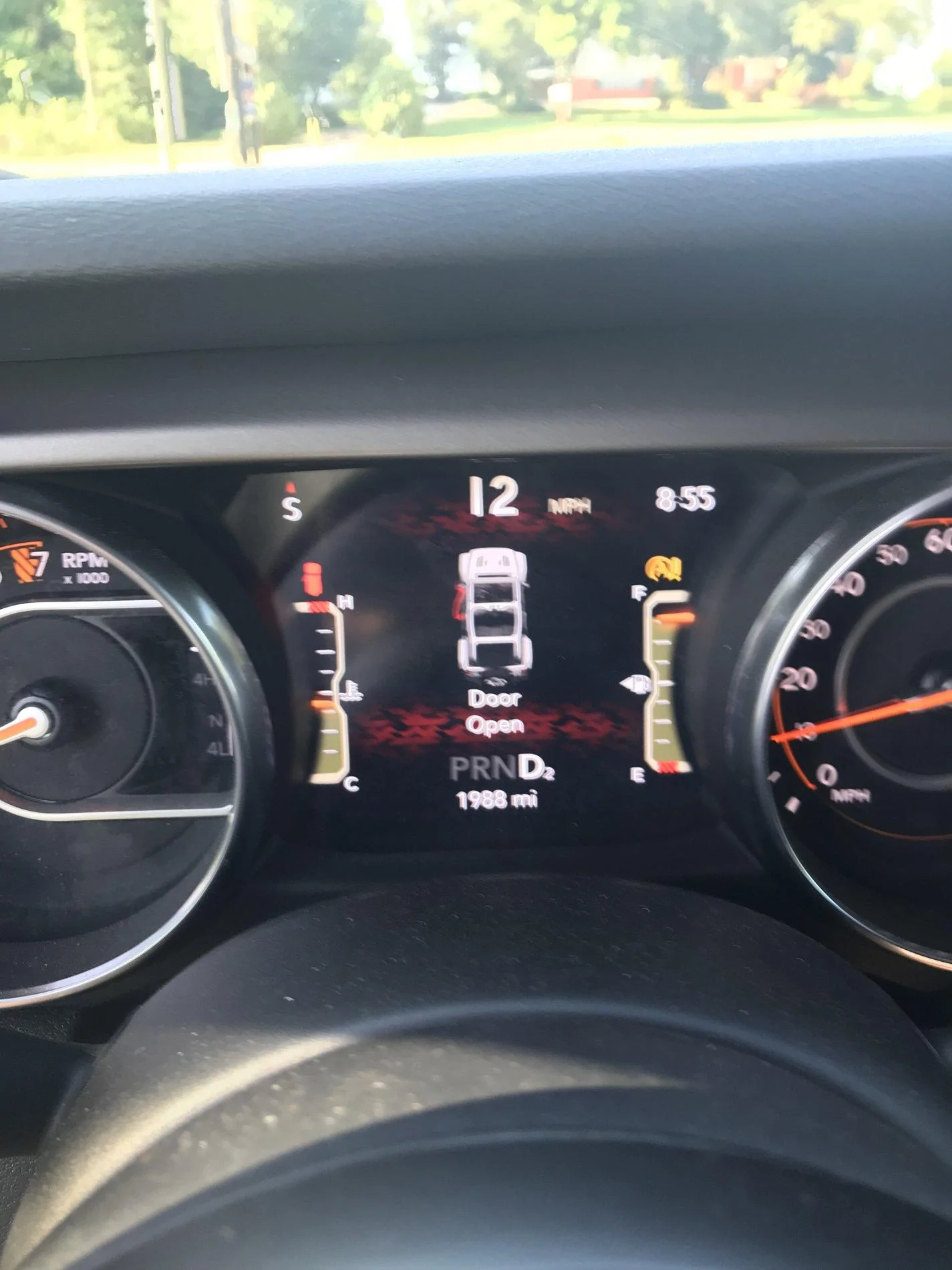

I haven’t played with it very much due to weather and my wife driving the Jeep. Last night I updated it and was able to disable autopark. For the small amount of time I tried it, I could back up with the door open. It was going in for cruise control fix today so it is not married right now. I will play around some more this weekend with the other features and see if there are any bugs with my Sport and make sure the autopark disable is still working properly with other features turned on and programmed.

So I played more this morning and didn’t have any issues autobpak not being disabled - forward or reverse. Of course I didn’t try opening my doors at height speed but at speeds below 10mph I could open my door while moving without engaging auto park. I did take some videos with my phone but can’t post them directly to the site so I will have to find another way.
Tire size adjustment is in 1/4” but is fairly simple - I used the OEM diameter first and was off about 2mph, than I measured the actual diameter with my current air pressure and hot tires and it was pretty much dead on. I turned down TPMS and turned off for off road. I have my hood sensor unplugged to disable ESS so that was never an issue. With that being said I am very happy with the Superchips and can’t wait till the tuning update comes out along with trailcal and or traildash.
