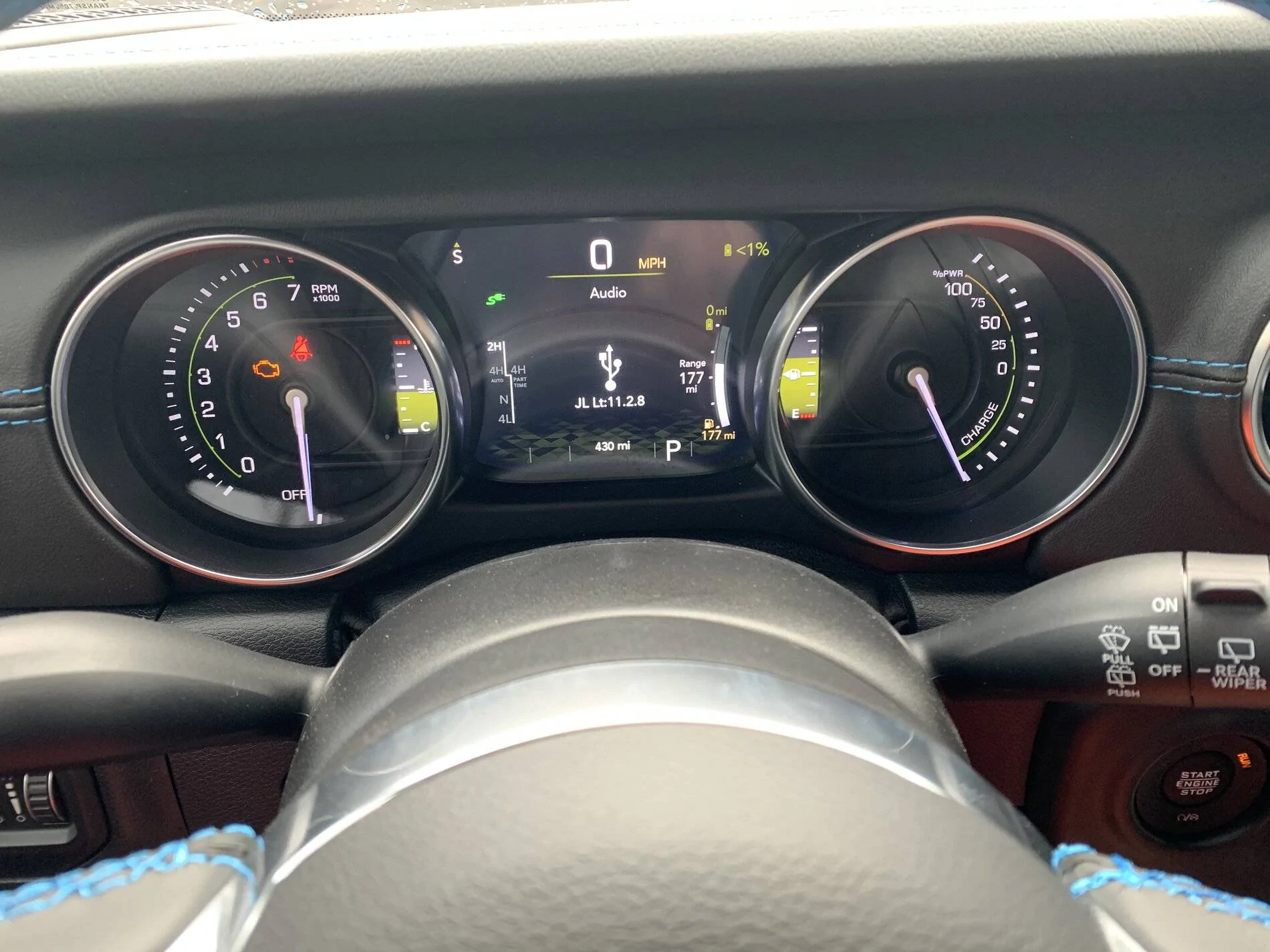

Anyone having issues not getting access to full menus?
I am only seeing a handful of options and submenus both when the vehicle is not running and when it is running (using the 3 tap method for the 4xe).
Wondering if I am just doing something wrong, or if maybe my "Tazer JL Mini" is actually a "Tazer JL Mini Lite" and not fully activated? I do not see an activation code in my email or on my order slip to activate, but I did notice that the EVIC display includes "LT" in the version info for Tazer

What is the best way to tell which version I actually have? My receipt and box indicate "PALJL-TAZER-MINI" and the price was $329.00 minus a 10% discount from their site sale.
What has me thrown off is seeing the "LT" in the version info screen for my Tazer menu, and the fact that I am only seeing a handful of options.

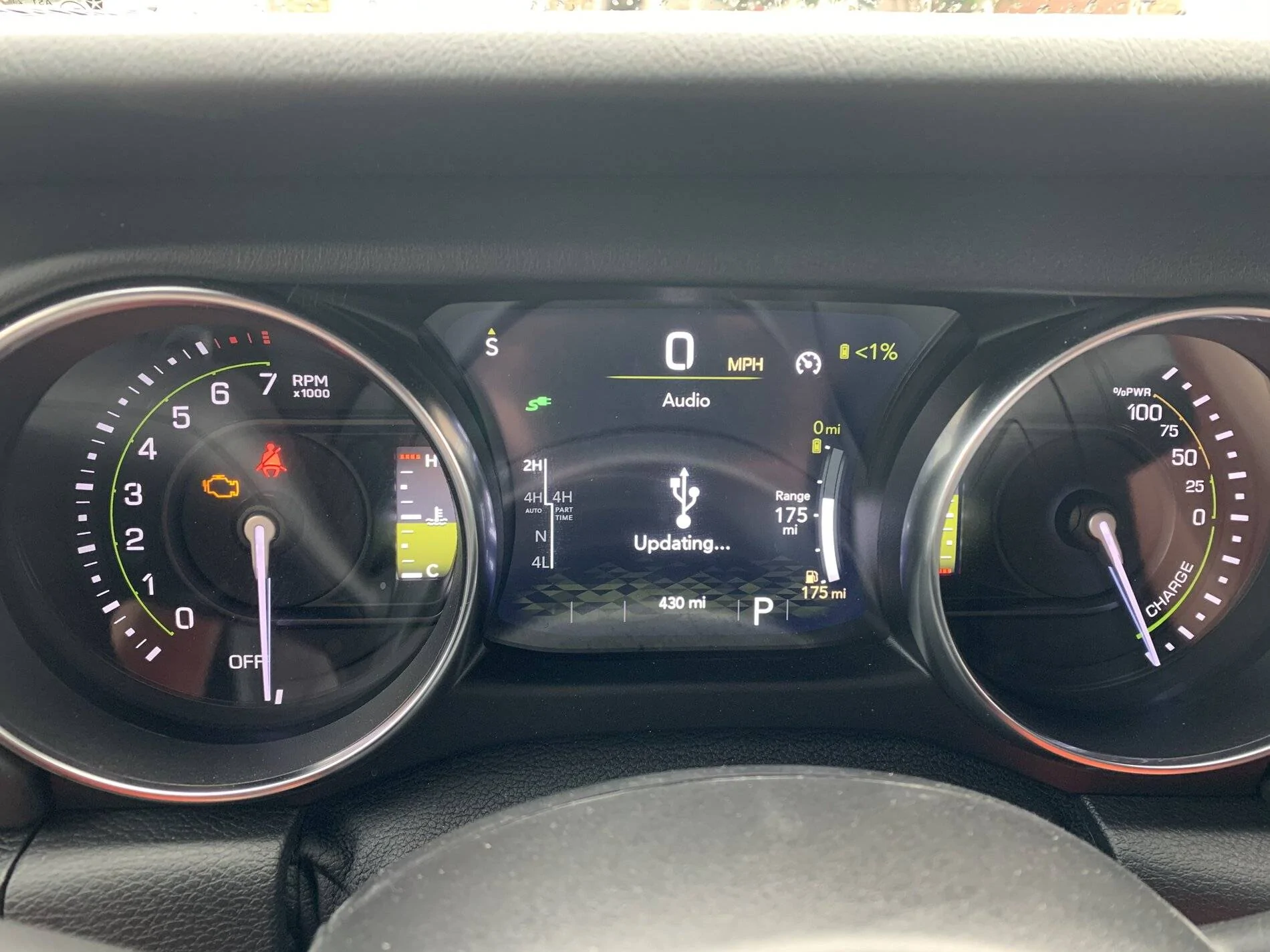

I also Jeep getting an “Updating...” message that pops up occasionally on my EVIC while in the Tazer menu (nothing on my UConnect display though). I’ve let it sit for a while but nothing ever completed.
Photos attached, appreciate any help I can get!

I believe you’ve been sent a Lite. On mine it says TZ JL followed by my firmware version 11.2.8
That’s normal. It’s just the Tazer communicating with the vehicle.
