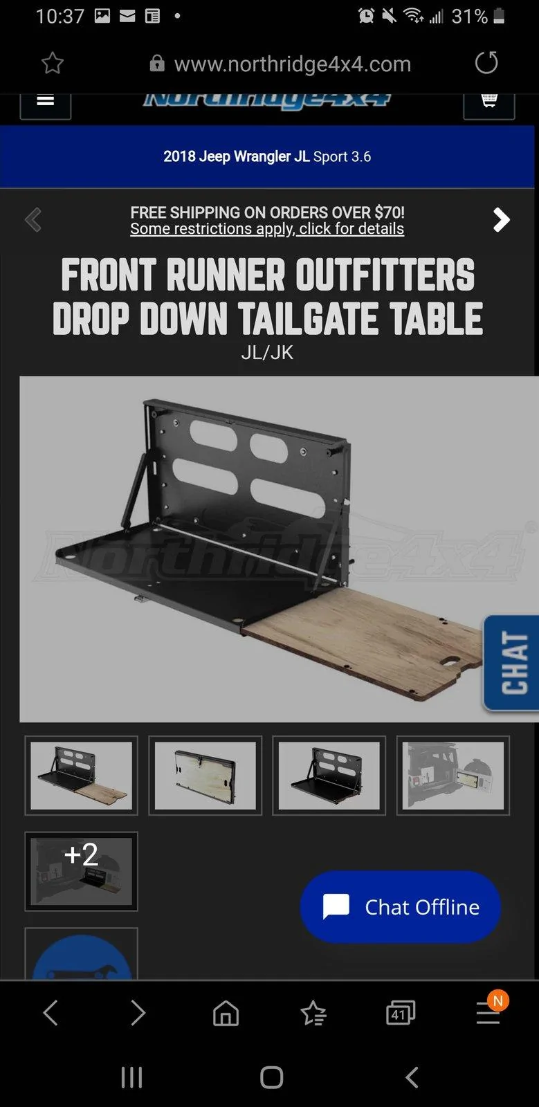

Anybody have this? I've been looking for a tailgate table and the Outback is nice but pricey. I found this online and it looks good. Was wondering if I'd have to drill any holes and what the reviews are for this.

Thanks, I've seen a few of these too.
do you have the url for that product? Never mind I found it here.
https://www.northridge4x4.com/part/...epfaskLEDN3HPdAk8V6IPYcmRN4hjC3xoCMyYQAvD_BwE
i found these both of which I know have been used by overlanders constantly and each with good features.
https://outbackadventureproducts.com/product/jl-trailgater-for-2018-wrangler-jl/
I have reached out to this site to see if he has started fabricating for jl products as one over lander uses this table practically everyday without fail for over 2 years now

I just installed this table Friday. Goes in easy using. Four 10mm holes drilled into the black plastic on the tailgate plus spacers and bolts. Quick install and so far has worked well.

The price is good, I'm just trying to find a code but that item is excluded from any discounts on the northridge4x4 website. Just tried the Father's Day code this morning too.

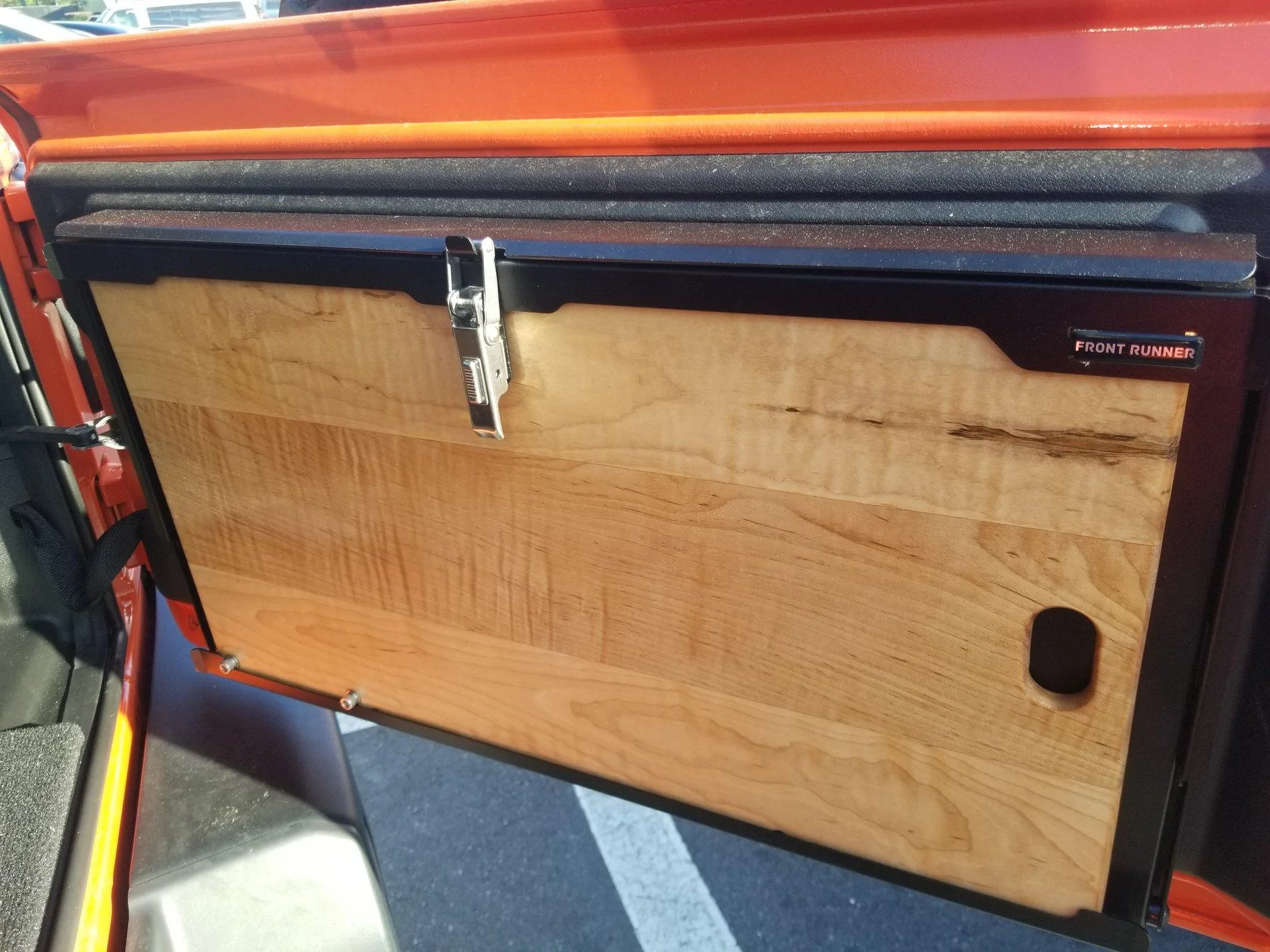

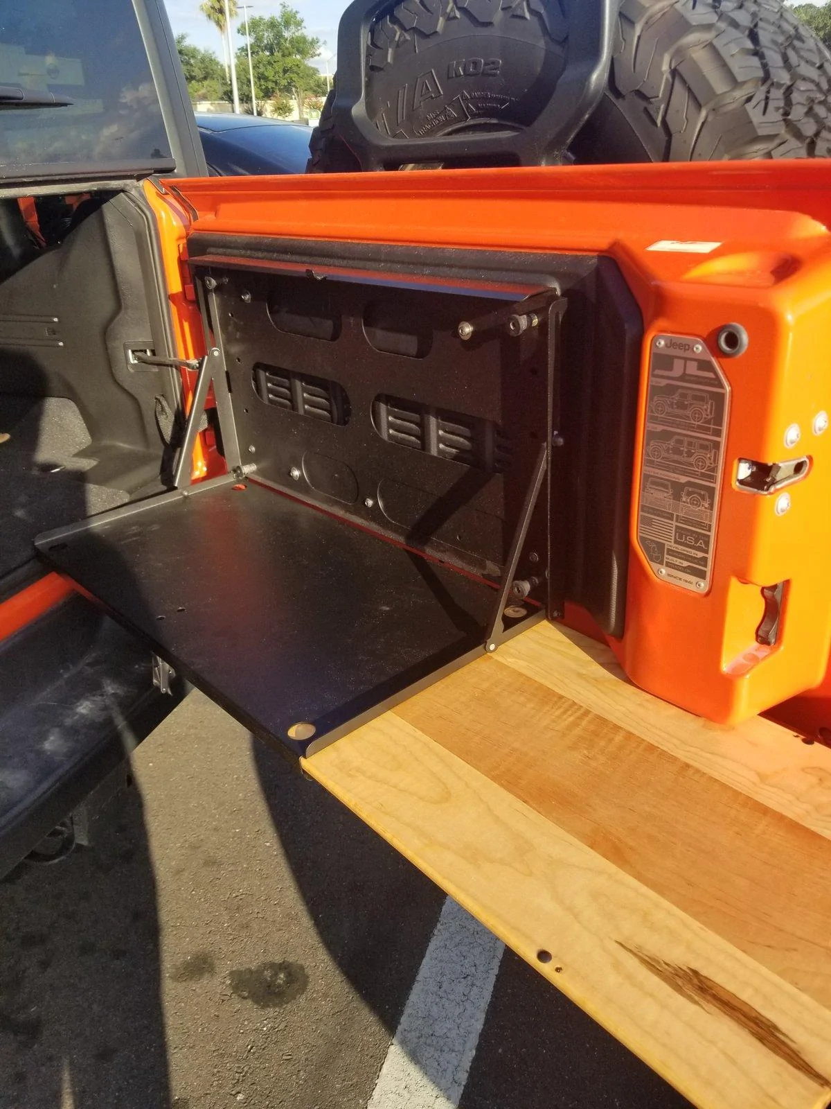

I have the Front Runner and it works well.
You may have to drill out one of the alignment holes on the bottom as both of mine (one on a Sport and another on my rubi) refused to line up.
The board it comes with has been complete crap on both of my orders. Unfinished, rough wood I wouldn't begin to consider for prep work. So, I'd plan on making your own. Maple or Cherry would work well.
The table itself is great and sturdy once installed. It doesn't rattle at all.
Attached a few photos.

Agreed with one hole misaligned. For me it was the bottom left but just need to widen it so the bolt will fit straight. The wood is fine for me. I'll probably just stain and seal it but it works for my needs.
Other than that the build of it is solid. The rails have solid action as well as the latch. And no rattles whatsoever which was one of my big requirements.

I have front runner too. Had to widen a few of the slots to get it to fit. Table came with ugly gouge. They gave me a little credit and my wife sanded and varnished it. Overall love it
