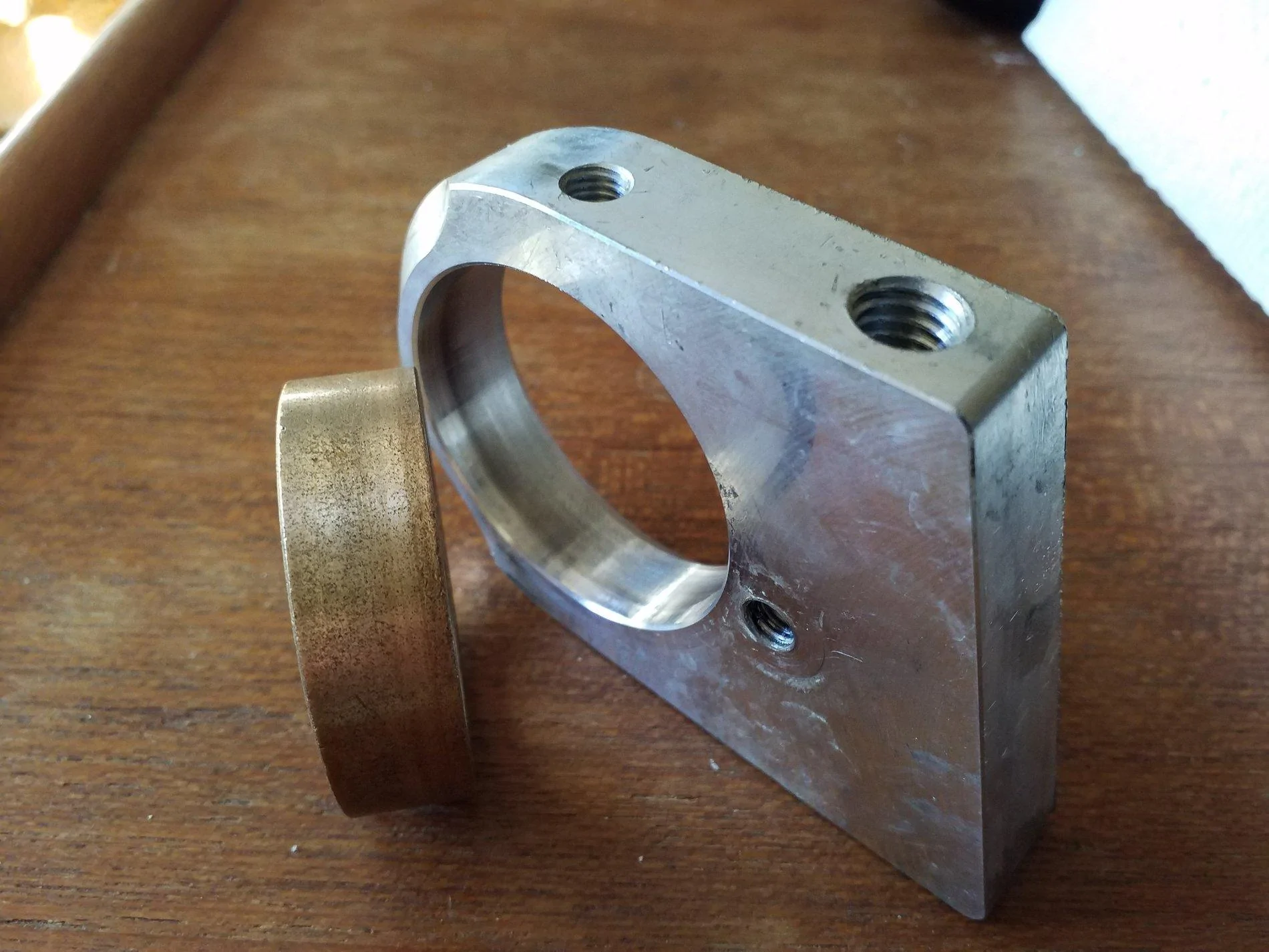

A few appropriate four letter words, a floor jack, jack stand, and a little bit of heat from a torch and the back allen head screw came out.
You can see the hole is about 3/8" out of alignment.
I don't see the bushing lasting long without seals. But hey, I didn't notice this support doing anything for my steering either.
Drilling rather than pressing out and back in.
Yours looks like it may have rotated after install sad thing is none of us know since we didn’t expect to do engineering and quality control of our purchased product. Maybe we should see if these have a QC stamp as if that would do any good. :)

The job just got more complicated. The bushing seemed like it had moved in depth from when I installed it. I distinctly remember it being right against the little retaining screw head. But it was setting much deeper. I decided to push it out and found it shows signs of rotating in the pillow block bore and on the O.D. of the bushing.
The bushing appears to be oilite, a porous, oil impregnated cast bronze. I'm soaking it in acetone and have my wife picking up some red loctite to lock it in. Did I say I hated aftermarket stuff?
This size of bushing needs about .003" press fit to hold something with a load like this. When I pressed it out, it felt like .0005" or less. But of course it has rotated.

Almost no chance. The bushing is about 1/8 wall. Needle bearings like they put on the JK version are low load bearings. They have line contact and require very high quality finish and high hardness on the mating surface. Actually a bushing is best. It just needs protection from the elements (seals).

I'm almost there.
Thinking about this some more, the pitman arm/steering box can generate over a thousand pounds of force, maybe two. That means the tires banging into rocks with the weight of the jeep can generate similar force or more back into the pitman arm. Those two little 1/4" tabs that hold the aluminum pillow block/bushing can't support that. Why'd I buy this thing?
I totally agree. mine was tight but not enough to trust it won’t spin as it should have seals and if anything they could have put a locking screw to hold bearing in place. i will say if it is out of place in the near future it will be time to drop in trash, grind off ears, paint, call it a day, and a lesson learned.
