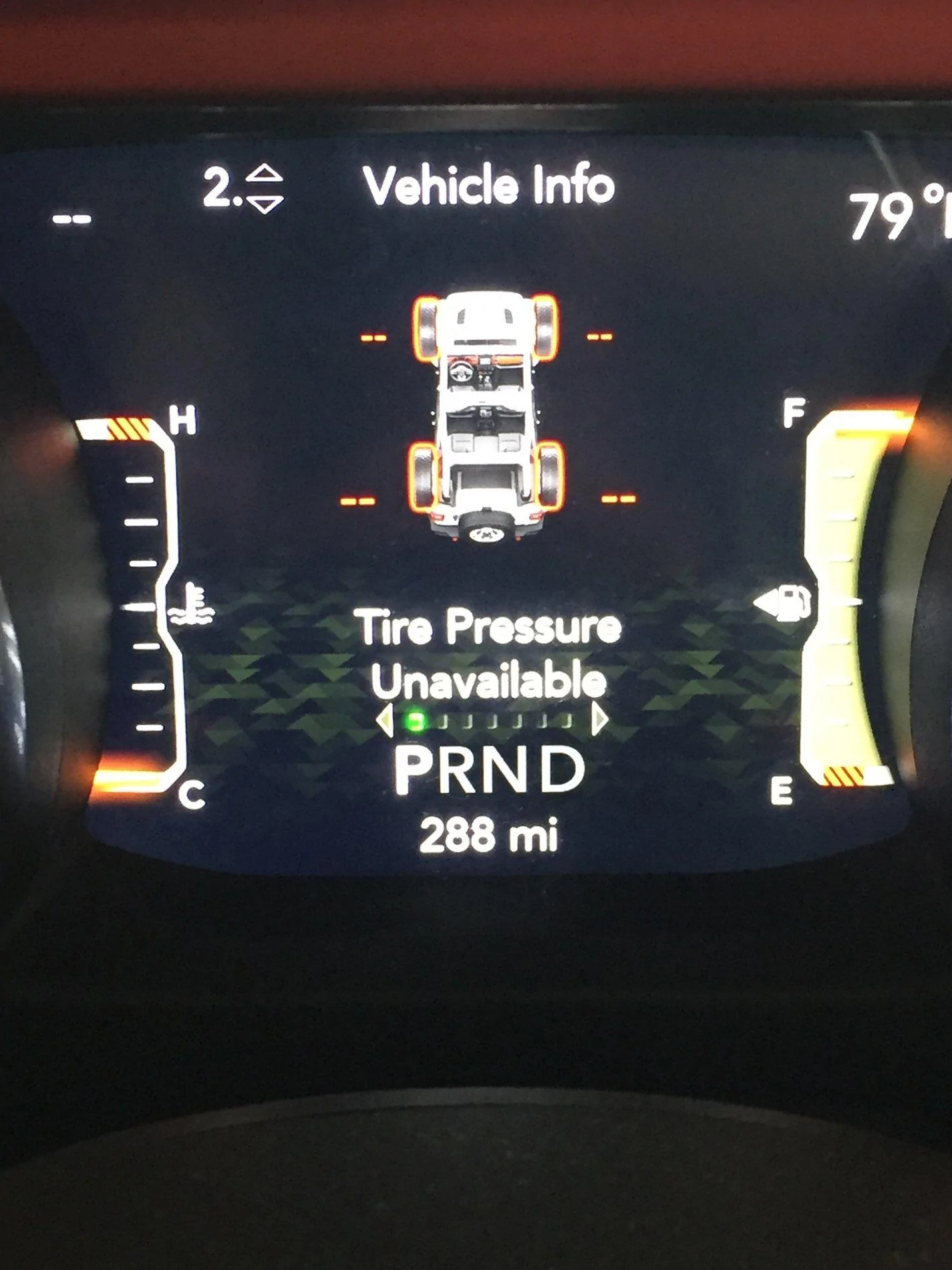

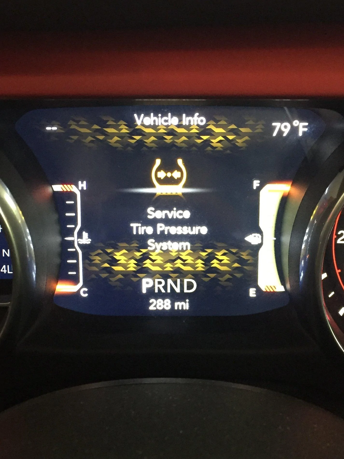

Thanks for the reply, I called the other day and could not resolve anything. They seem to think it's with the vehicle rather than the tuner. Here are the two "warnings" instill get.
I don't get why I'm seeing anything IF they are turned off?!?
Thanks, were you provided with a case number when you called in?
Can you tell me if you were seeing these errors prior to using the flashcal?
No, Warning light came back on as well. I re flashed again to turn tpms off, said they already were, erased DTC alerts, and the problem remains.
I'll be breaking down my factory tires and using those tpms, and returning the Superchip since it cannot fully turn the tpms off:

OK, I want to make sure I fully understand though. Are you running without sensors currently?
I currently have sensors in aftermarket Hostile wheels.
For the first 75 miles or so, they worked fine with no codes or errors.
I had already ordered the Flashcal prior to adjust for speedometer, and other things.
When the codes showed up, I thought no biggie, I'll just turn the tpms off, and so I did with the Flashcal. The error codes I posted above remained, and the tpms sensor light (the little tire looking thing) went away, until we drove the Jeep again, and then it came on again.
I used the Flashcal to repeat the process, and it says the tpms are already turned off, yet all the error codes light remain.
OK, we're going to look into this and see if there's a way to kill all the lights.
