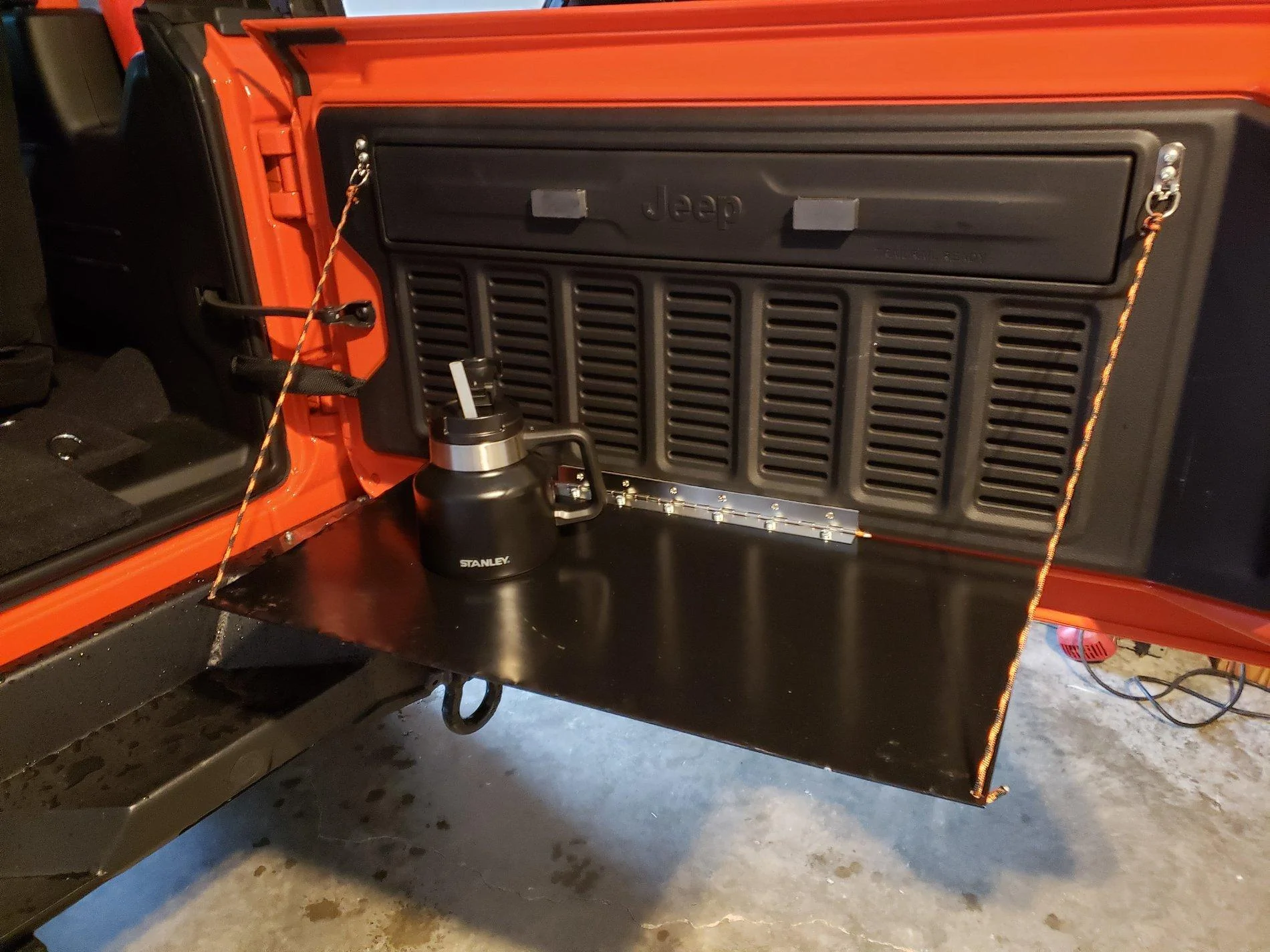

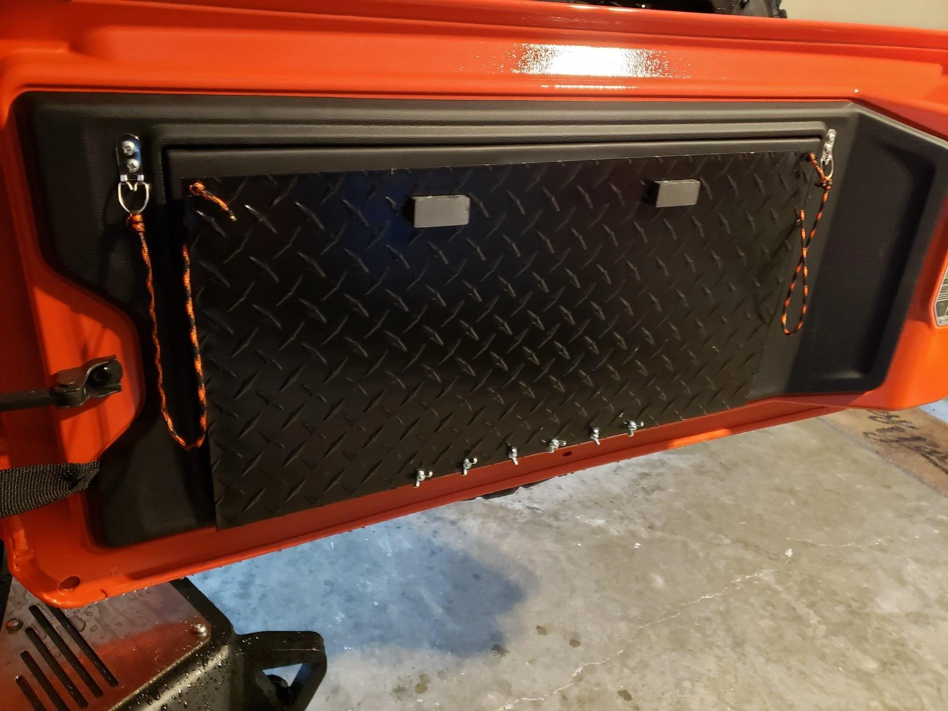

Half hour project for a tailgate table on my JL. Small aluminium plate, piano hinge, a bit of hardware including a few magnets and some paracord. Holds our drinks and a dinner plate or two. Have not put any more weight on it, but we will see how it does in the future. Have $35 into it, and most of the was for the aluminium plate. Could not be happier.
