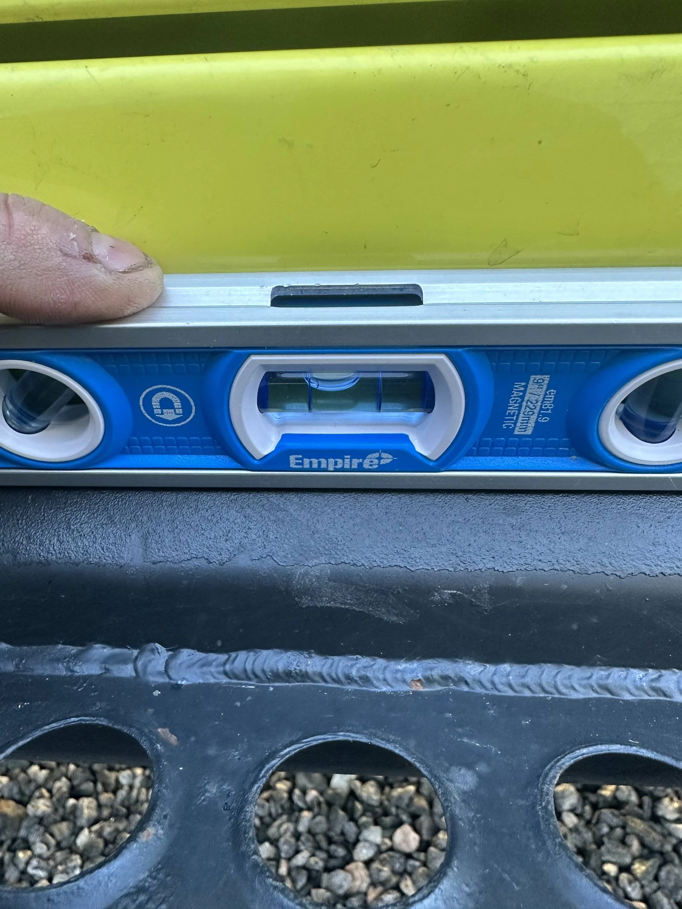

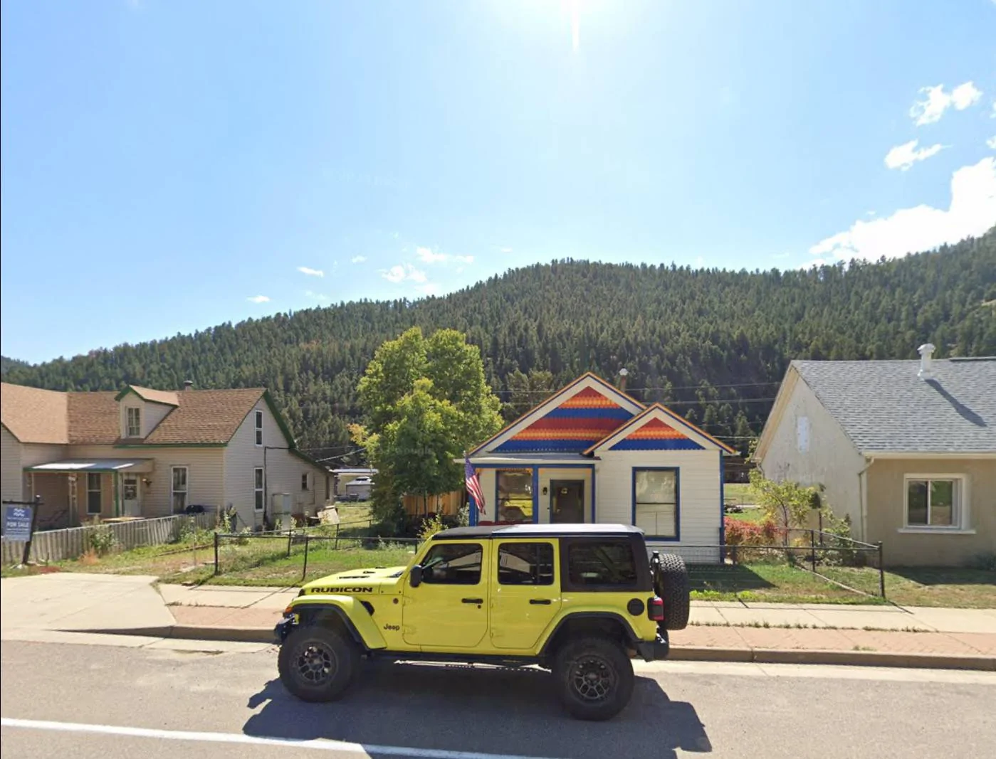

Jeep Wrangler JL Suggestions for leveling out IMG_2316
Jeep Wrangler JL Suggestions for leveling out IMG_5447
