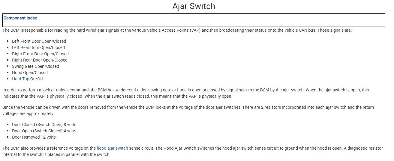

On the 4XE I found that if I idle too long, the Jeep completely turns off and sometimes I want it to stay on.
I read somewhere that if the doors are removed, the 4XE will not auto turn off.

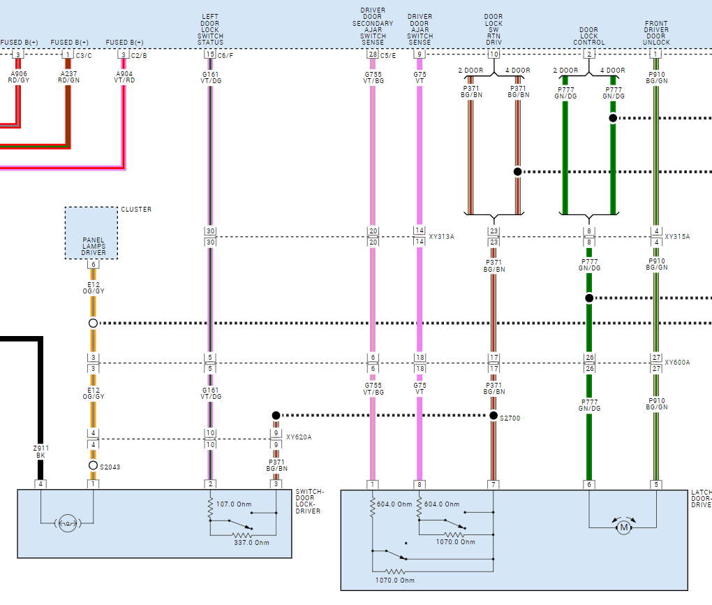

Im thinking that if I can wire in a double pole single throw switch (or relay) to break the connection on the wires associated with pins 17 & 18 on the door harness I should be able to stop it from auto shutting off by flipping a switch.
Has anyone tried something like this? Would pins 17 & 18 be enough? Would doing one door be good enough? Or would I need to do both?

I don't see on the diagram where Ajar sense is going to get 12V if the door is umplugged (XY600A unplugged). As is described in the narrative. Looks more like it would see nothing.

The thought is if the door is removed, all the circuits are open. If I put the correct wires on a switch or relay, I can mimic the door being removed.

Yes, understood.
If you look at pin 17, "door lock switch return driver" it's in both your lock switch circuit and the door ajar switch circuit. That splice is inside the door. If you switch that before the splice, you loose your door lock switch. Looks like the door lock switch is voltage monitored like the ajar switch.
Specifically in the driver door, there is redundant ajar switch sense on pins on pins 6 and 18. (Single ajar circuits on the passenger and rear.
One challenge in deciphering is that all of these circuits come from the BCM, they aren't necessarily B+ to ground.
It appears windows are isolated from the BCM, so those may not be impacted. Not sure if you'll lose BSM, the feed for the indicators is coming from the sensors in the tail lights.
I don't have my Jeep with me. Are there any switches in the rear doors? Not showing on the diagram, and those would be the easiest ones to manipulate circuit wise.
