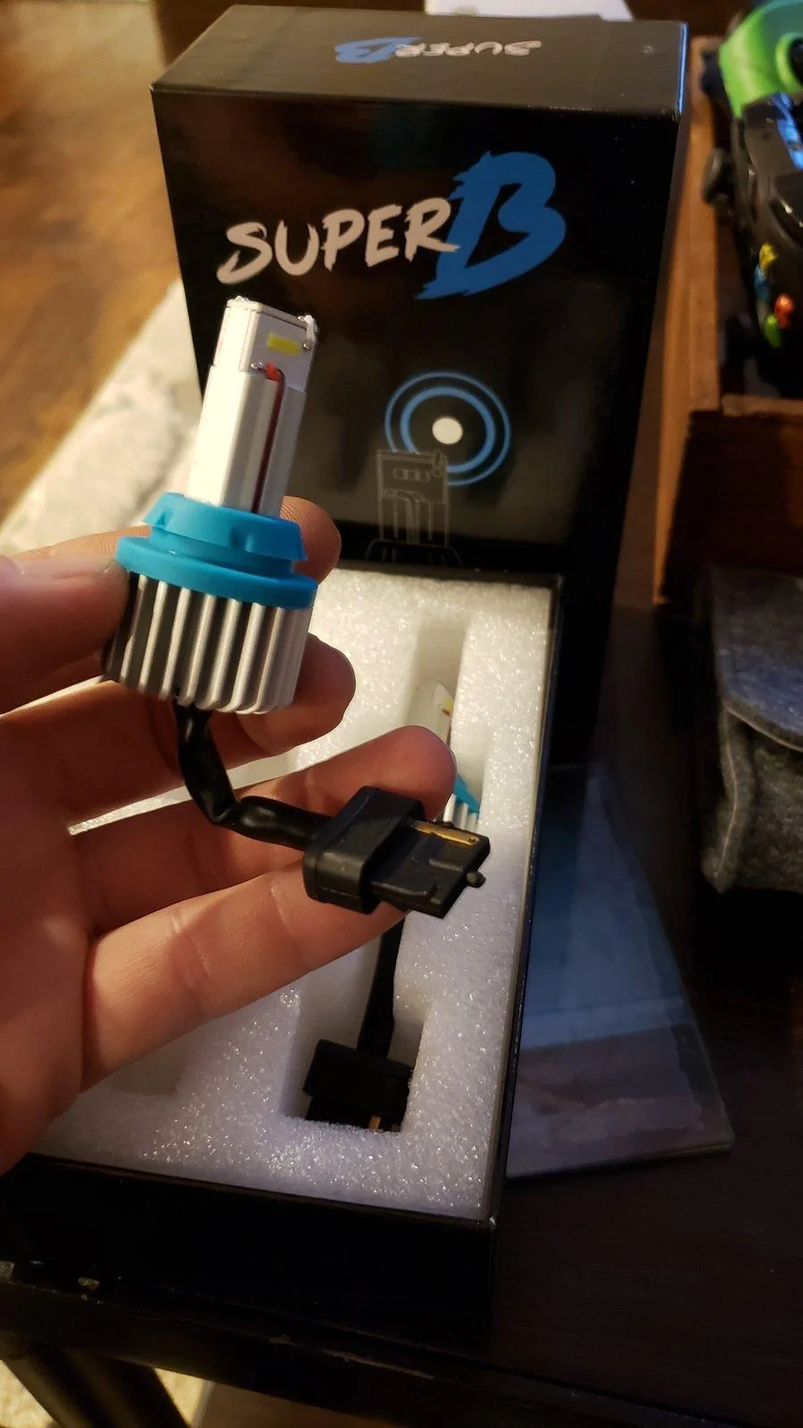

So as most of you know the entire lighting package for Wranglers that do not have factory LED group, well they wack.
Currently I have upgraded all the front end lights, and have been searching for LED reverse light bulb replacement options.
Well, I found them.
https://dieselleds.com/collections/...40-super-b-led-revere-light-kit-2100-lumens-1
One installed vs stock bulb

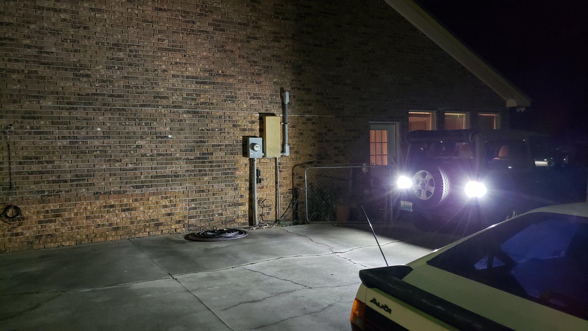

Then I was like let me turn off the flood light

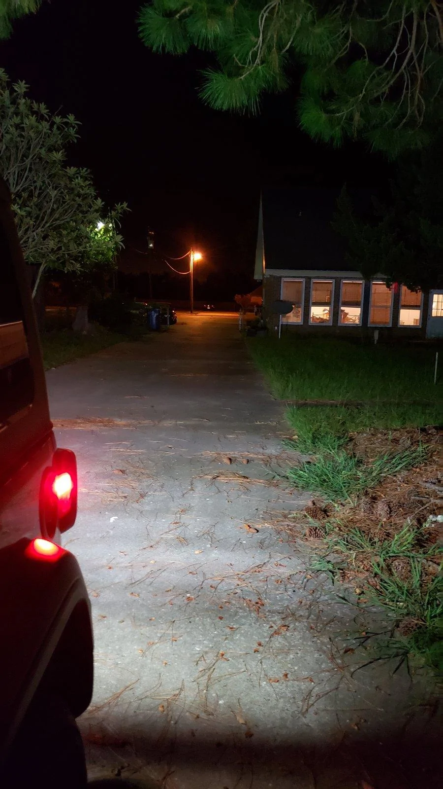

Then I said... Let's back down the driveway

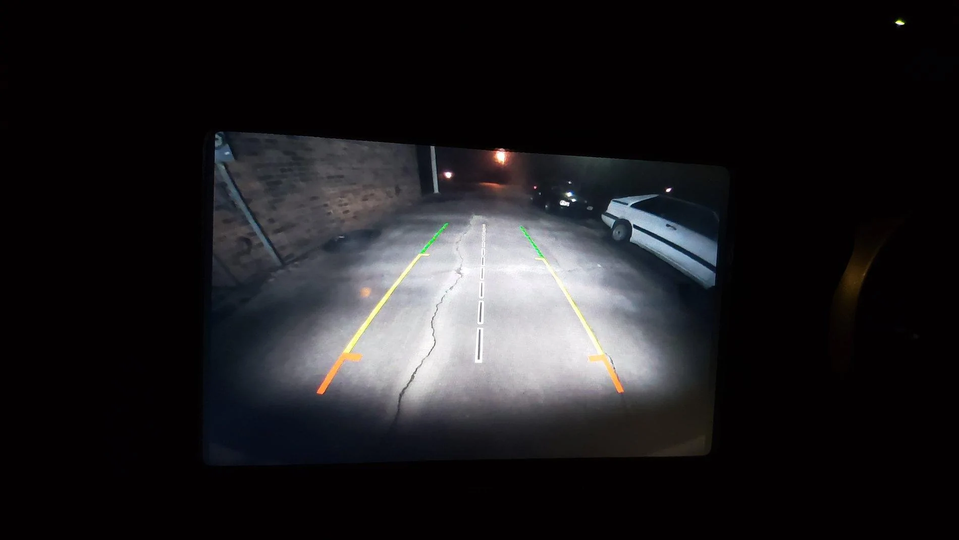

And yes... The reverse camera is actually useable at night now.
