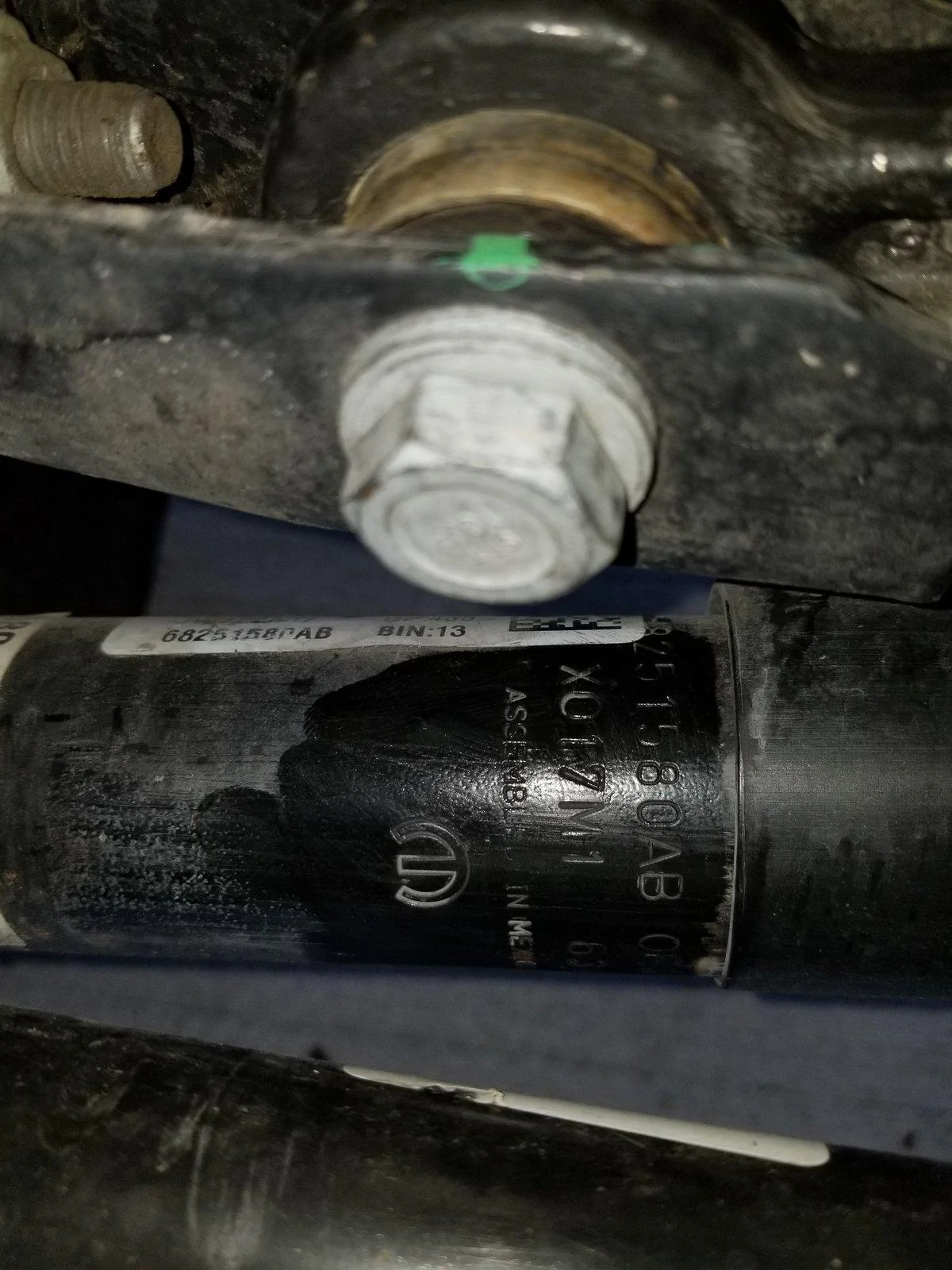

Thanks to all who have contributed to this thread so far. I just experienced true death wobble 4 times yesterday after hitting pot holes or expansion joints at freeway speeds resulting in violent steering wheel shimmy and the entire vehicle shaking until I was able to slow down to under 50 mph. I haven't had a single bit of steering play or shakes before this.
When I was looking underneath yesterday after it first happened, everything looked good. My daughter started turning the steering wheel back and forth while I visually inspected track bar, tie rod, ball joints, and everything looked fine. This morning after reading this thread, my stabilizer with a date code of XO17M1 (well under the 2xx date code) now has damage to the protective sleeve from some sort of impact. I don't remember seeing that yesterday (not saying it wasn't there) and it looks fresh from the picture.
I can only imagine I'll get push back from the dealer due to damage and modifications. I'll update after I get into the dealer and see what they say. I'll make sure to bring up the mentioned case number about the stabilizer build dates, and insist on a full steering inspection. Luckily the first spot this happened is actually on the dealer's normal test drive route.
Info about my Jeep: Sport bought new off the lot in March, 15k miles now, spacer lift with stock arms and track bar installed 12k miles ago, stock wheels, stock 245/75/17 tires at 37 psi, and aftermarket bumper with lower plastic air dam removed.

If the dealer refuses warranty, then it could be the perfect opportunity to get an aftermarket steering stabilizer vs paying for another OEM version. Several people on this forum say the steering is way better with Fox, RC, etc. steering stabilizers than the OEM version anyway.

That's my plan if they refuse. Was hoping to get by until spring to do an actual lift and replace everything under there, but this might force action sooner.

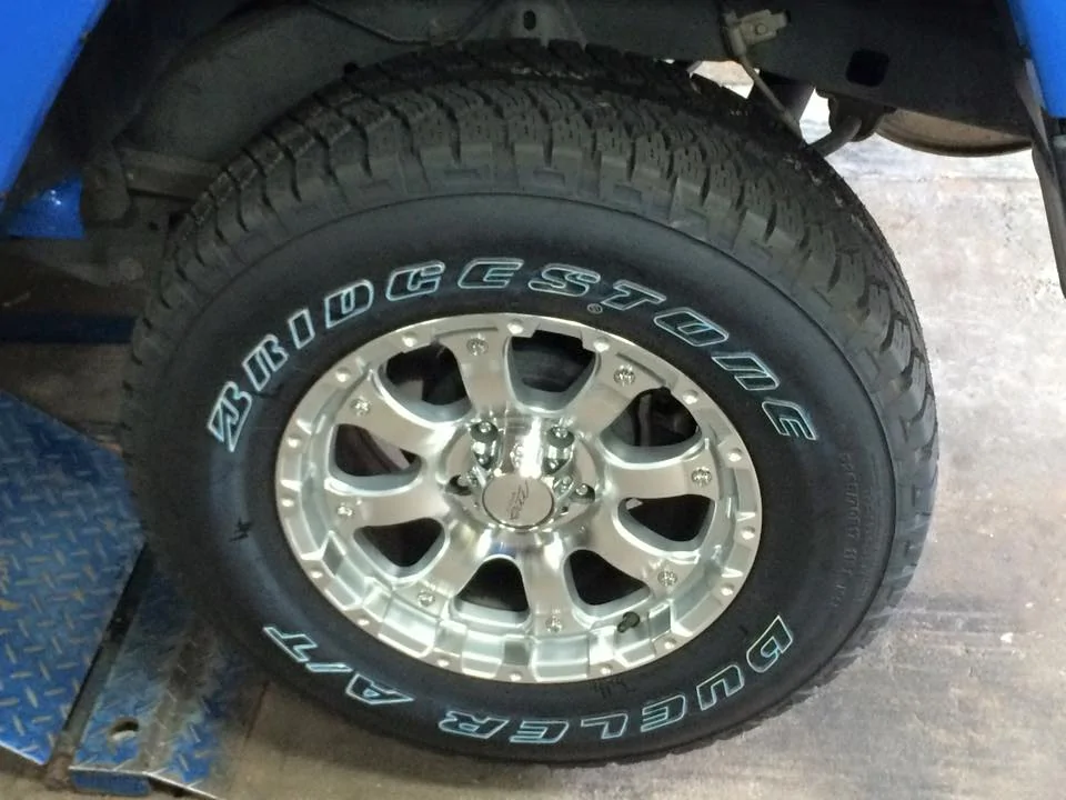

Well I brought my vehicle to the dealership after experiencing this wobble multiple times (the dealership was able to replicate it as well). They are saying the suspension is fine and that it is likely due to it being lifted while still having narrower tires... I have the factory Sport Bridgestone tires along with the Mopar 2" lift which I had installed at a Jeep Dealer... I'm seeing that multiple members on this thread have experienced this issue without a lift so I'm not convinced this is the issue...I've also driven the vehicle for thousands of miles without suspension issues as well which tells me something has changed. The dealership I went to said they had 2 different technicians inspect the suspension however and could not find anything wrong. How much impact would tires have on this issue? I rotate my tires often and make sure to inflate them per spec. The dealer advised they saw cupping of the tires but the wear I observed appears very minimal (I do 5 tire rotations as well).
I checked my steering dampener and found that the number was in the 300s... I got my Jeep in early February but it seems that many members have later build dates but lower numbered stabilizers so I'm not sure how that works.?.?
I'm gonna rotate the tires just for the heck of it to see if it has any impact on the issue once the weather allows. In the meantime if anyone has any ideas or suggestions I'm all ears... I'm just really bummed I'm having this issue.
Thanks all!
This thread might help out - https://www.jlwranglerforums.com/fo...teer-steering-issues-drifting-resolved.17478/
