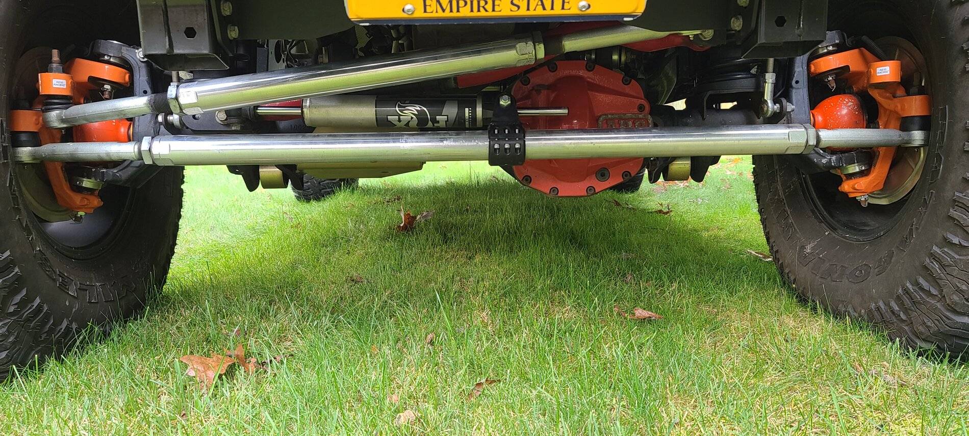

Headbarcode
Aug 16, 2018
5,515
12,097
LI, New York
2019 JLUR Stingray 2.0 turbo
I've been a fan of the through shaft types of stabilizers. I have a Fox TS on the Jeep and an adjustable teraflex one that is new in the box that I got on a trade. Both of them hold position anywhere along the length of their stroke. A proper stabilizer shouldn't extend on its own.
