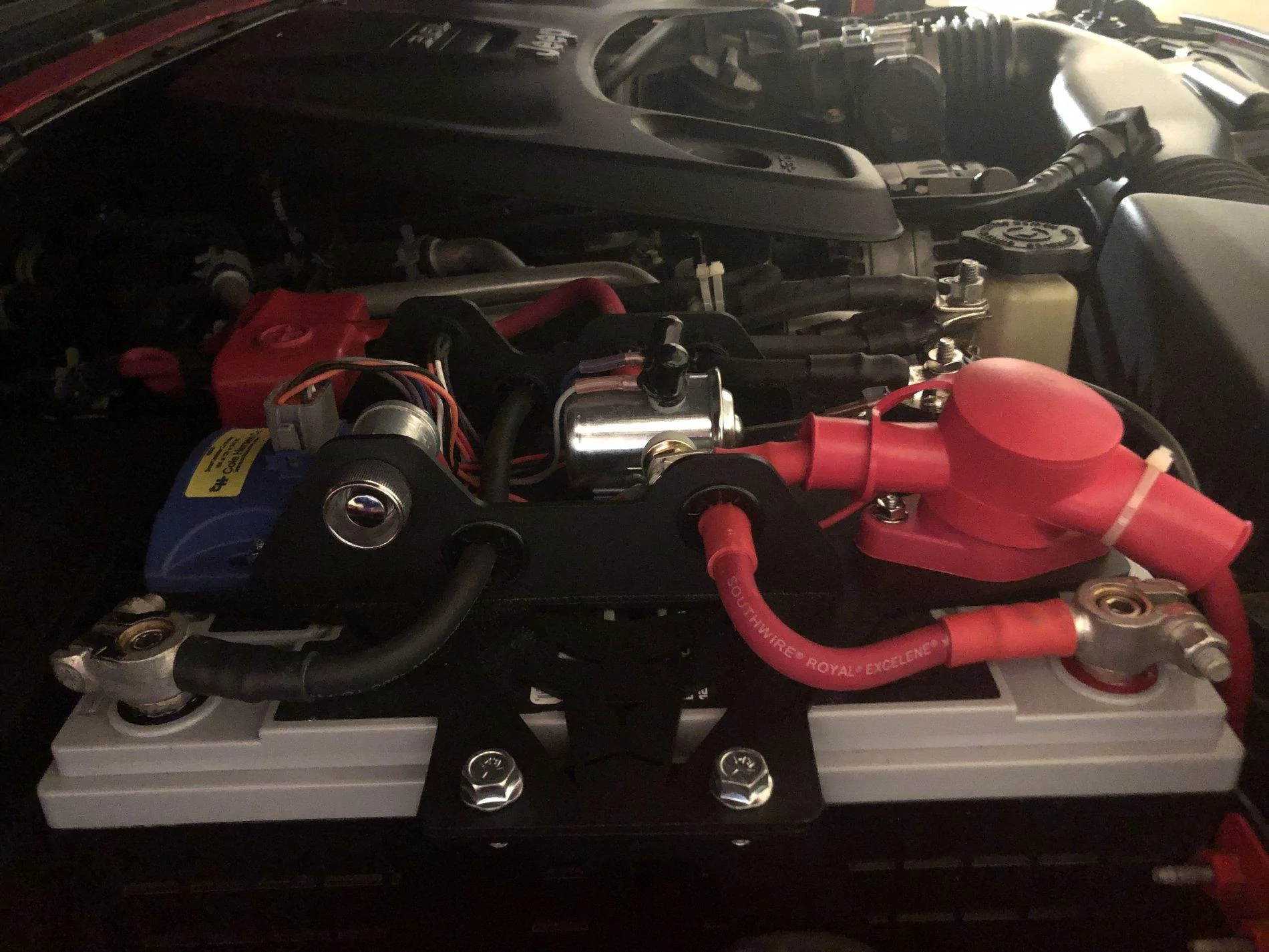

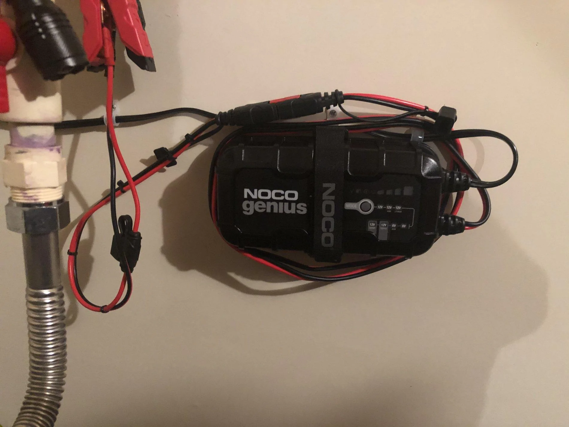

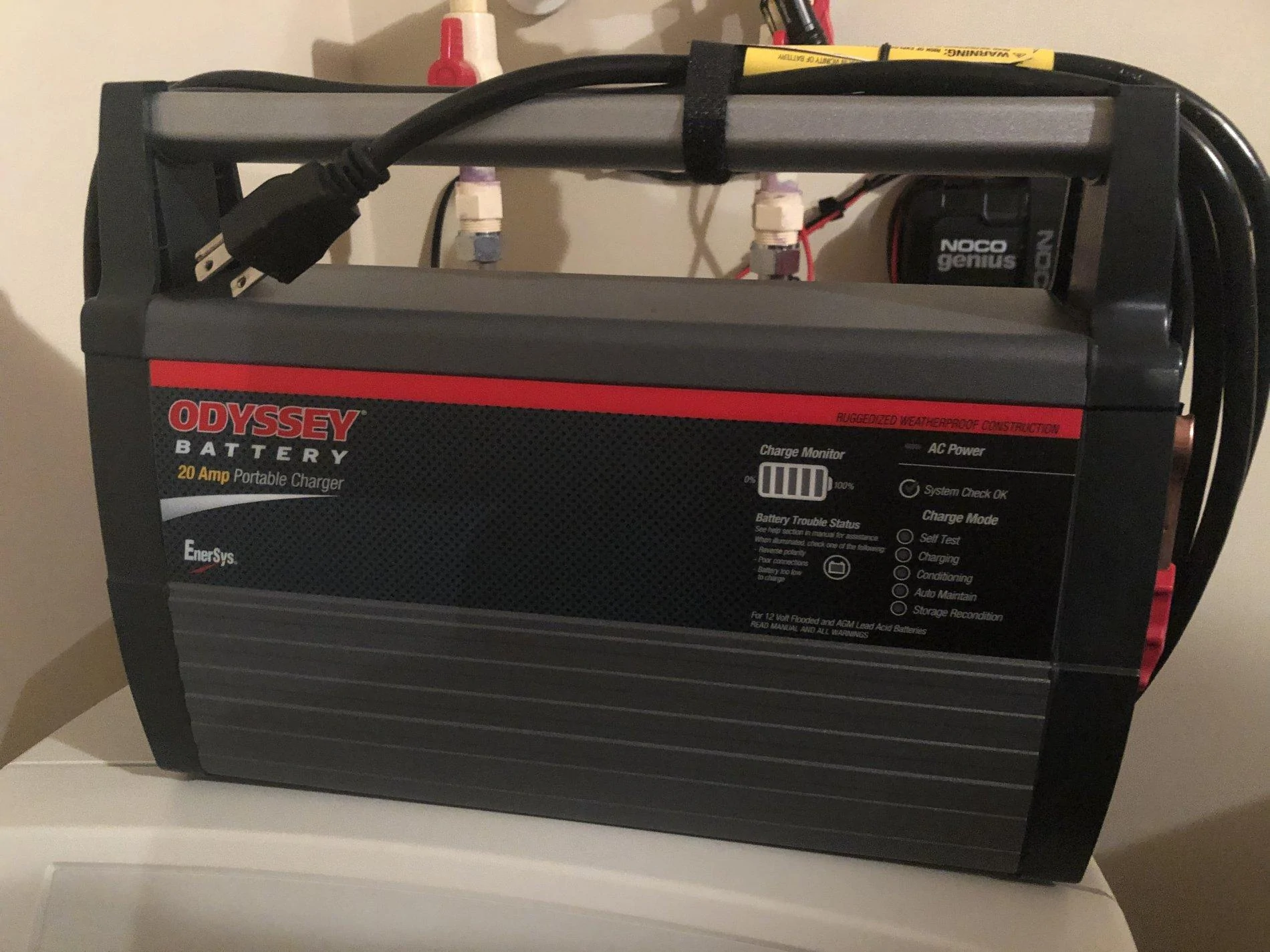

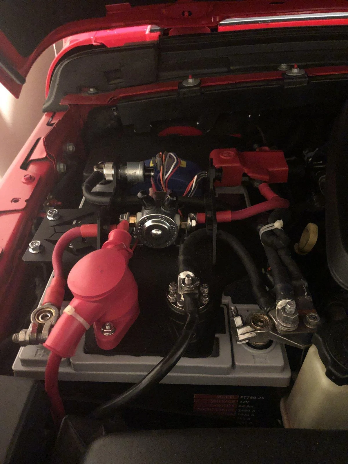

Buy once cry once and be done, this will solve all your power needs, not necessary but I use a NOCO 10 for weekly topoffs and then break out the big guns for a monthly recondition using the Odyssey and running two full size batteries will give you all the power you need to run pretty much anything
