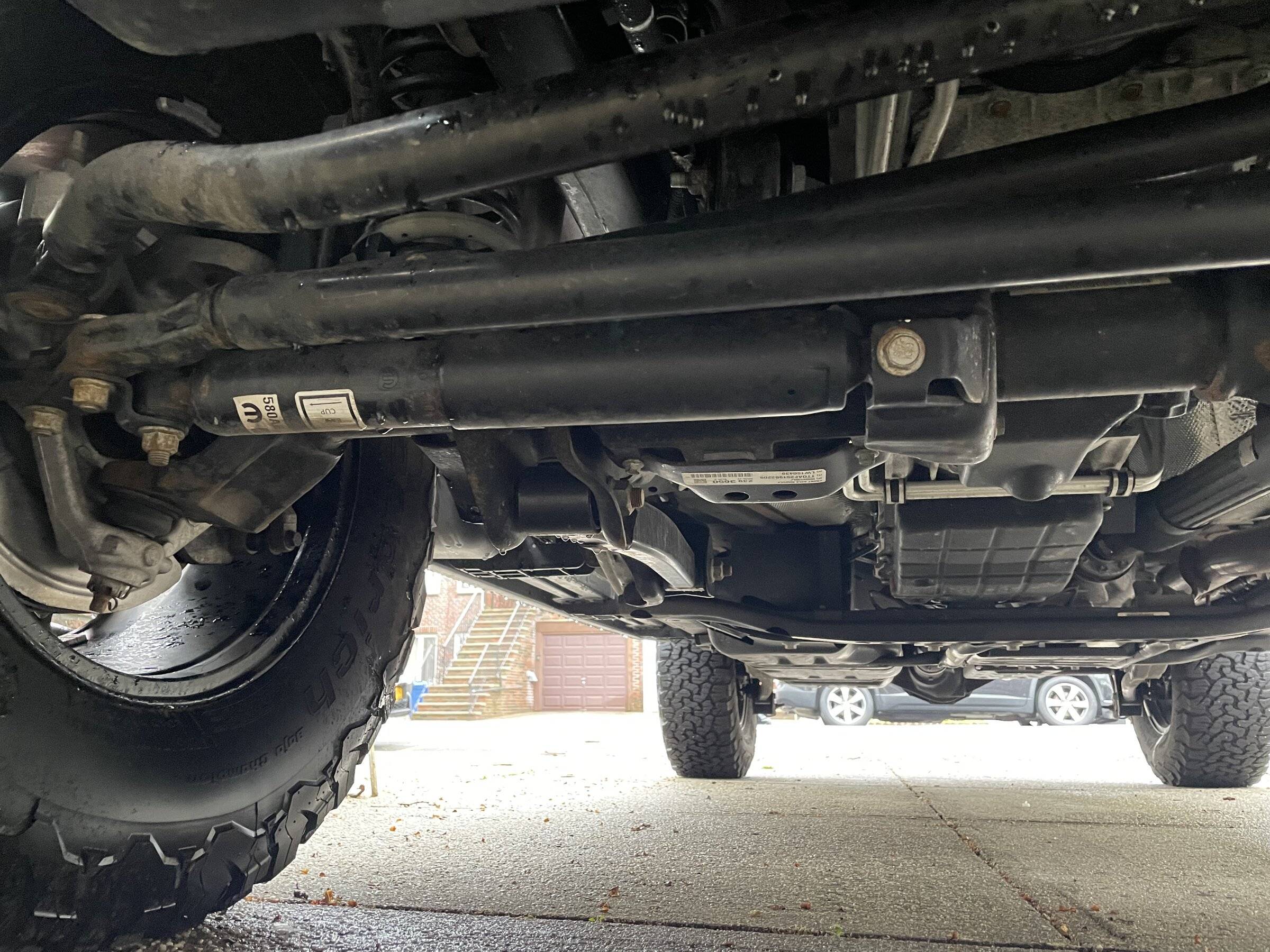

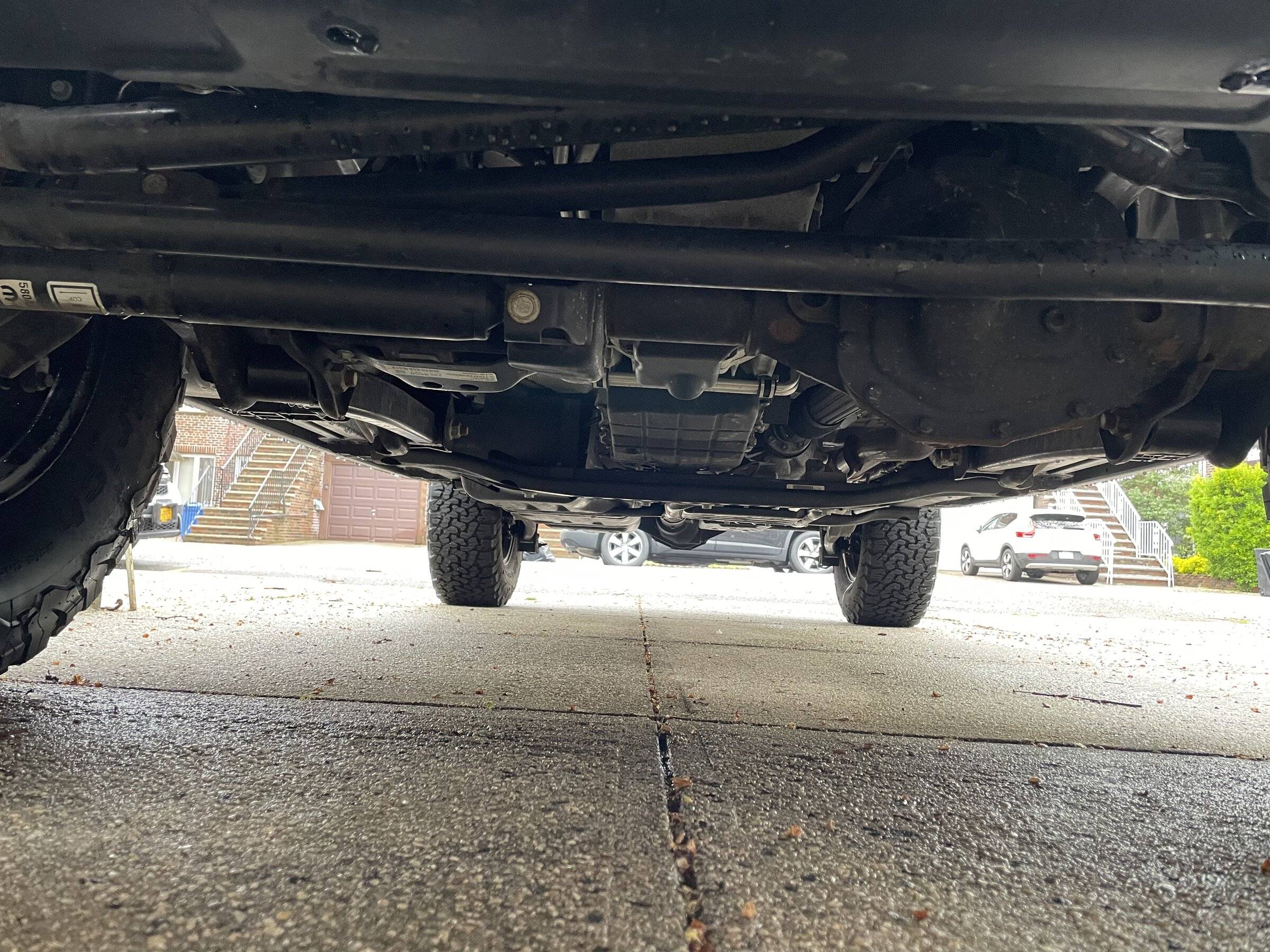

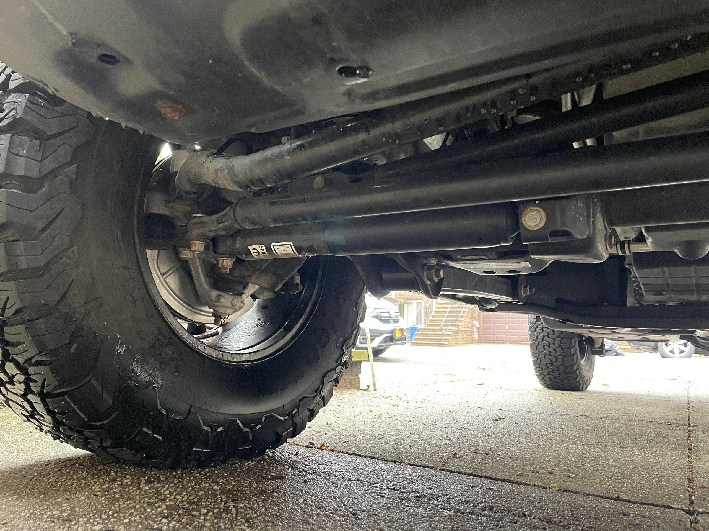

Flipping the drag link on a JL is almost never necessary. You really opened a can of worms by doing this. You will now have major interference with the frame for up travel on the passenger side. You got some bad advice. While raising the track bar mount will fix your drivability issues, I highly recommend putting the drag link back in the factory location. How much off-roading do you do? With only 3” of lift you’ll have very little up travel with a flipped drag link.

Yeah I’m just amazed that people jump to that mod without doing some research. “I heard it was good on lifts 3.5” and up” You done messed up A A-Ron. If it were me I’d try and sell those knuckles to some other misinformed modder. I wouldn’t flip the drag link on less than 5.5” of lift.

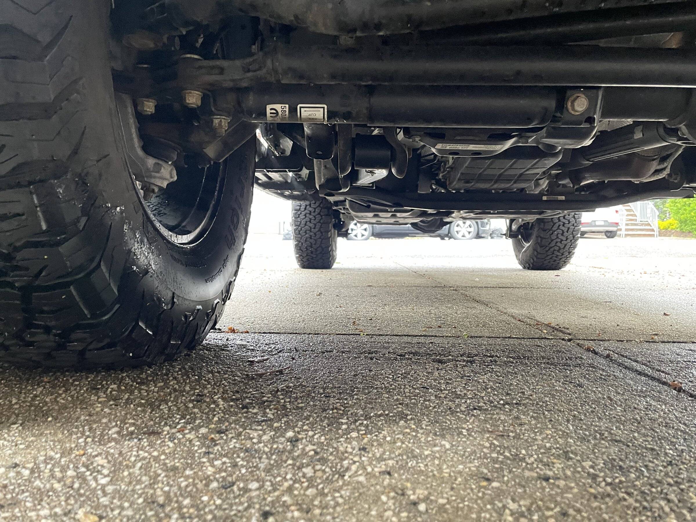

I’d second this. The drag link and trac bar should be parallel. You’ll get bump steer just like that when they’re not the same.
Can you try the lower drag link mount on the knuckle still?
how does one determine if it’s parallel?
