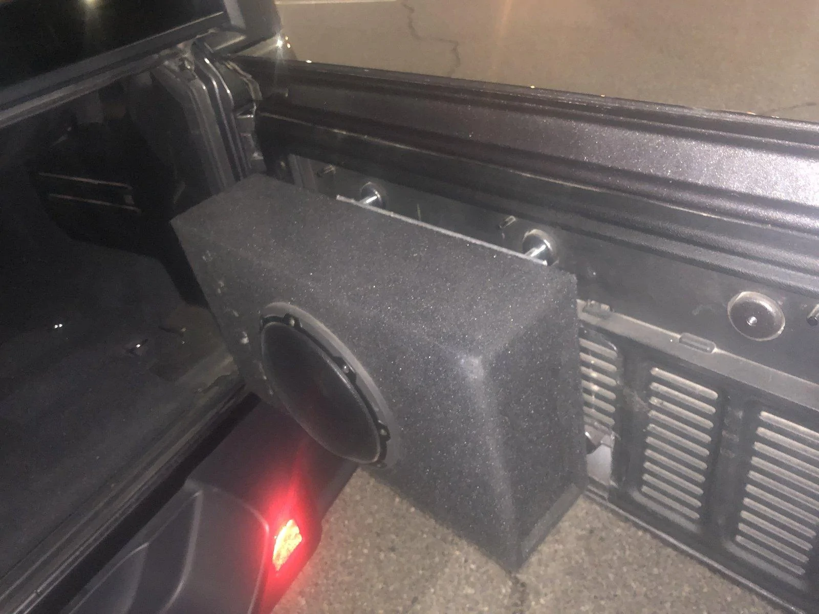

I mounted a 8 inch JL Audio sub to the tailgate with z channel to save some cargo space and can be slid off with tailgate open. ( harder with doors locked)
How does the 8" jl audio sub sound in the Jeep? Do you wish you went with 10 or 12"? Loaded box or separate amp?
