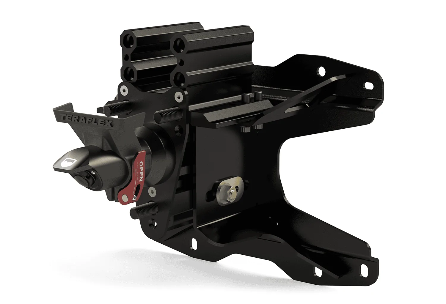

Teraflex Alpha HD...Just check first with Teraflex to see if they have the modification done for the 2021's due to the 2021's new rear camera.

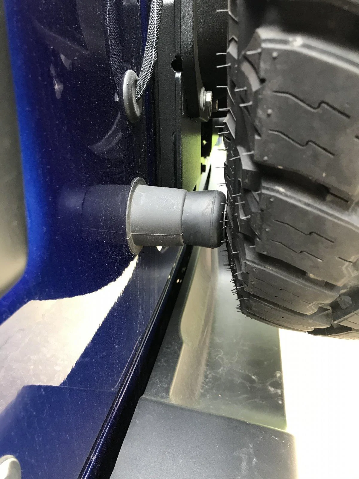

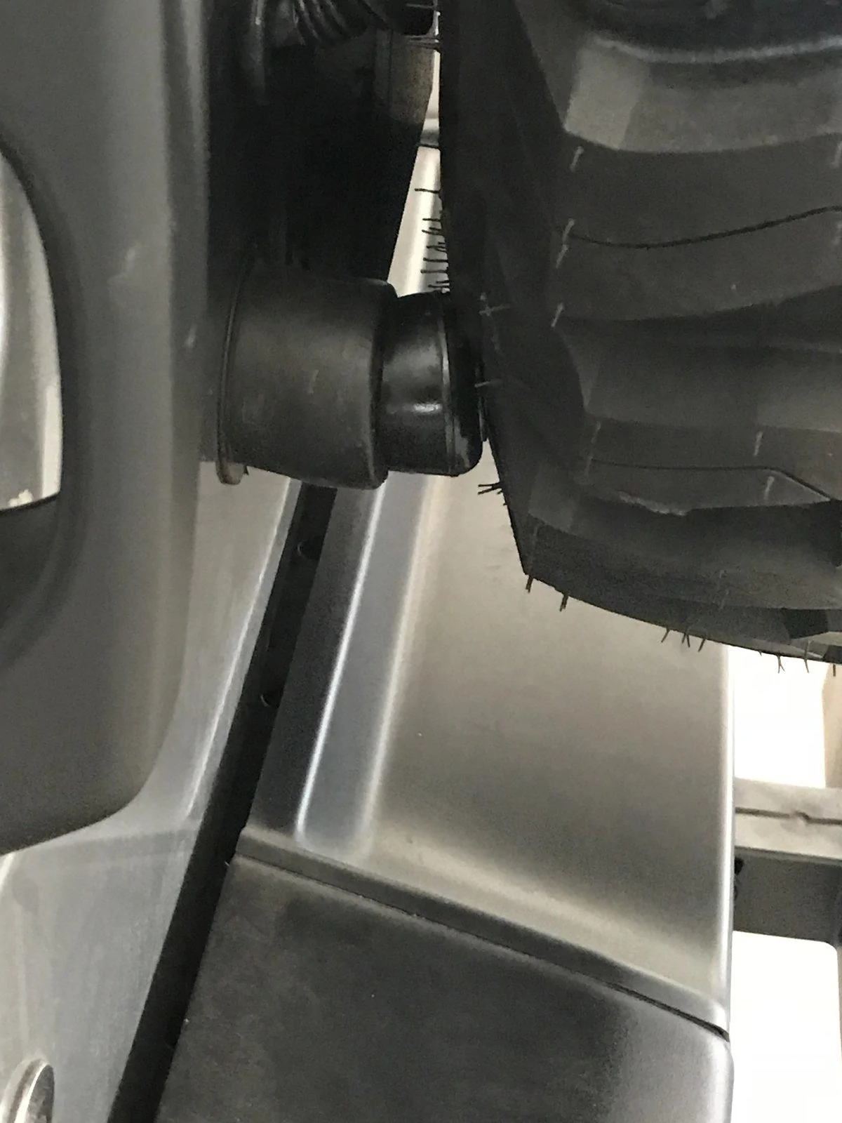

I added rubber leg stoppers that you would put on a chair. Like mentioned above. It works great for me. Under $10 fix.

Rubber chair stops & maybe pvc risers if you have a big enough gap. > > > rubber_stops

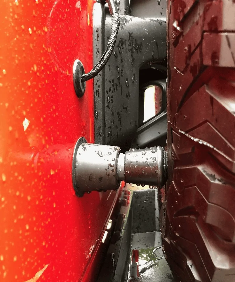

FWIW, the Smittybilt oversized spare adapter relocates the bump stops; they slide forward/backward about 1/2-inch, too.
This adapter is not the most advanced piece of engineering, but is pretty affordable. Got it for $172 from CJ Pony. That’s more than the Rough Country, but a lot less than the Teraflex.

I have a RC mount and used heavy duty hose to push against the spare, zero Issues

Just go buy the Teraflex HD Alpha tire care. It allows you to adjust height and depth of the new tire and also relocates the rear view camera so it's back in the right spot. I have one and it's perfect and I can still use the stock OEM tirestops.
https://teraflex.com/shop_items/jl-jlu-alpha-hd-adjustable-spare-tire-mounting-kit-complete-5x5?vehicle=JLU Wrangler Unlimited
I second this.
Had the RC version (and figured it’s just a tire carrier, so what?). It lifted my 35” wayyy too high and pushed it out so the bump sticks wouldn’t make contact.
After a week, I ripped it off and went with the Teraflex HD. Love it. Can see out the back now that it’s lower, moving the brake light makes this even better, and it makes firm contact with the bump stops.
