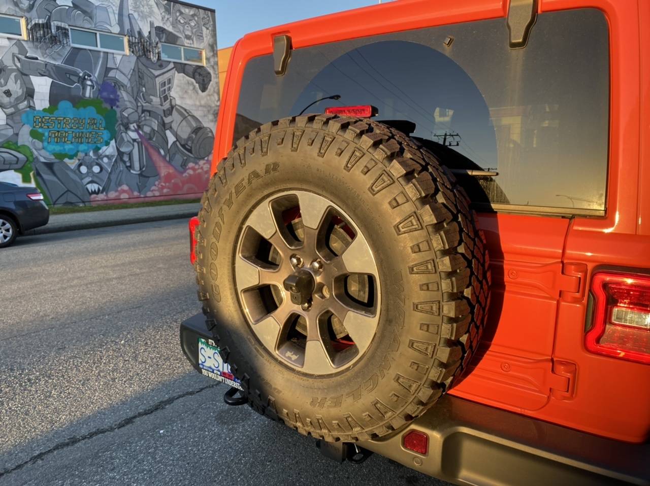

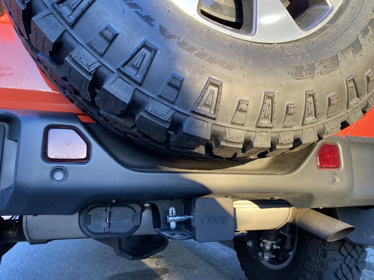

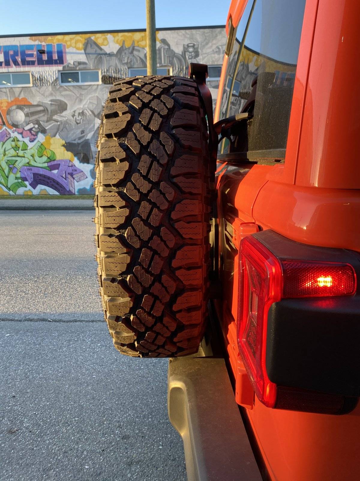

Yes, 35s on stock rubicon carrier will clear the stock bumper just fine, with room to spare.
The relocation plate is usually used if you go for 37s or aftermarket bumper with less clearance.
Also using relocation plate would push the tire further out which introduce more stress onto the tailgate, so I wouldn't use it unless necessary
Photo above is of my 35s on stock rubicon carrier clearing stock bumper. I see no reason to add unnecessary weight onto the tailgate.
