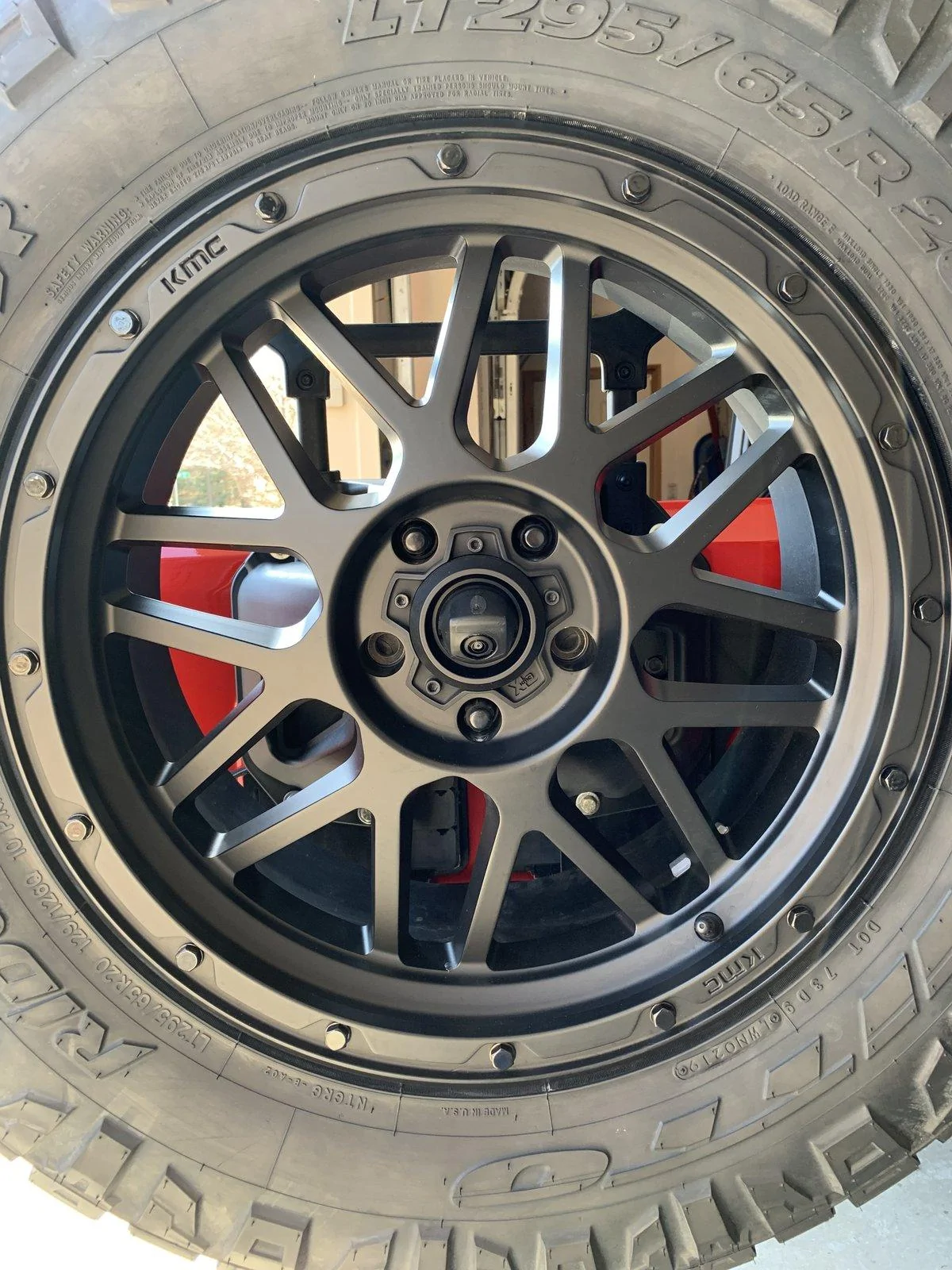

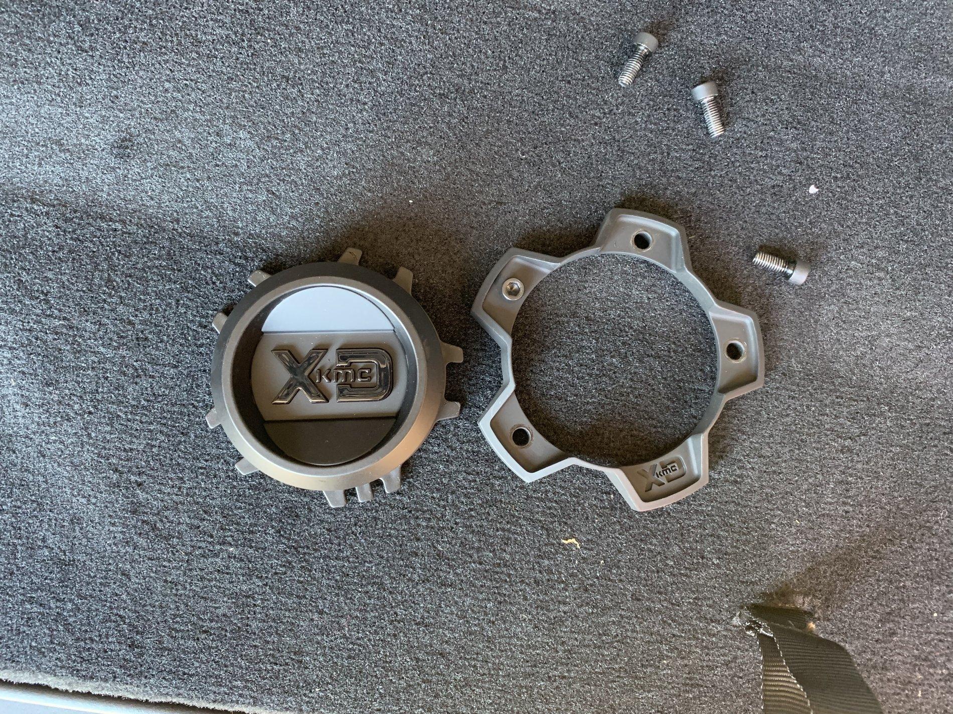

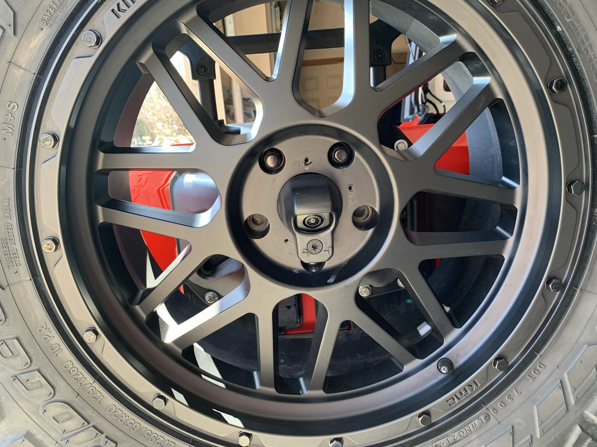

Just wanted to post some pics showing how I was able to mod the XD135 wheel to accept the rear camera.
The retaining ring needs to be removed to take out the XD plug logo in the center of the cap. After that, use a half round file and/or sandpaper to smooth out the cap (where the logo plug sat). This will allow some tolerance for the camera to slip in nicely.
