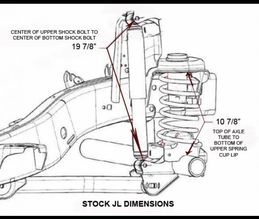

Nope, same suspension height all models. Only the XR has 1.5” lift and the 392 has 1” 392 XR has 1.5” lift.
This is the average suspension height of all models.

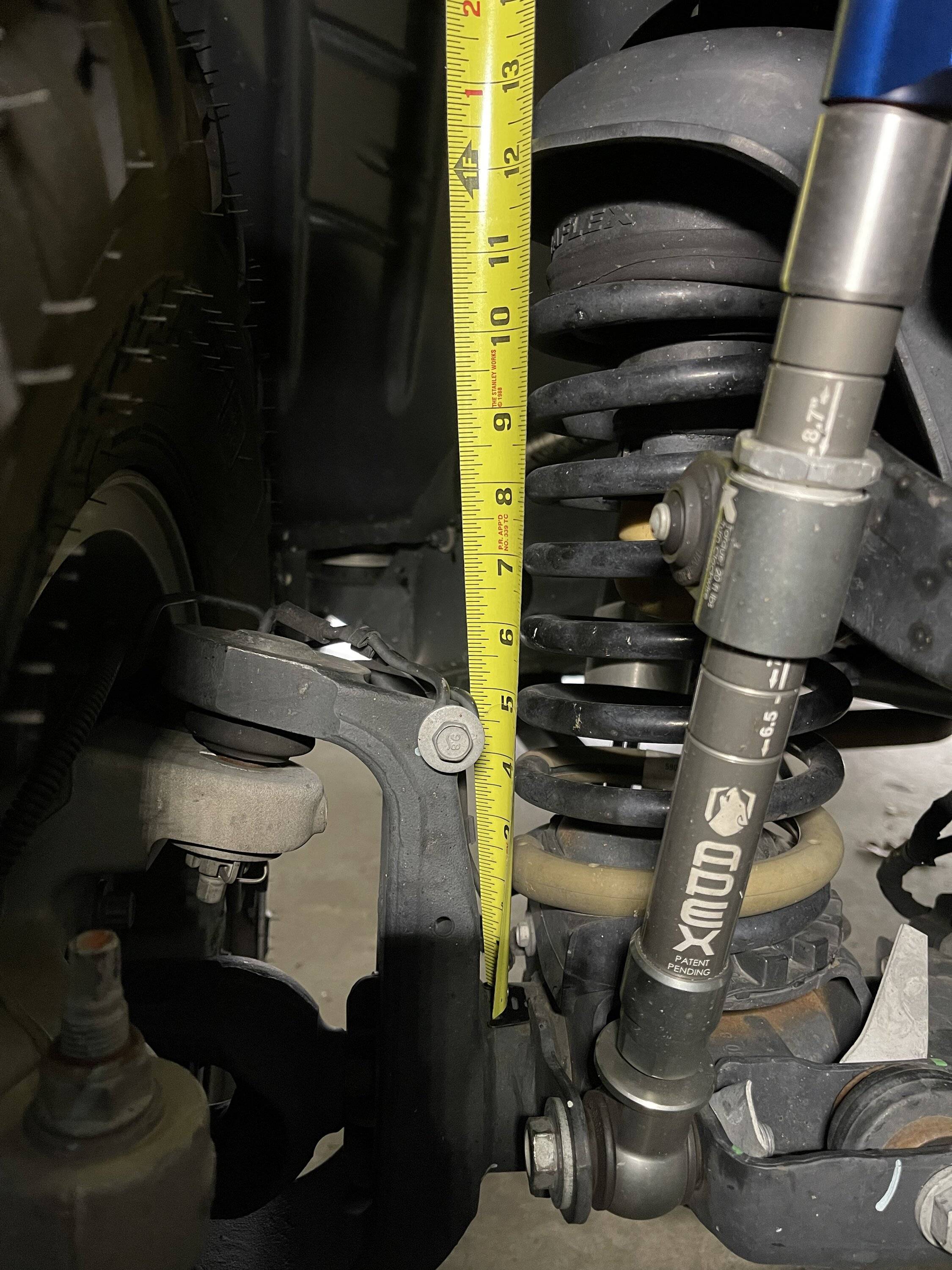

Finally got in there to measure. Minus the 2” spacer, my Rubi Flared Sahara comes in a tad over 10”. This plays more towards the “Sahara is 3/4” lower than a Rubicon and 3/4” higher than a Sport” narrative. I have an OE steel bumper without end caps, but I doubt the weight difference would account for an unnoticeable 3/4”+ sag. I have a couple buddies with bone stock Sports, so I need to throw a tape measure in the console so I can measure next time we’re out.

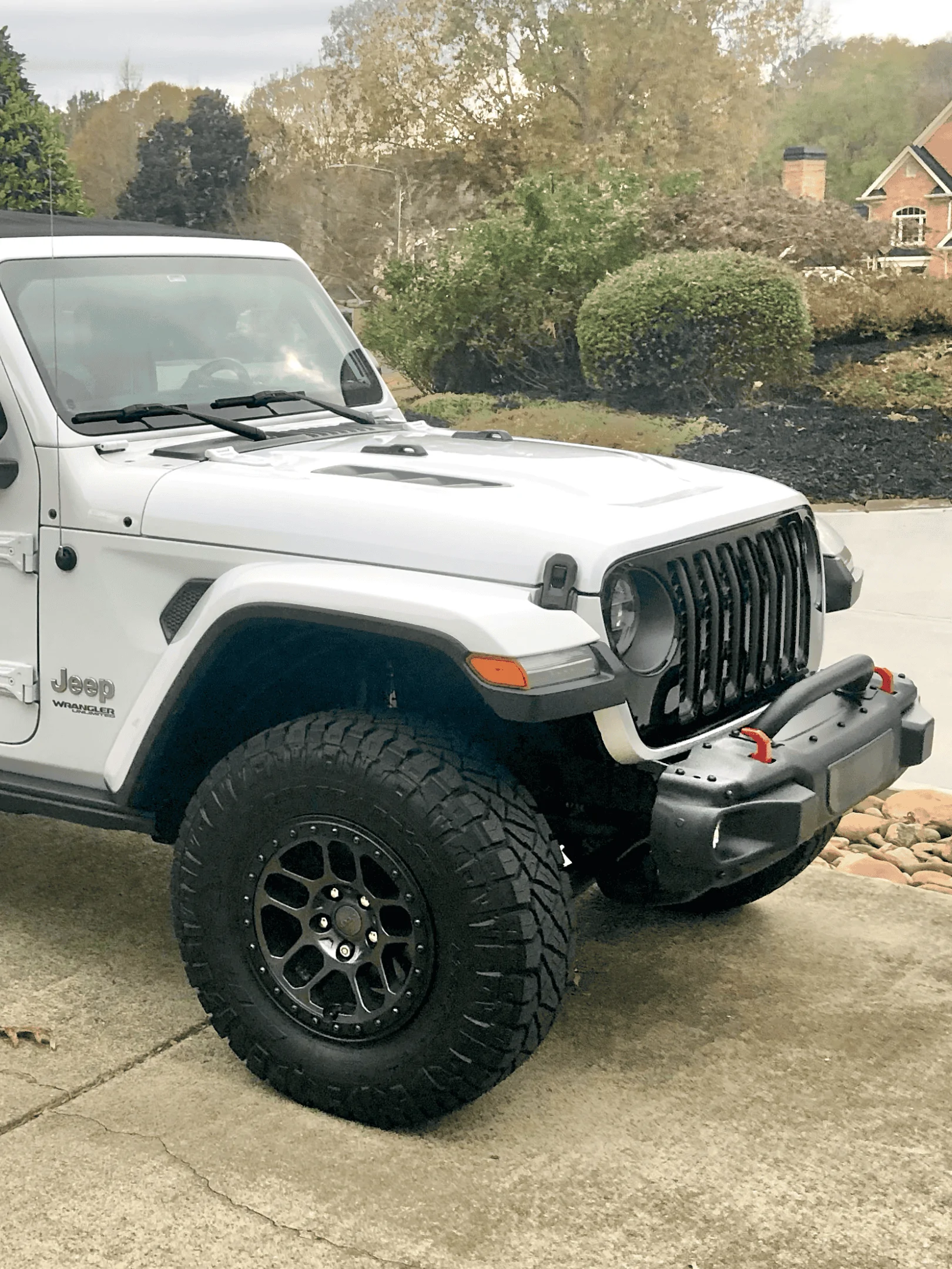

How old is your Sahara? You will definitely have spring sag.
I lost almost an inch putting a Venator bumper on my XR without the winch. It likely weighs the same as the factory steel.
