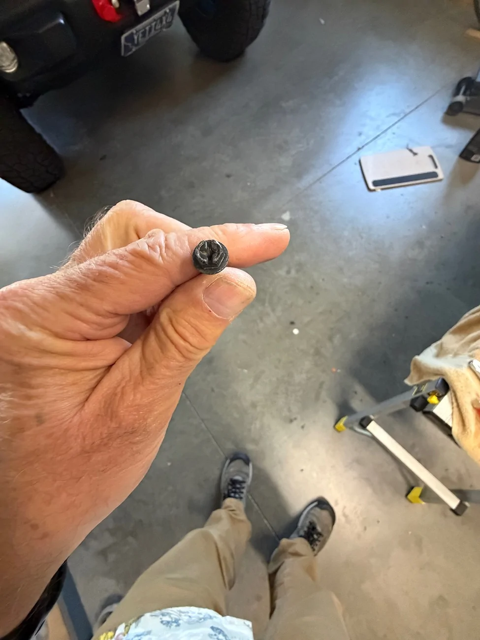

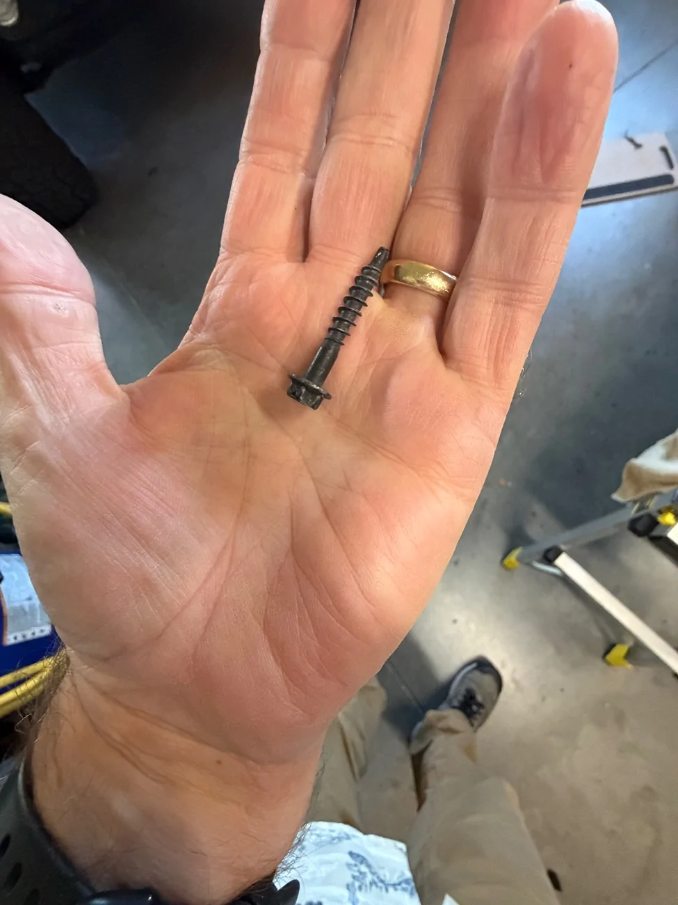

I shit you not a couple of days ago I was walking my dog on the bike path by my house and I could see a screw on the road so we drive that all the time so I stopped to get it off the road. When I saw it I thought it was a drywall screw but nope LOL a freaking air box screw.......what are the chances of that...

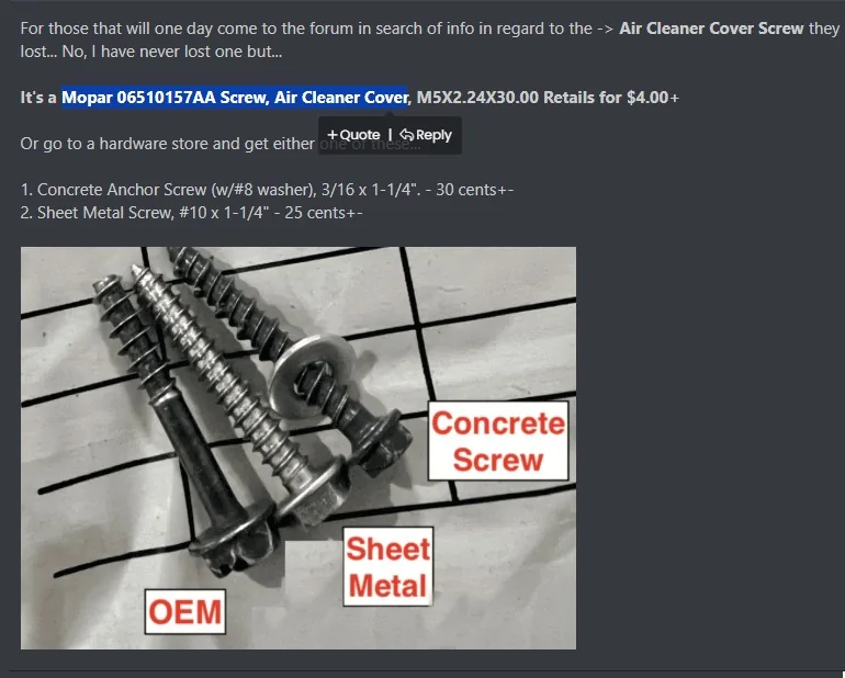

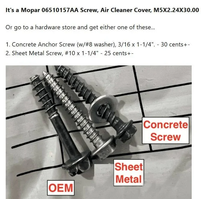

I don't remember who originally posted this, but I saved it just in case.

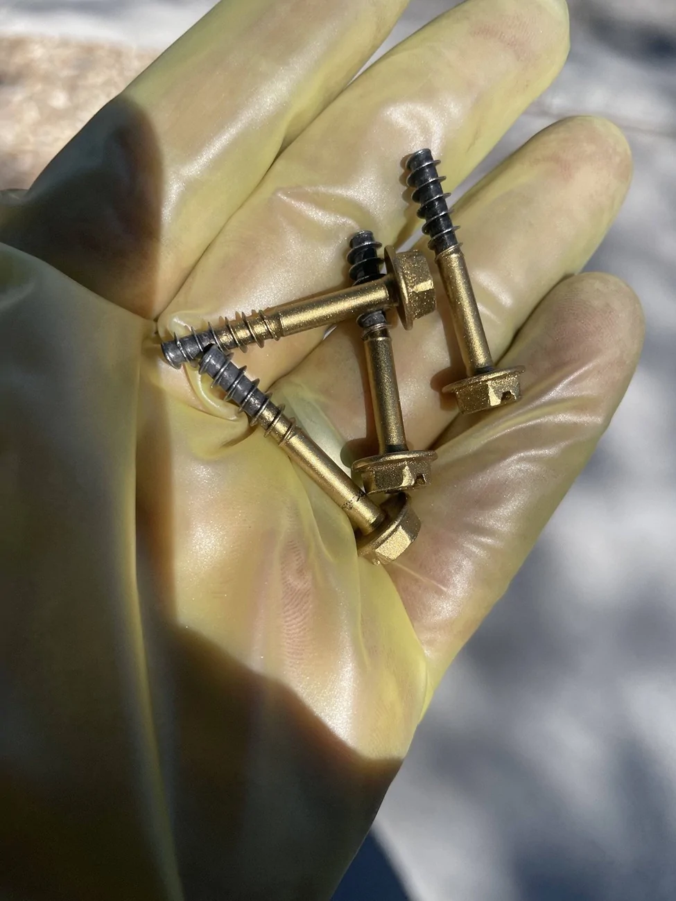

Ahhhh those little bastoods. I made a post years ago about loosing those little suckers.
I spray painted the top half of those screws gold. Once I see black I stop removing the screws because I would always drop the black screw in the black abyss of the engine compartment and never to be seen again. The gold limit keeps the screw in the air box cover while far enough out to allow separation of the box halves. It is a small hack that has helped me.

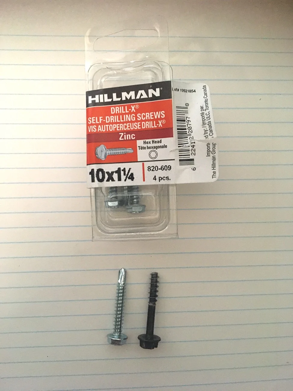

This is what i bought, when mine disappeared into the netherworld.
